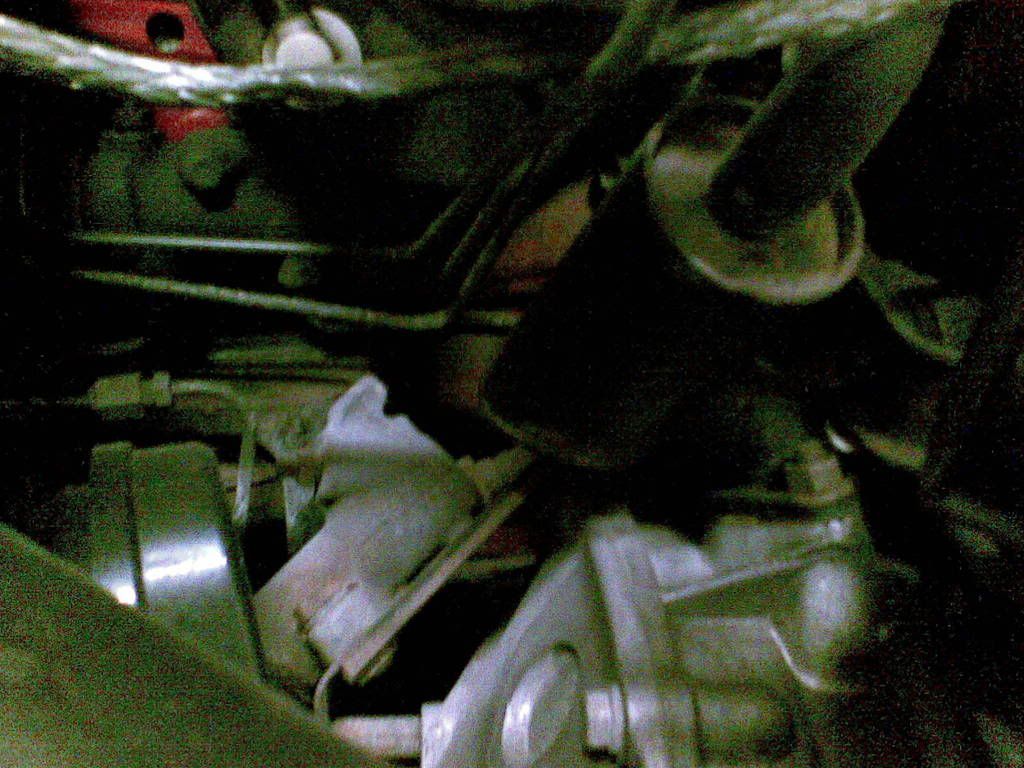

I was planning to run the usual 1275 engine breathers (charcoal canisters) one one the timing cover, and the one on the transfere casing. The problem Im having is the one on the transmission casing is right in the way of evrything, I was hoping to use one of these
to give me the little space I need but, I have very little luck finding one so far. Can anyone see a problem with me making a mating flange (as per original breather) with a 1/2" stub poking out, and connect this to one of those little K&N style items? Will this be ok?

I'd say not as there's a coarse wire wool type stuff inside to trap the oil and let the vapour out.
There's nothing stopping you modifying an older type one that stand upright or engine the one off the tappet chest of a small bore engine.
