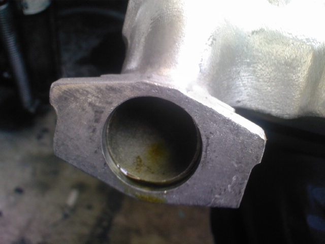

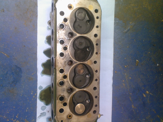

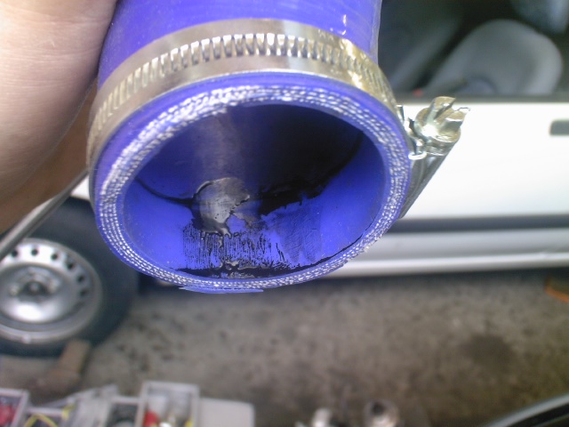

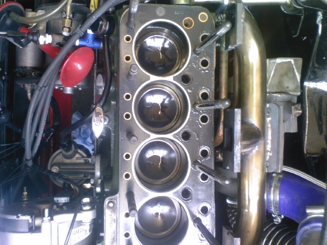

Took the head off today in prep for the arrival of the new one, as was supprised what I found. there was trace of oil in the boost hoses at all except a tiny smudge in the 90 bend to the compressoer housing. ther was a tiny spot in the inlet manifold where the locating rings usually sit. when the head came off bore 4,3,2 had oil sitting in the dish of the piston, and the valves was coaked from where I believe it has been burnt, no1 was clean and dry. Pics should show the oil, not great as only had my phone with me. Are these usually the systoms of shot valve guides/ seals?

shane if you look at the gt17.. thread ,youll see i had exactly the same thing , it was the guide seals blowing off the ex valves ,and letting neat oil run into the hamber , a new set of guides and positive sprung seals fixed it completely.

If thats the case then Robert then im just glad its not the turbo! The head from steve will hopefully be here mid week so its not an issue, as this one is going off to him as an exchange.

RESULT, fitted the new head which arrived from Steve earlier this week, and the problem is solved!
