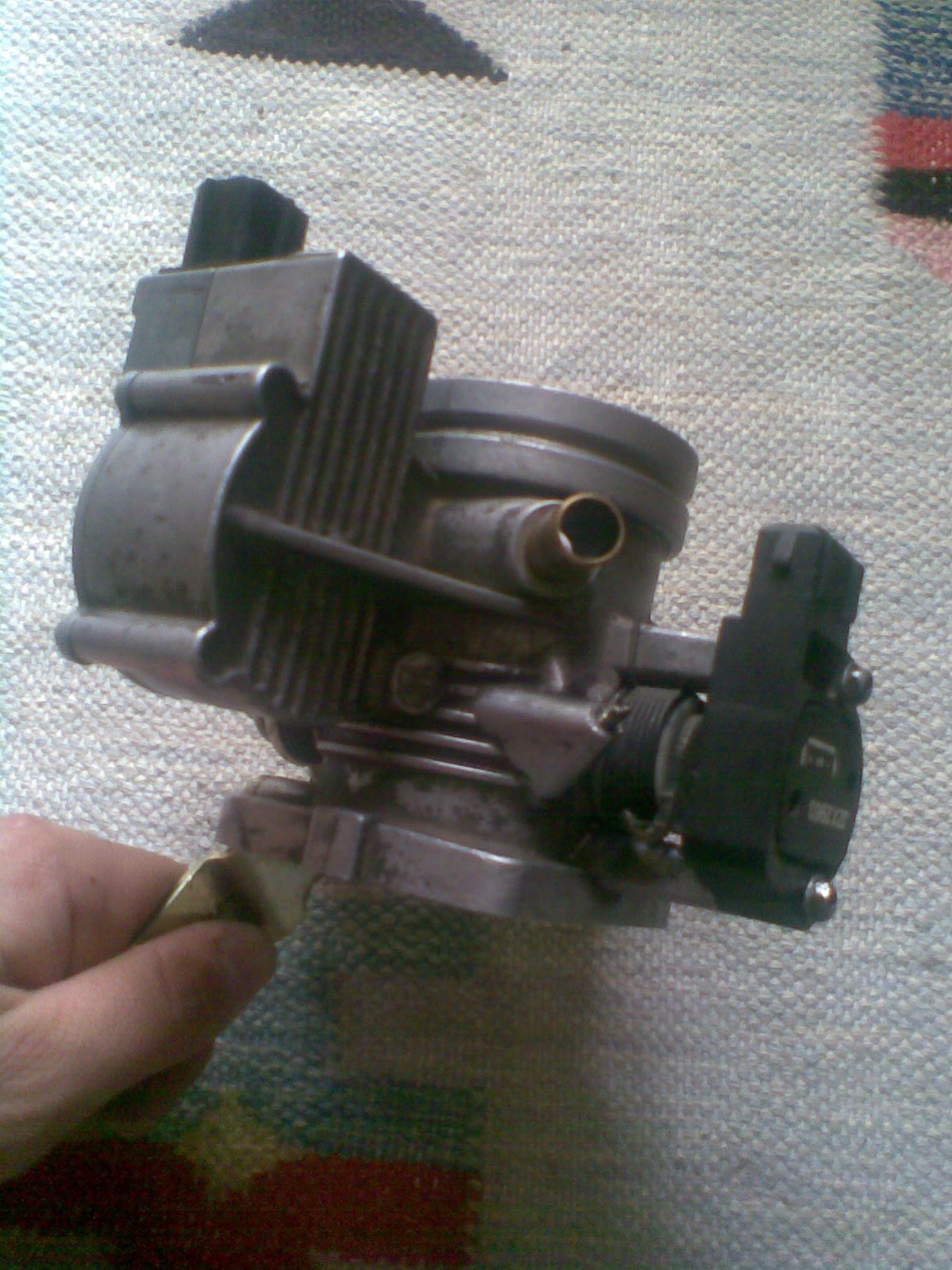

xm thanks, but I made myself an inlet with rover's 214 Gsi throtle body with the same stepper motor and tps and I want to use 1 or 2 injectors:).Maybe i want an other or an external ecu to manage the second injector!
