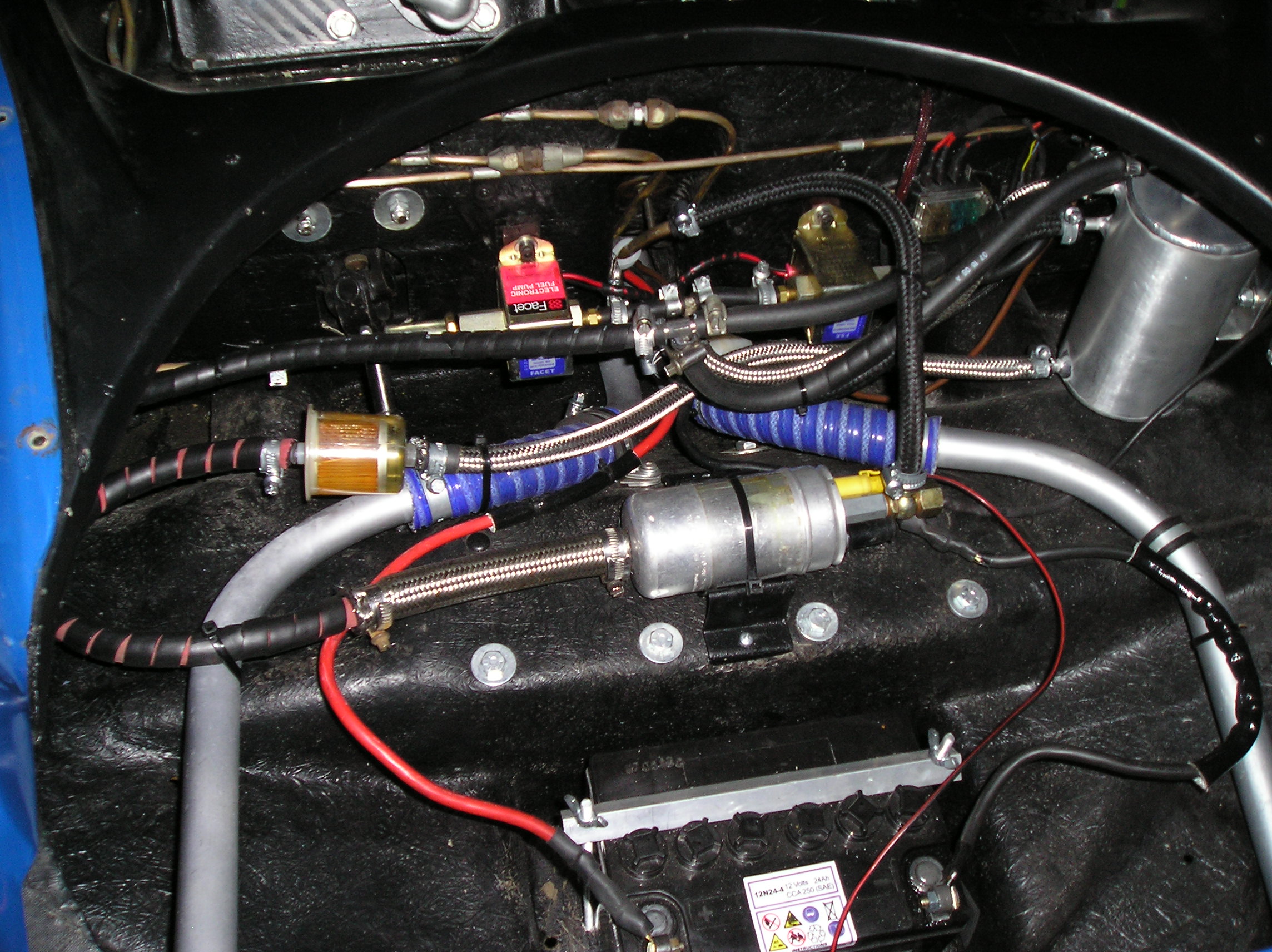

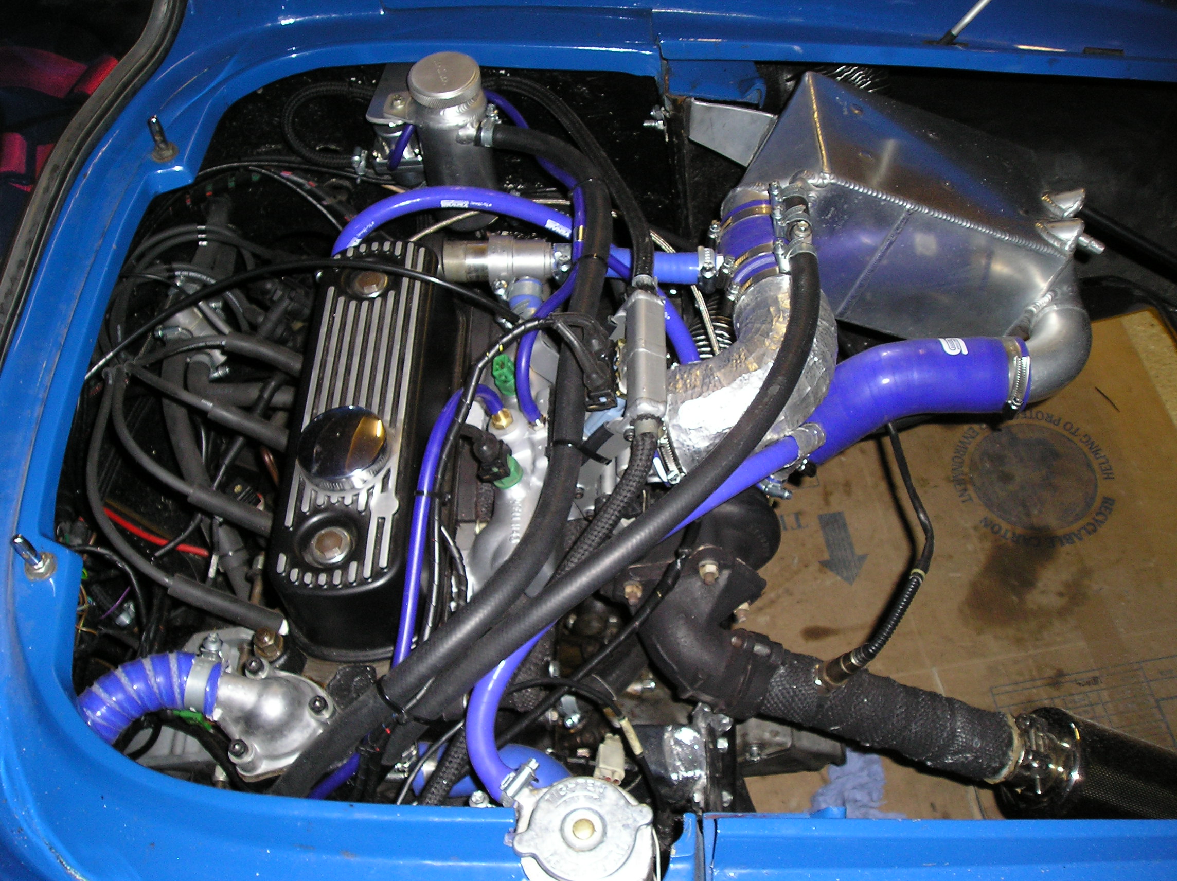

Work continues with fuel system, charge cooler plumbing etc.
Wiring next...

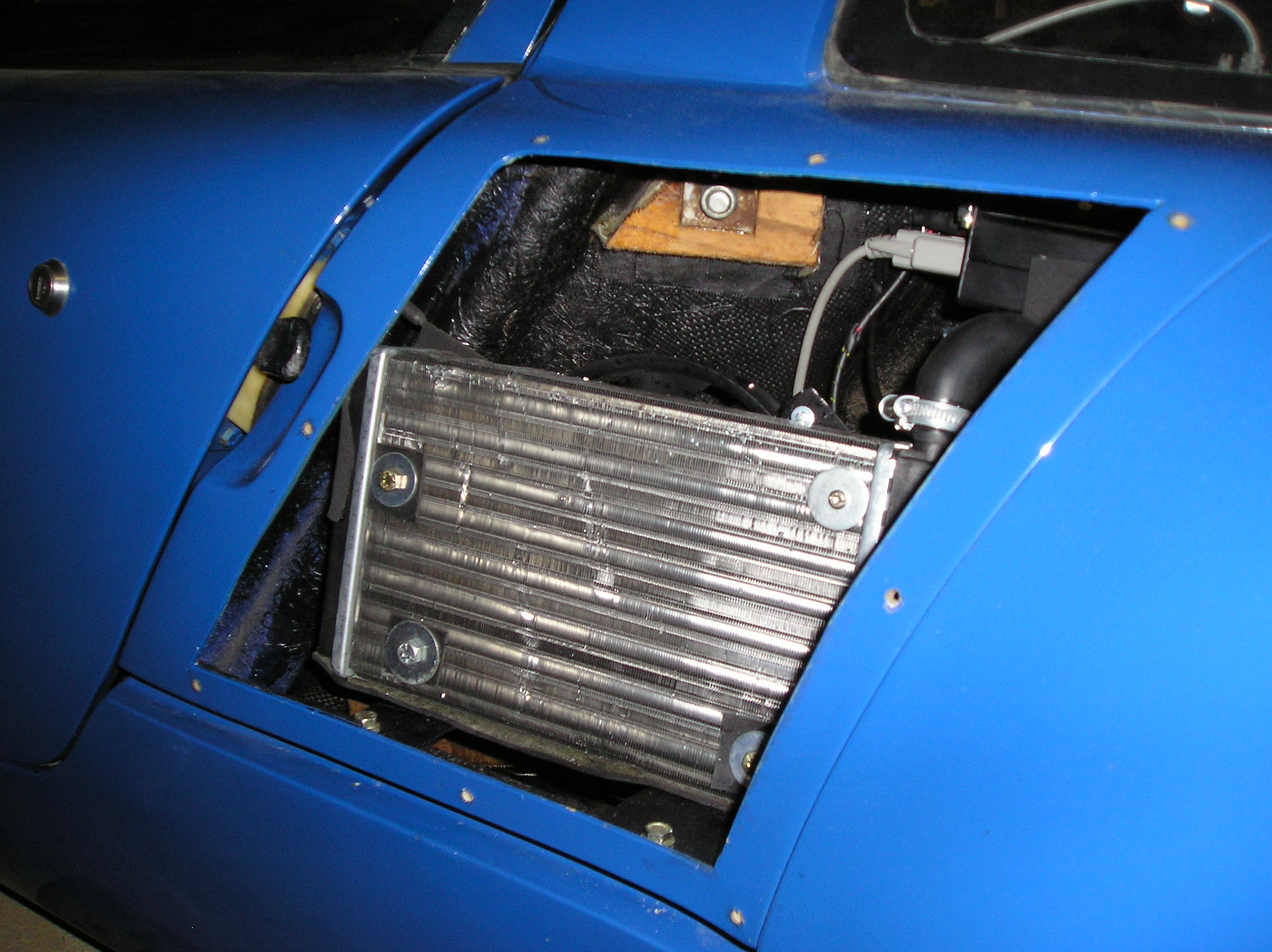

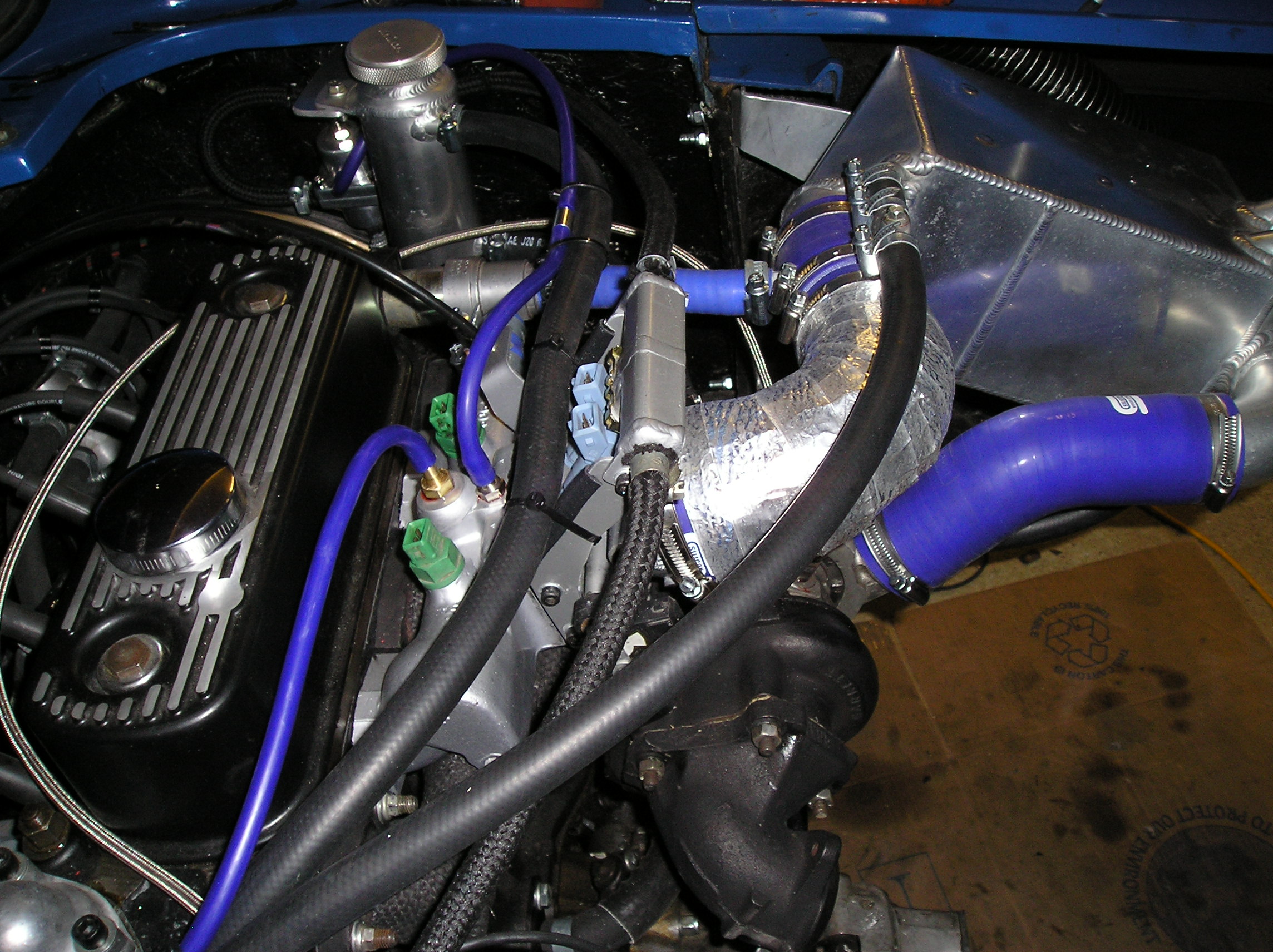

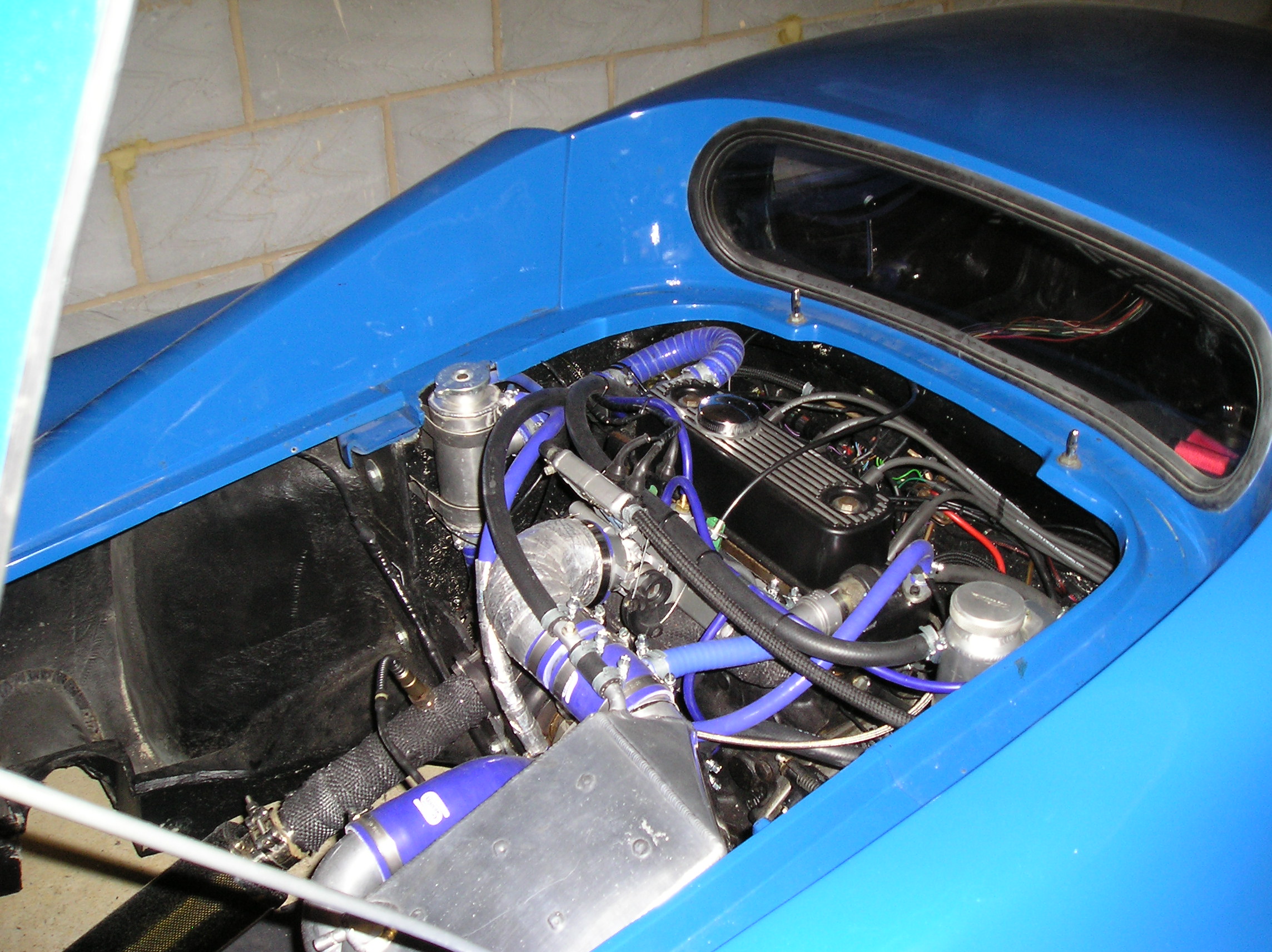

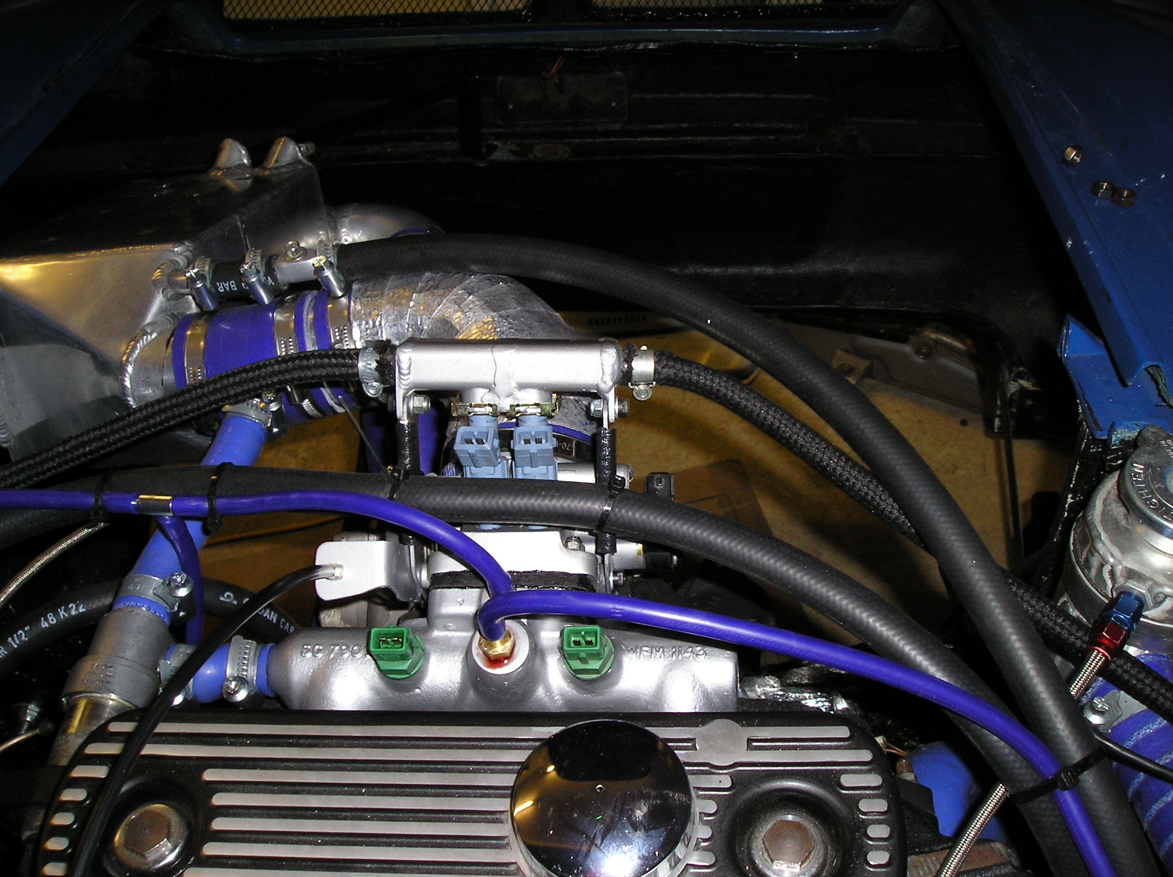

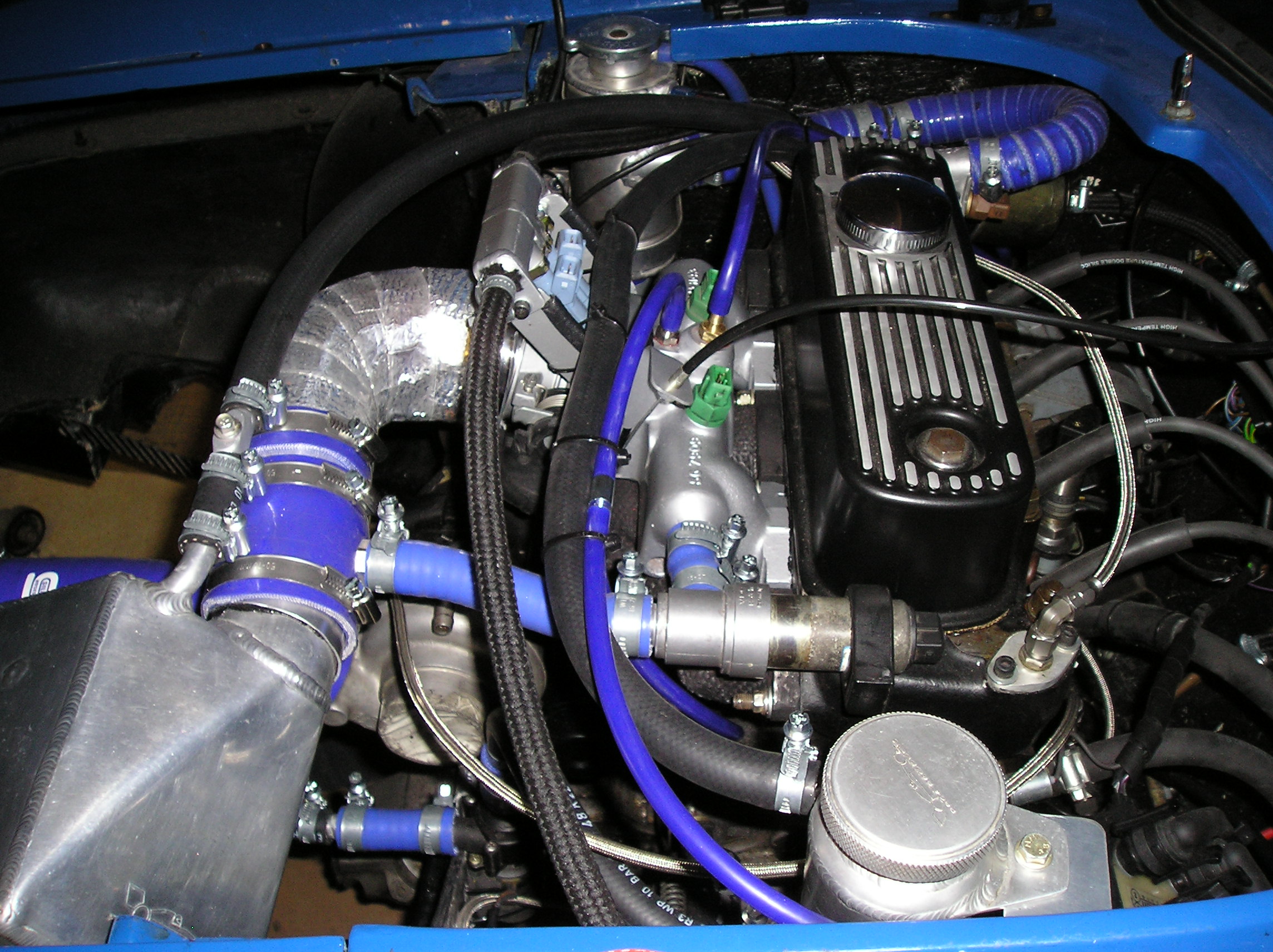

All plumbing to the charge cooler is now done and the wiring finished off.
Started it up for the first time last week and with a few map changes it works really well.
Transient fuelling needs a little more work probably because of the manifold drying out on closed throttle high speed.
At the moment it has a 544 cam and I am supprised how little lag there is and how low the speed is when the boost comes in.
I was going to change the cam but not so sure now.
More mapping to do but not a bad start.
