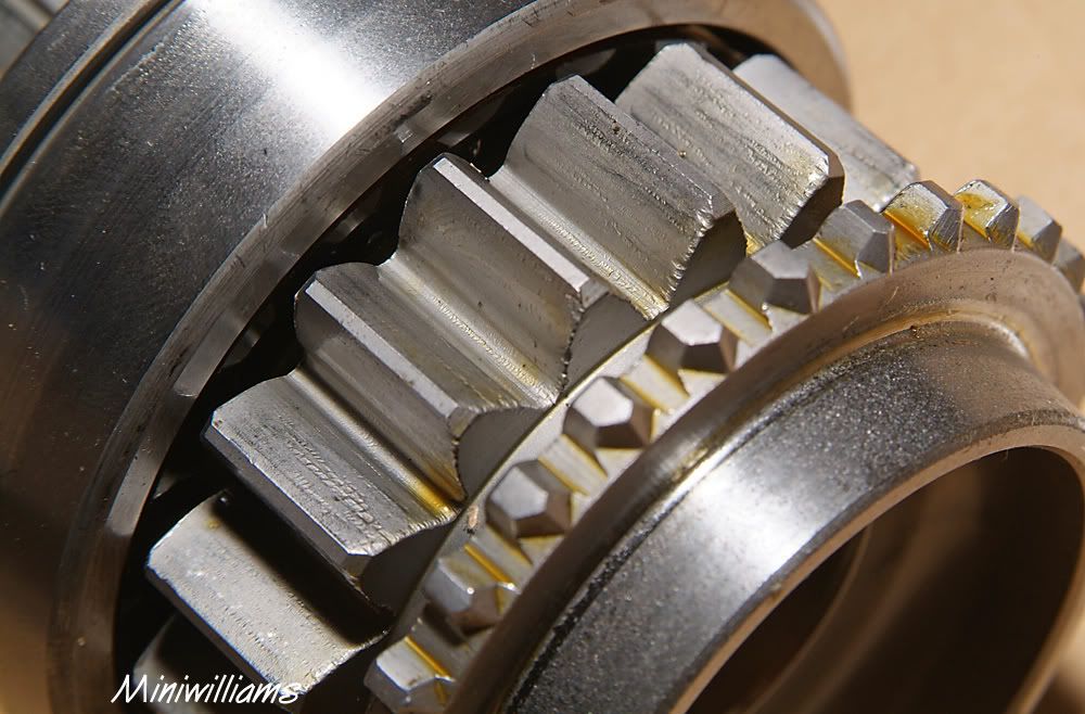

The fact that those indents on the side could lead to a fracture in turn leading to a couple less teeth?

yep that's my thoughts to a T mate.

i think its shagged and it looks new as well so could it be poor quality? no longer a series, but still 1.3 turbo.

As others say, possibly due to poor surface hardness of the matl?

If thats a newish MiniSpares part, get on the phone to them as they are having issues with their quality at the moment regarding gears

Well here's the thing. And it's NOT as mini spares part, just to clear that up.

Looks as if its done 30,000 miles without an oil change

It was sent to you like that as brand new??
![]() 5329 Posts Member #: 140 Proven 200+bhp & Avon Park 05,06,07 Class D 3rd place |
26th May, 2008 at 12:04:32am
YES mate that's how i got it, and T3 tone can back me up as he saw it.

cant sell you shit like that uder the sale of goods act regardless of you fitting it or not Crystal Sound Audio said:

So where do i go from here, they said it's ok , do i wait for it to break? I don't mind if a part break it's it's as it should be, BUT I'm not happy if it break cos its shit to start with. Best 1/4 mile 13.2 seconds @116 mph
26th May, 2008 at 12:30:32am
There is no way i would be fitting a part that looked like that, new or not. I have stripped a 78k mile standard box and the gears looked better than that!!

So where do i go from here, they said it's ok , do i wait for it to break? I don't mind if a part break it's it's as it should be, BUT I'm not happy if it break cos its shit to start with. Id take Tom Fs advice, and give them it back and go else where Its not as if your a punter looking for a box for a 998 On 26th Oct, 2004 TurboDave16v said:

that looks shocking to me "Turbo's make torque, and torque makes fun"

How can you "de-burr" something and it still looks like that, unless they used a fcking chisel.

looks like the gear cutting tool was fucked mate when they made that one, it may but will it last well it certainly wont last as long a a decent one.

I wouldn't risk using that TBH. If they don't sort you out with AT LEAST a replacement gear then name and shame.

Looks like gear from a 80,00 mile mini with a forgetful owner. (forgets to replace oil or use the clutch pedal)

Hi, Are these gears made in the usual way? ie: Compressed powered metal? If so it looks like the die is worn out... Cheers, Gavin :) sintered gears will still need finishing though surely?? "Turbo's make torque, and torque makes fun"

Well guy thanks for your imputs, sadly you have confirmed what inside i was trying to NOT listen to, but i get so down when the cars out of action i just needed it fixed. Looks like i'll be calling then Tuesday, I just can't see how i can move forward with it, were they have already said it's fine when i clearly isn't! Like you say Matty any of the others gears i've ever owned have NEVER been like that from new. Best 1/4 mile 13.2 seconds @116 mph
