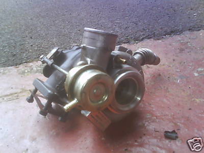

Hi there i've found a turbo which i need you guys to check to tell me if it with be ideal for my turbo conversion. Its a t25 from a saab 93. it has the 4 bolt fixing. Does this mean i can use a t3-t2 adaptor plate.
I appreciate the help.
Thanks
That looks more like a GT17 to me, well it is.
Yes you can use a T2.3 adapter plate, and yes it's a great choice of turbo.

Looks like a GT1752 to me as well :)

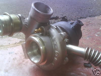

Hi here's another photo. As you see it seems to have jap text on it.
That is a GT1752, what is the number on the plate?
p.s. found it on ebay, it's listed wrong.

Looks exactly like my Saab GT17...
