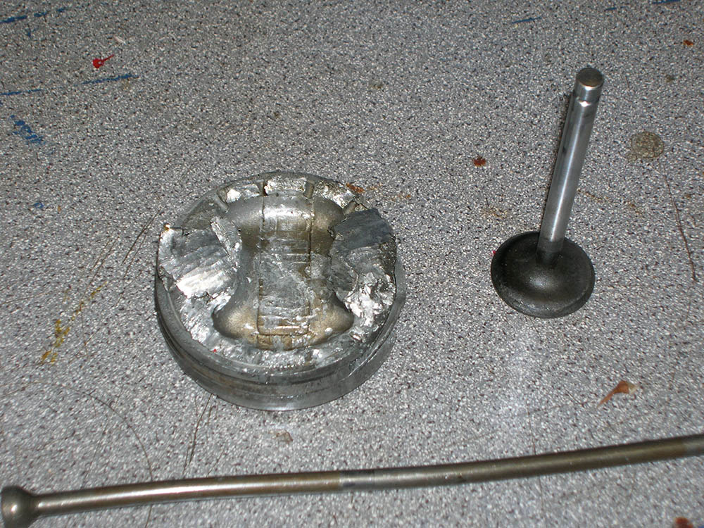

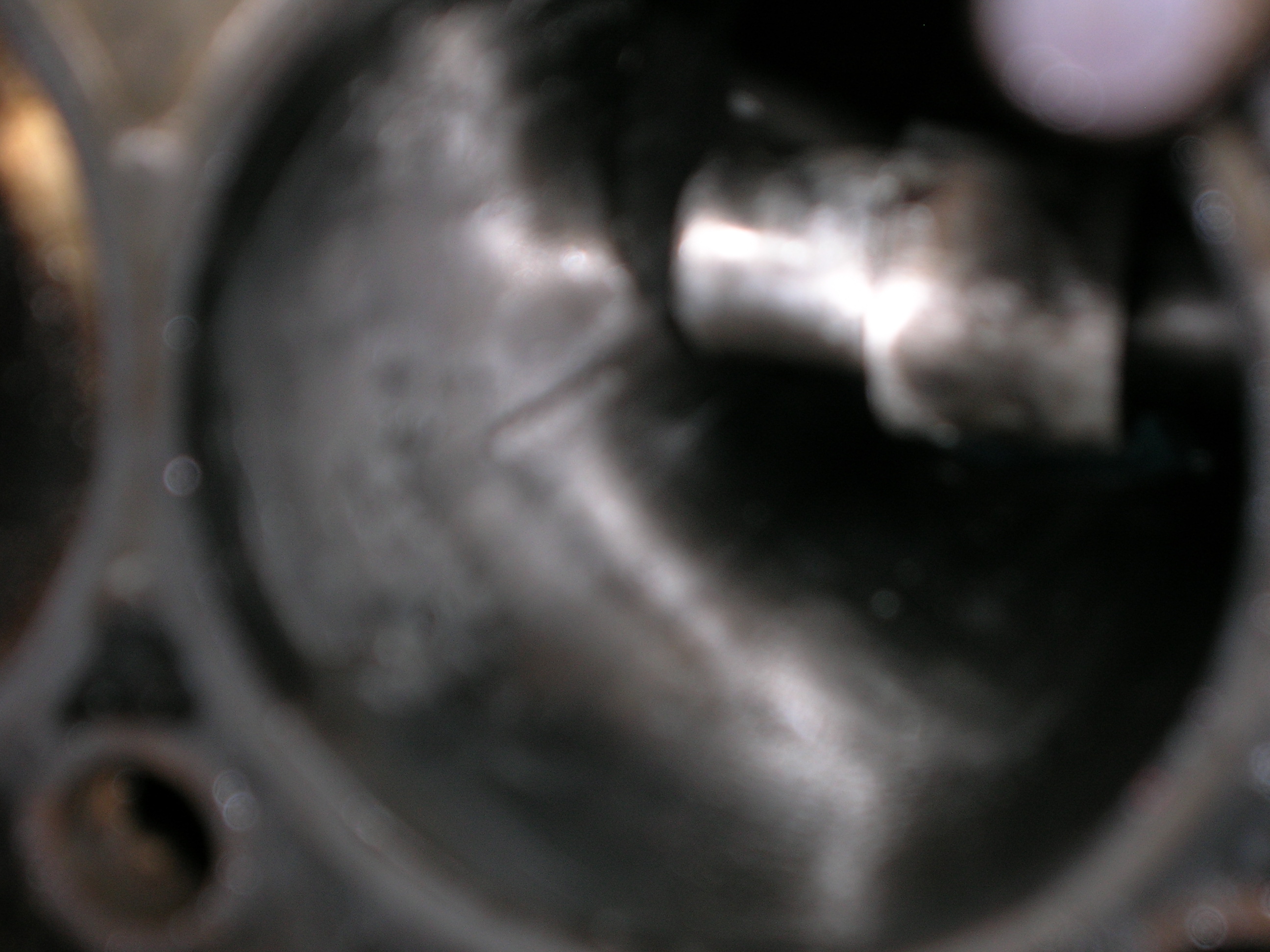

Finally got the engine apart.No 2 piston in bits,broken across the oil ring groove.The top is still mostly ok,so I guess it siezed in the top land area,there is a big smear of aluminium at the top of the bore.Consequential damage is big scores in the bore from a naked gudgeon pin,a bent valve and bent pushrod.
The pistons were metro turbo,so cast not forged.Any thoughts on whether this is over heating,or could it be a mechanical piston failure?

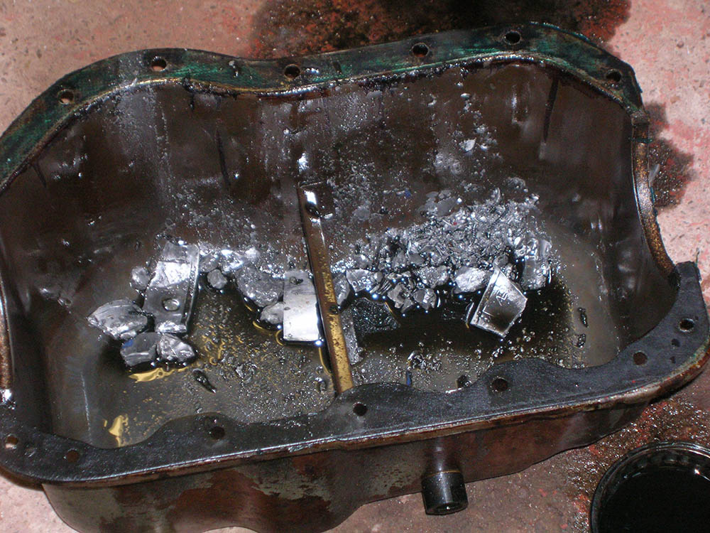

steve1275
863 Posts
Member #: 951
Bromsgrove
Some pics of the remains

Oh dear.
This should put anyone off the idea of driving their car in anger before getting it set up properly. If that was a mini engine, the box would be a goner!
Will you be building it up to the same spec, or using this as an excuse to build a powerhouse?

What do the other pistons look like? Might be worth measuring the ring grooves, could be that the edges of the crown have bent down and trapped the rings, hence the blowby.
Once the blowby started, I guess the hot gas getting past heated the crown and lands up and expanded them enough to grab hold of the bore :o(
Do you have boost cut on your ECU? Possibility of spiking much higher than 17psi if not, especially using a bleed valve.

Hi Olly,
Finally got the other pistons out:All look fine,no sign of detonation erosion on the crowns,no scuffing on the lands/skirts,no sign of excessive blowby.....BUT the second land of no.4 has 2 vertical cracks in it,either side of a boss.No sign of ring stick,but a second failure on the way.Is this caused by det in this area,or was the Pmax just too much for the cast pistons?
'Where does the engine go?'
Bat
4559 Posts
Member #: 786
Bermingum
There seemed to be a consensus with the Mega pistons that land failures were caused by det. The crowns on these also looked fine to.
I think it's due to the shock wave caused by det, before you get to the higher temps that start melting crowns.
