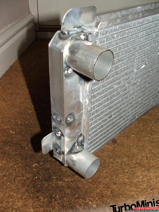

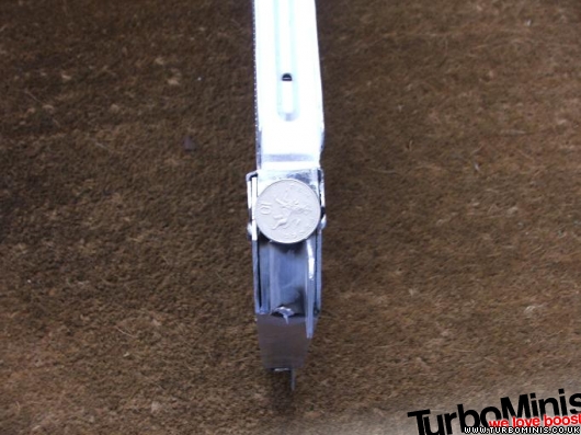

This rad is the same hight, same number of rows and same width as an MPi rad, but is almost another 50% longer. Cosidering people are using the standard MPi rad at around 140 bananas, im sure this will be more than adequate for 200, after all, how often does the engine run at full power.

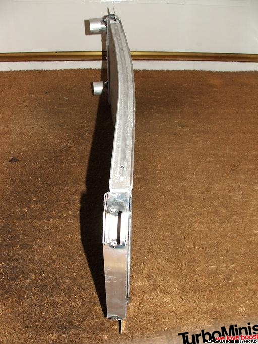

End tanks modified and a gentel curve massaged into it so that it fits snug against the front panel with no gap*happy* It is no wider than 27mm at the tanks. Its now a double pass wich should also increase the capacity, only thing that might cause an issue is the pressure drop across it *oh well*
Its off to be tigged up *happy*

Why double-pass on that lenght?

Iys surprising how much extra space you get from curving the rad. Gav did this on his speedster a few years ago and it overcome allsorts of problems. Nice job

Dave, it is not an MPi rad, i was mearly relating to the MPi rad for size, as it is the same dimentions all except the length.
The core is from a Vauxhal Nova 1.4. Double pass as both inlet and outlet at the same end, again saving space on plumbing, with the added benefit of increasing capacity, maybe at the expense of increasing pressure drop. I dont thinnk that will casue me any issues though with a full flow bypass therrmostat and leccy pump. I read that the OEMs theory on cooling system is that there should be at least 25% extra capacity in the rad at the most arduous conditions, rather than it just being enough at the best of times. This is for the out of ordinary conditions as well as fouling of the rad internaly and externaly.
You only have to look at the metro rad for the same engine and you can see the size that is roughly required. Yes you can get away with the smaller rad, but you are consuming the reserve capacity with nothing to spare. One other reason im using a larger rad is i intennd running lean burn at part throttle, which anotther reason for the oil jets i fitted on an NA engine. Method behind the madness :) *wink* My engine is different in many ways from every one elses, i have concentrated in areas other than outright power *wink*
Paul, thanks mate, but my fabrication skills dont come anywhere near yours im afraid *frown* I only bought the ally mig wire yesterday just to tack this together and its real ugly stuff. I think it will look better whan i get it back :)

Uggly arse MIG thats what it is. I only used it to tack it together, as i am unlucky enough not to own or be able to borrow a TIG :( I never inttended to weld it all with MIG, nasty nasty, lol my MIG welding with mild steel does the job, but it is not exactly pretty *laughing*

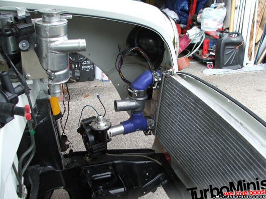

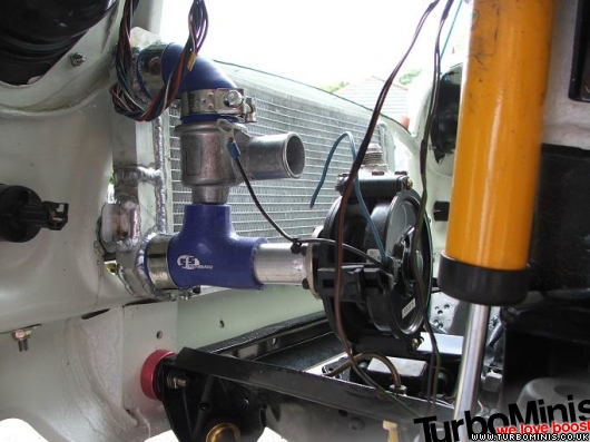

Rad now mounted on the front panel, made a start on the rest of the cooling system. fitted the bypass thermostat, made a bracket for the header tank and ugly MIG'd them together, made up an adapter for the water pump inlet again ugly MIG
Everything looking good so far. need to make a mounting bracket for the water pump and another adapter for the water pump outlet then all i need are a few simple hoses and the cooling system is done *happy*
The only problem now is the bulky pre engaged starter motor *oh well*

Nice job, you say the core is a Corsa 1.4 but is it a pucker after market ally core or just a replacemant part you've moded, s I'm now in the market to replace my slightly damaged one *tongue*
Jordan, Yeh, that steel front is way better :) and the bulkhead needed a little tidying up. Doubt it will stay clean for long *tongue*
Shed, its personal prefference I supose. Question for you, why do all the Miglias run a front mount rad?
Gavin, its a Nova rad, not the Corsa. Its a Nissens YB63287A replacement part. http://www.radicool.co.uk/vauxhall/nova.htm though the rad was a little cheaper than that when i bought it im sure. Obviously the flanges (he he) need reworking abit, and there are a couple of areas where its started to crack a little where i never anealed it properly, but it doesnt leak, which is all that matters to me. The other option is to buy a core from Pace http://www.paceproducts.co.uk/public_html/...php?productID=7 but you may already know this *wink*

The stat is actualy from a TVR, but there are a few knocking about of different shapes if you know where to look
Dave, just make sure you know where your roots are and dont get too Americanised, I bet you have an accent already *wink* : Any jobs going?
very tidy
can i ask what size the outlets are on that stat?
35mm inlet, 25mm bypass, 35mm outlet.
A little on the big size for what I wanted but the 25mm bypass was what sold it for me. You try and find a silicon equal 'T' *oh well*

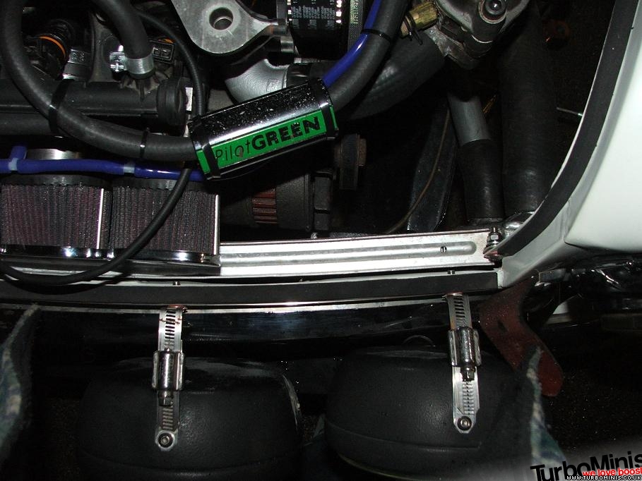

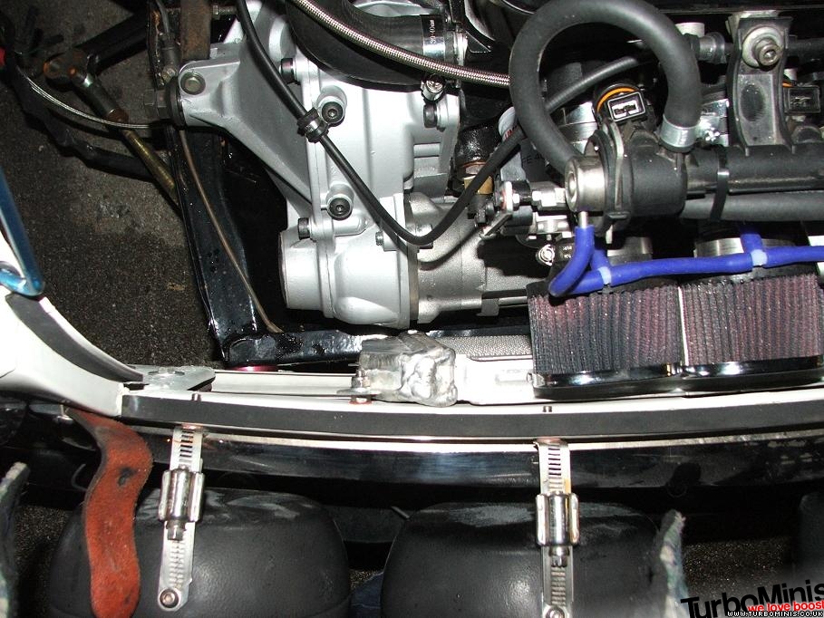

Everything is now in except the fan, which needs a little trimming of the cowling, but it will just fit.

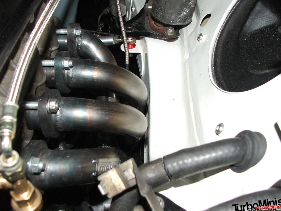

The bonnet still fouls the head. The bonnet needs another 10mm to fully close, so it looks like i will still have to cut the cross brace, even though I was hoping to get it all in under a standard bonnet, Hey Ho.
Theres about 10mm between the alternator and rad, and about 5mm between starter motor and rad and thees 5mm between exhaust manifold and bulkhead. so it is a little tight, but not as tight as another I have seen *happy*

Bloody hell that just fits. Well done for getting it all in.
I presume that its all solid mounted to.?

Are Maniflow now doing manifolds for K heads, or did you chop up a couple of LCBs & fabricate you own manifold?
commisioned by SC i think rob
