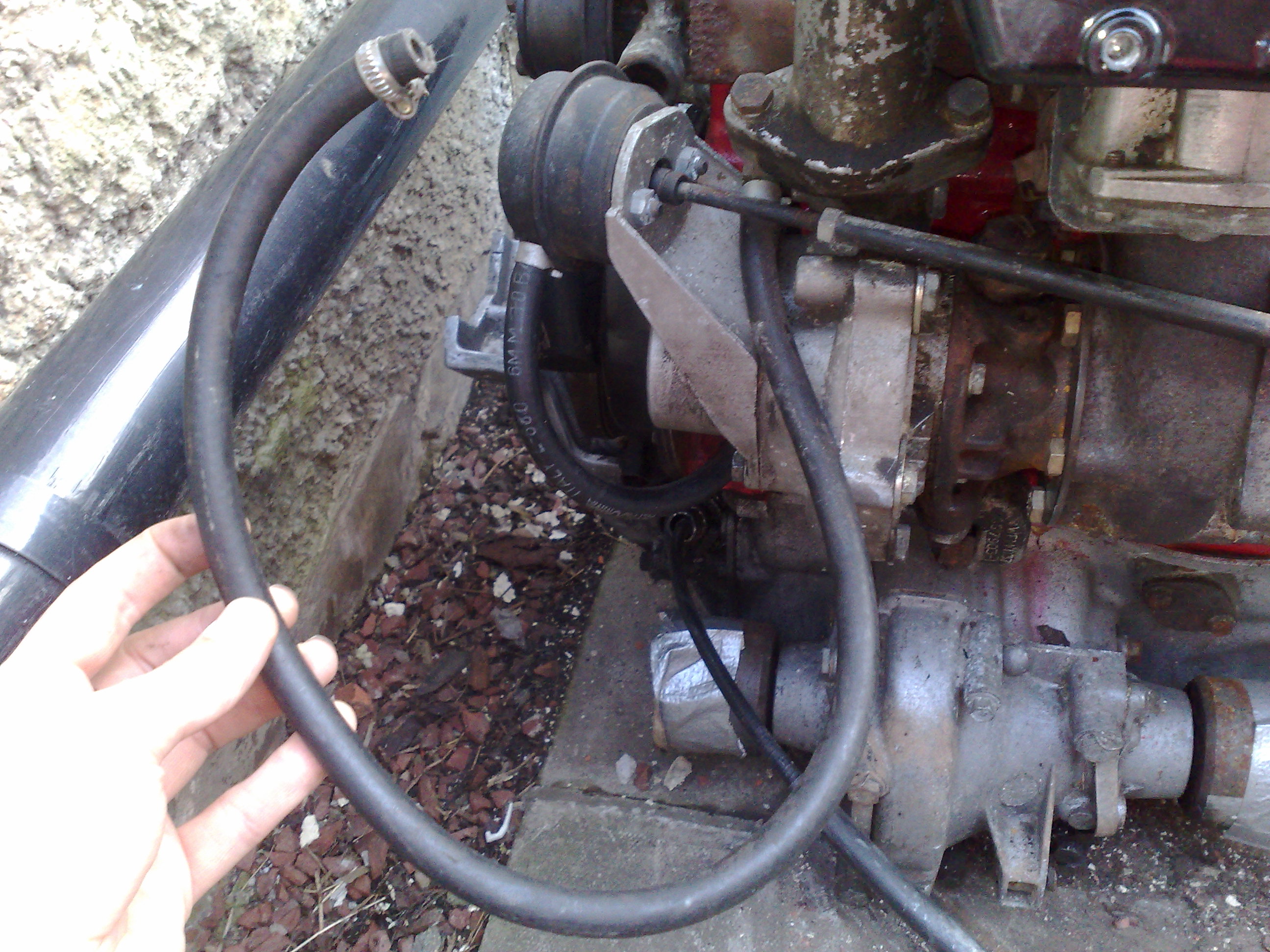

Hi guys, I've had a look through the search option, but it doesn't really explain where I stick this pipe?, basically it goes from the actuator to a brass connector, then just a pipe, from what I can gather this should go to the ecu, which I don't have.
Shoud I block this off, giving me 4psi throughout, or can I stick a bleed valve onto this?

Yes block it off. The bleed valve goes between the brass fitting on the compressor housing and the actuator.

as bat says... however for a few month I did run a bleed valve off the 'spare' outlet and just blocked one side of the bleed valve off. Worked just as well.
