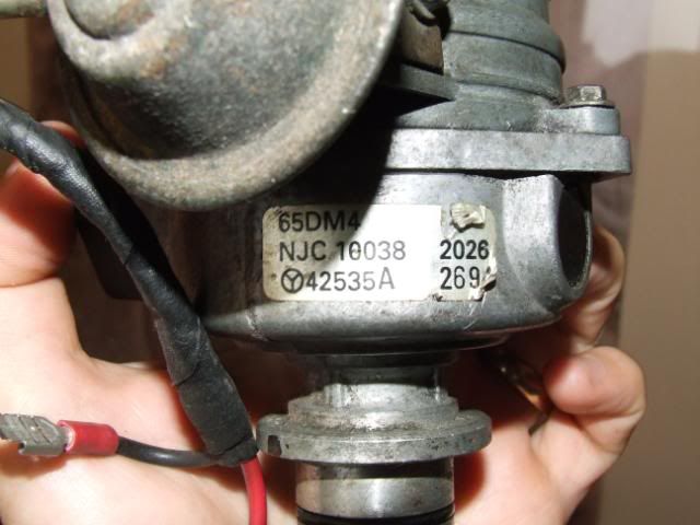

well having read that i reckon the duff engine i bought when i first started the turbo campaign (same engine which transpired to be a total lemon)
the code is (on sticker) 65DM4
NJC10038 2026
then under that again a cicle with a Y in it and 43535A 2694 ??

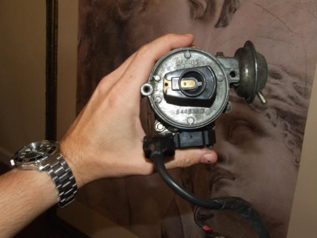

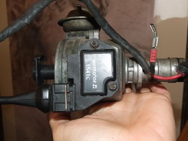

dizzy is lucas sealed type with electronic module casting number 54403817
will take some pics
EDIT:pics added

This may help:-
http://members.home.nl/mmarx/mini/distributor.htm
It looks like the 42XXX number..
42628 is the turbo one. The 42535A is not listed as a Turbo but seems to be a good alternative. 42627 does not!!
