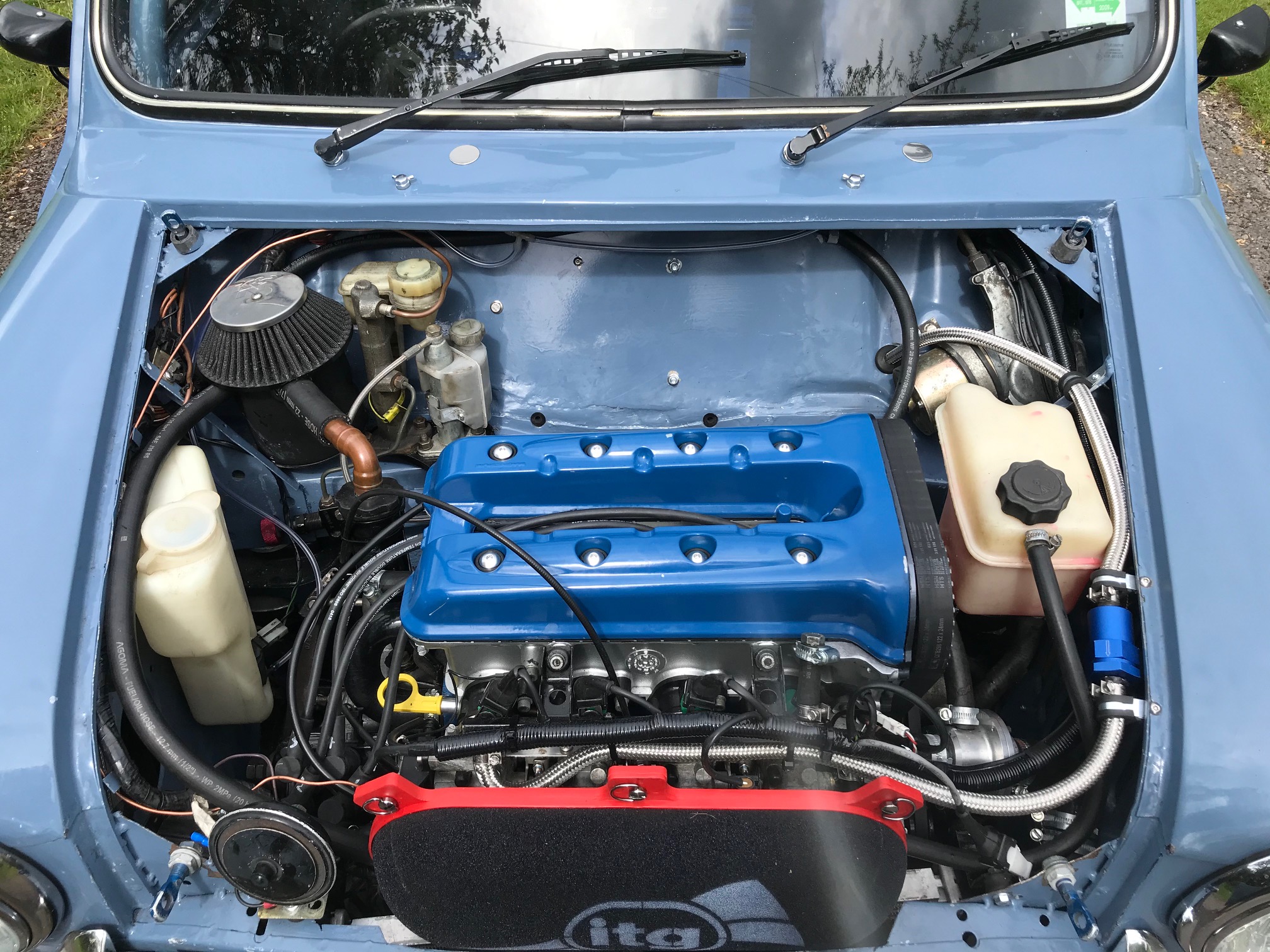

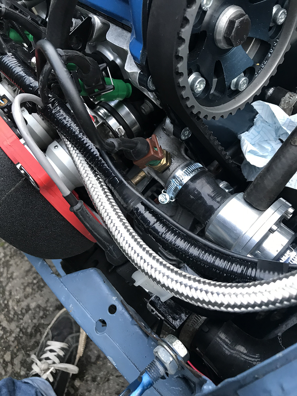

My car is being tricky to keep cool - BMW head, dry decked, cinq rad and good fan. Theory is that the water is taking the path of least resistance via the SC thermostat adaptor straight back into the bottom hose instead of circulating the full system. Rad does get warm so not a sticking thermostat though.
As I have 6mm ID feed from head to expansion bottle anyway is it even needed? Thinking I might just stick a clamp on the bypass hose for now and see if that cures matters, if so blank it off completely.

Not something daft like an air lock is it?
Out of curiosity (and off topic) is the clutch housing the only breather that you run on the engine?
Shane
4309 Posts
Think I’m clear of air locks, even had it up on the ramp to tempt air residual bubbles out.
I have breathers all over the place. Dizzy hole, head, oil drain and clutch cover. All collect in the catch tank.
shane
2646 Posts
Member #: 1246
Lowestoft, Suffolk.
Could you pop a restrictor in the bypass line to reduce the flow? something like a piece of round bar with a hole?
How do you have the radiator piped?
Shane
