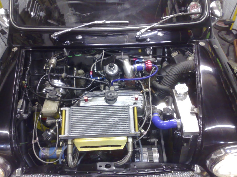

Hello, currently i have my oil pressure switch in the turbo feed t-piece but i want to run an oil pressure gauge as well, just wondering how other people have done it? Thanks
I drilled an taped another hole in the t peice,
altenativly you can add another tpecice into the first.

I used one of the sandwich plates on the oil filter that someone else on here recommended a while back
Me too, they make life much easier!
Plus they usually come with little blanking plugs.

On my oil feed the feed to the turbo is off a banjo fitting, with a male that sticks through it. Then the T piece screws onto this, leaving one port for gauge and one port for switch.

Cheers guys, any links for the sandwich plate? Ta

I always take the oil feed for the turbo from the top of the filter head - drill, tap and screw in a male quick release coupling - attach the female to the turbo pipe - fresh filtered oil! (never cooked the turbo bearings in 5 years of racing!) Use the block take-off for the pressure gauge and add a T-piece if you want a light as well. Philtune.

I took my car to Beechgrove engineering where it got measured up for the braided turbo feed pipe and a braided oil pressure gauge sence line got all the fittings and seals with the unions of my choice.
Both my lines run parrell to the front of the block between the rocker cover and thermostat housing.

Just found the perfect solution :)
