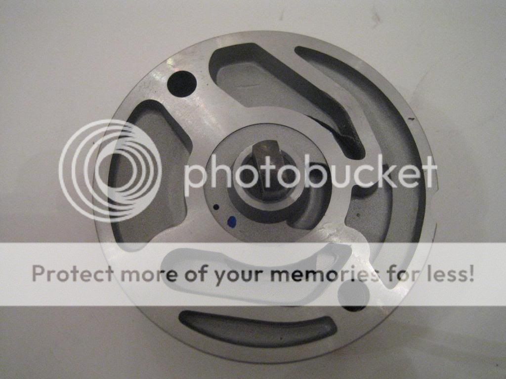

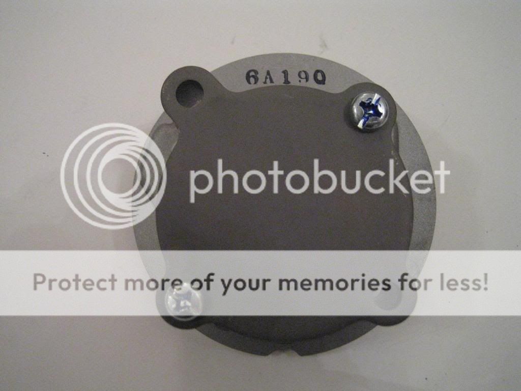

Hi again.. I searched everywhere but cant seem to find the info.
Would anybody have a clue about this oil pump.
Good for a high rpm engine or should I get something better?
Thanks again
its a steel backed pump and should be up to the job
if you want to spend a few sheckels more on a supaflow pump from Avonbar ... so be it
