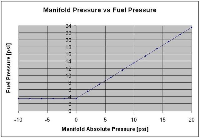

Out of interest what size fuel lines are you using?
I'd set the fuel pressure as said above to be sure, 3.5psi at idle and get a fuel pressure gauge to see what its doing higher up the range!
richminiturbo.
2370 Posts
Member #: 719
Horndean - Near Portsmouth
Just found this graph Tom Fenton made a while back!!
