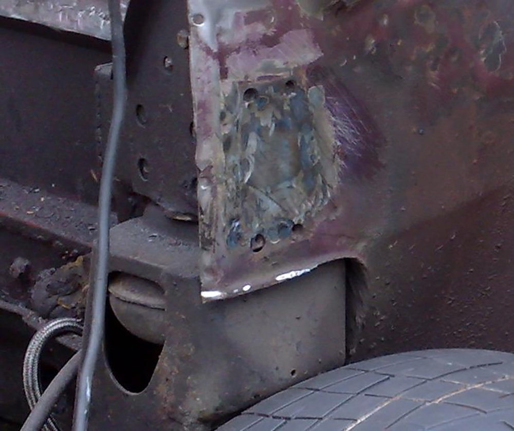

Chuck some pics up so we can see what's what.
lol when i did mine, ground out all the rust, acid etch primer, anti rust primer, than 3 coats of hamerite, plated over same on the plate, sorted*happy*
mugglebum
46 Posts
Member #: 3645
LEATHERHEAD SURREY
that photo is exactly like mine mate , wats behind it !!!
did u pre drill holes in a plate ?
do u have a photo or the repair
i only have a couple of inbetweenies and then the final pic before paint:)
the hole just goes through the main bulk head i am almost certain it is accessible from just under the dash,
i did not plate over the hole, i made a plate than fitted into the hole then seem welded around it and ground it flat, after paint you could not tell*happy*

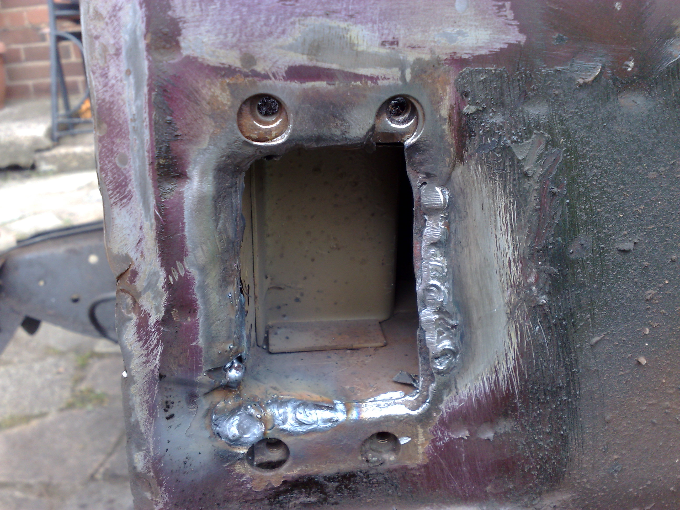

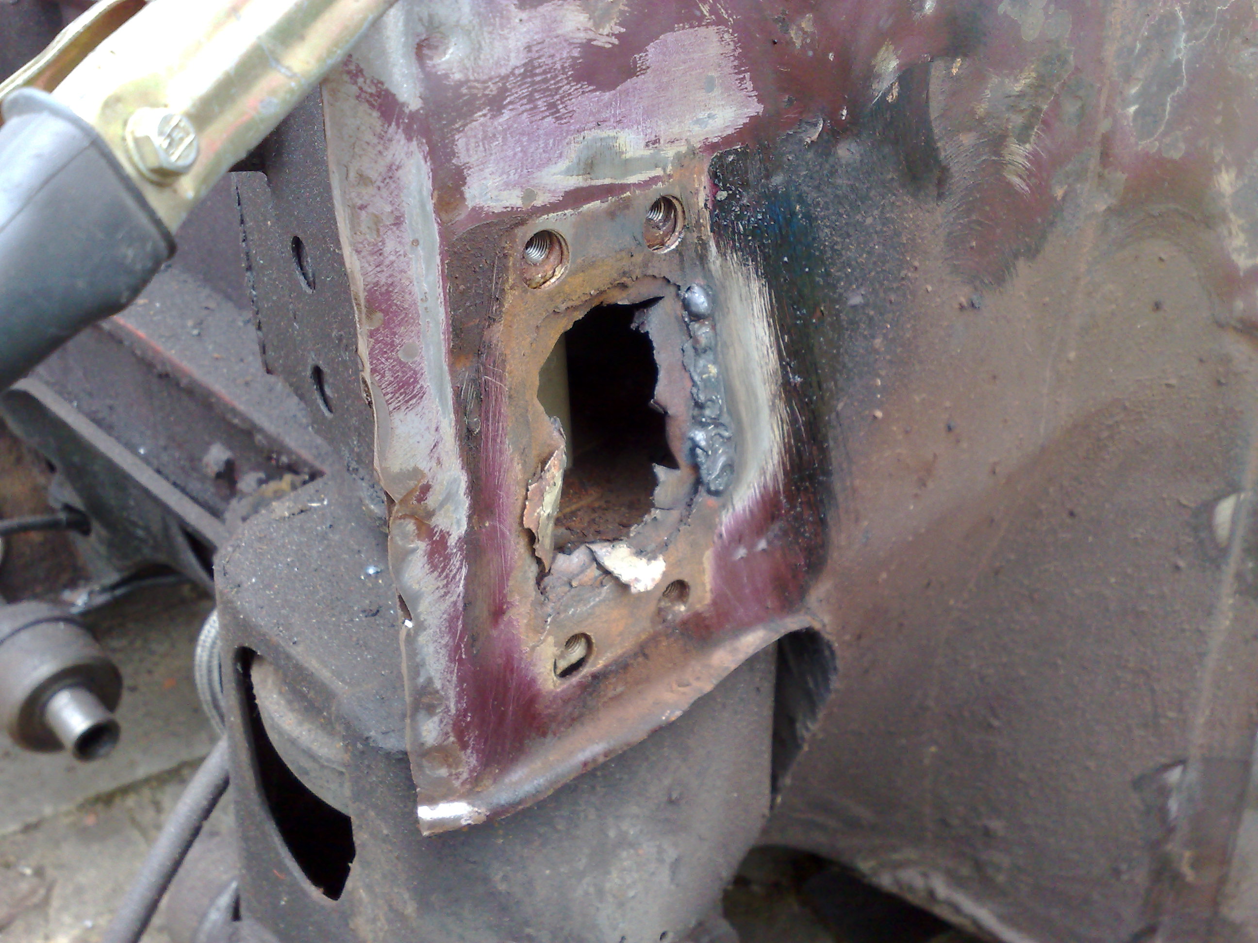

these are the pics . i will be cleanin them up but just well anooyed at these holessssssss
this one doesnt look as bad but im sure once i had a dig itll be the same as the other
any suggestons welcome
they dont look too bad lol,
1) wire brush cup on an angle grinder then neaten up with a grinding disc
2) make a template out of cardboard,
3) cut out of steel,
4) weld in to the hole keeping the plate flush with the original lines
5) not forgetting to treat / remove all the rust and cover with an etch primer and something like hamerite
jobs done.

Seems to be acommon problem caused by the double layer of metal there, Heres's my fix, I used thicker than normal plate to make up for the double thickness..
