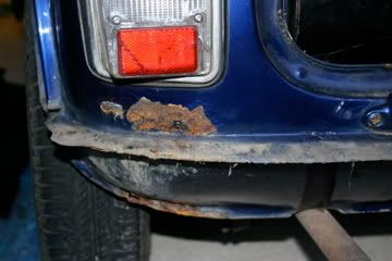

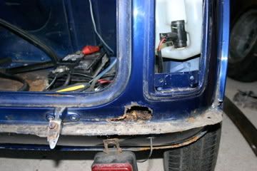

these two holes but i have a replacement pannel to go all the way across and a new rear valance

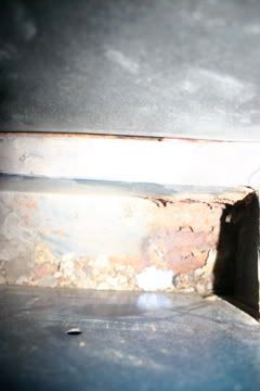

some of the rust!!! bits

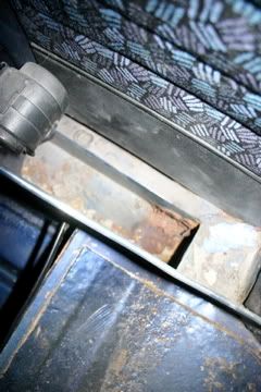

the pockets in the back have rust , my friend is cutting out the pockets to fit my roll cage when it arrives , i think well have to try and sort it then !

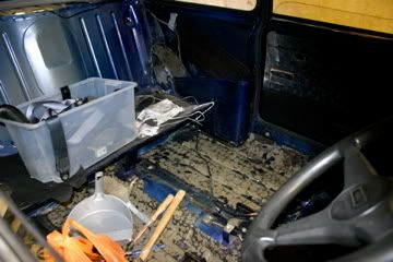

i started taking the sounddeading off the flooor ! wat a horrrable job but the bag after weighed so much glad i did it

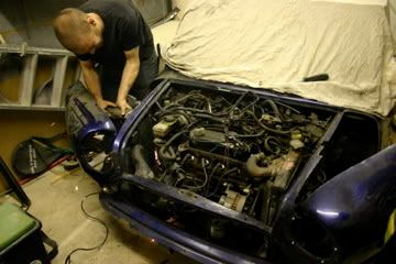

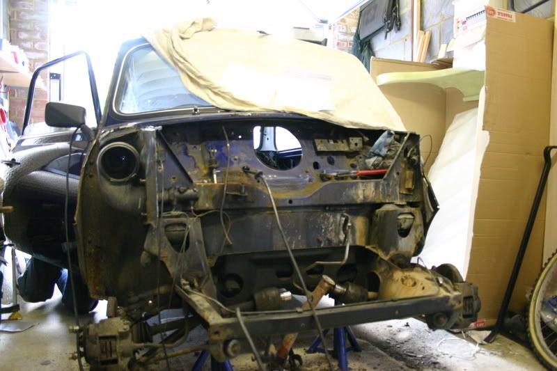

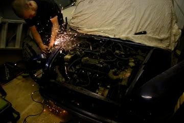

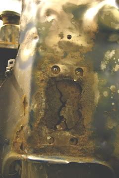

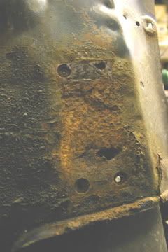

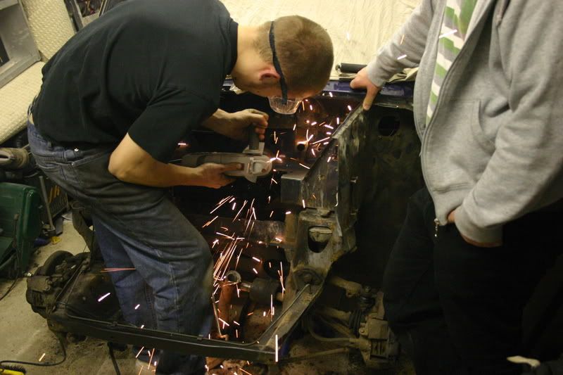

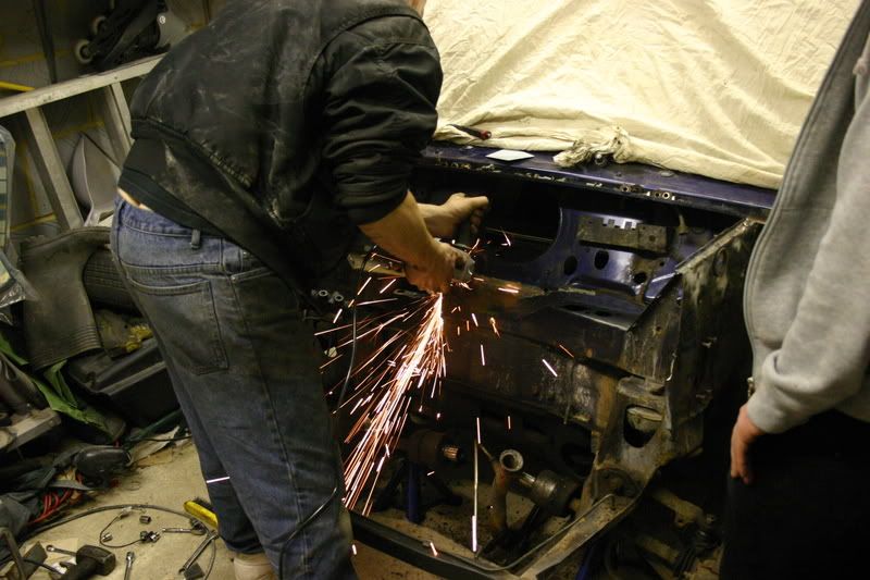

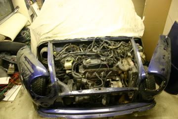

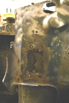

then me and a friend cut the front off !! ive got a clubman 2 piece to try and fit at some piont !! tried cleaning up the innner wings found more rust under the brackett for the shocks which SUCKKKKKS
fitting the support bars this weekend ! and hopefully some how fix these shock rust thingyssssss

advice is treat all de scabbed rusted areas with underneath panels new wings etc with red oxide primer.
you can mig weld throug this, the rust keeps well at bay following a top coat of houshold gloss and ........ then! shults with added waxoil trust me.
everyone gets stung with the brought bought thing mate trust me!!! lol its all in good heart just a certain Viking telling us english how to speak our language *tongue*
Steve: i hate waxoil!! yuk never dries!! horrible to weld anywhere near aswell! i would have thought schutz on its own would be fine dries hard and its ok to grind off agin if you ever need to.
IMO of course.
I always get rid off ALL of the rust either by cutting it all out or grinding it all out. then you can buy weldable etch primer which is pretty good but generally only used for spot welds.
no matter what you paint behind the patch with that will allow you to weld through as you have to seam weld it its just going to burn away around the weld with the heat. unless you take it stupidly slowly but is it really worth it!
once you have welded the new patch in mate get some brusable seam sealer and paint it over the welds. seeing as it doesnt really matter what this area looks like this will prolong the life of the welds in a big way mate.

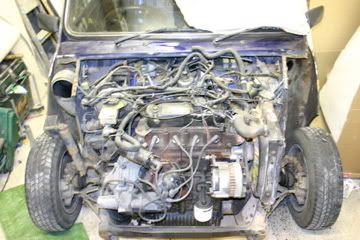

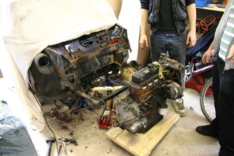

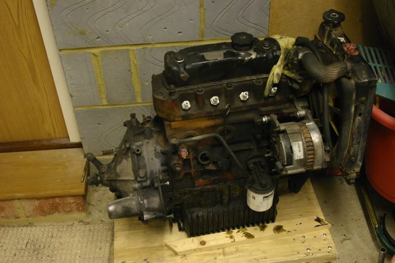

got everything out the engine bay pretty much!!

and generally cleaning bits up with the grinder
cheers to alex and dan for all the help
