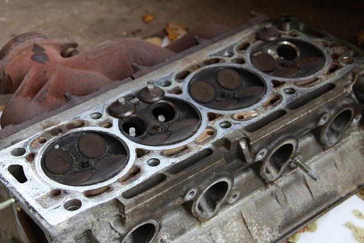

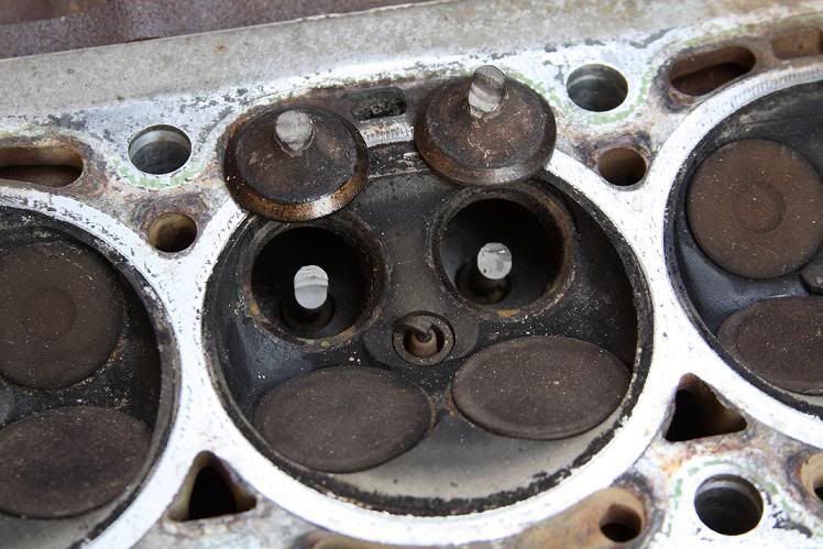

Recently i booked my pug 406 in for a cam belt service, its the sort of job i would normally do myself over a long day but been feeling a bit grotty i could not be arsed
they say that pics speak a thousand words
the heads been sat in the rain thats why the faces ect are all grotty
currently waiting for a new head to be built up and fitted

are the pistons ok?
Mi16?
pistons ok mechanic sacked
how long before someone asks if that will fit on an a series?

i'm guessing he fucked up the cam timing.... big time...
I've had 14 (out of 16) seriously bent valves when a belt stripped a few teeth then picked up drive again....
But none broke.
I guess mine were stinking hot at the time so quite ductile, and these were stone cold ???

did he fuck up the timing? or not tighten something enough? tensioner mayne?
fucked the timing
the story i got is that he changed the belt where the engine stopped rather than pinning the cams and setting it to its correct timing marks
ouch, i bet it wasnt even marked when he did it, definately not the way to do it but it might have saved your engine!
we wont do a cambelt without having the correct timing pin set! too much to risk!
the tipex marker change... hope they are paying for it...
