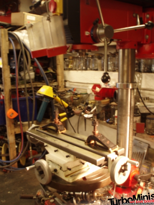

well, i havent milled anything since first year uni 6 years ago, so today had a blast at milling my centre main cap
took most of the hump off using the angle grinder, leaving about 1 to 2mm to mill away
set the drill up with a compound table i got from axminster for about 70 notes, and set the drill to 120rpm

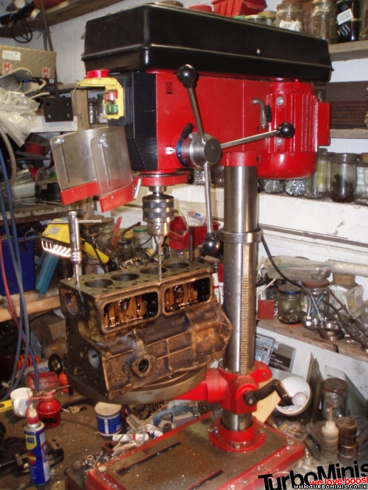

the drill:
results were great, i wasnt sure whether it would be up to the job of doing a mains cap, but it was no trouble at all to it, there was a little bit of chatter as the compound table was bolted tot he usual adjustable drilling table which was sturdy but not 'rock solid' so deflected a tiny but and gave a slightly rough finish, but lots of wd40 helped there and it wasnt anything a quick rub on a stone afterward couldnt fix

how come you took such a deep cut imo that is why you are geting so much tool chatter, Iwould recomend that you take several light cuts at a slightly higher tool speed you will get a much smother finish and a lot less tool chatter

Wow a scale model A series block, how long did it take you to make that? *wink*

It looks to me as if you were feeding too quickly from the tool marks on the job.As you dont have the power or rigidity of a proper mill, you have to go very slowly.
