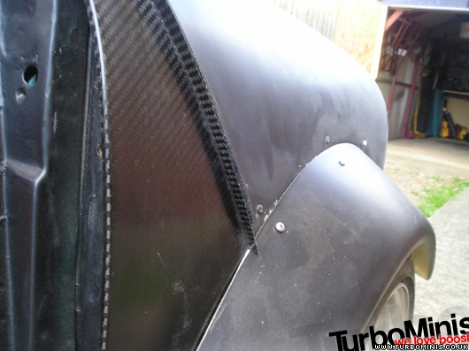

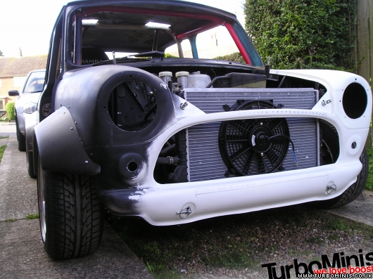

So it now has the interior completely stripped, carbon front end, bonnet, boot, a panels, bulkhead box, and lots of other little bits

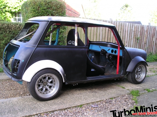

here it is, before i stripped a load off of it, ready to fit the engine
the front end

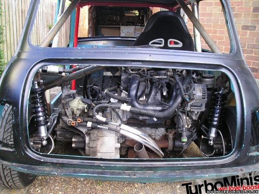

And i'm in the middle of mocking up and building the engine cradle

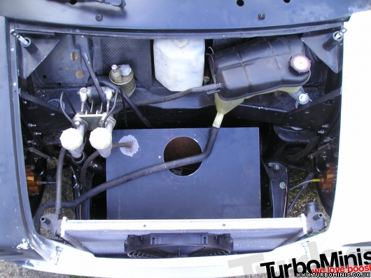

yeah, bulkhead box was a bit of a waste, but the old one looked rubbish, so i'm putting the washer bottle there.

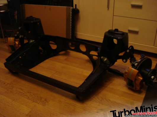

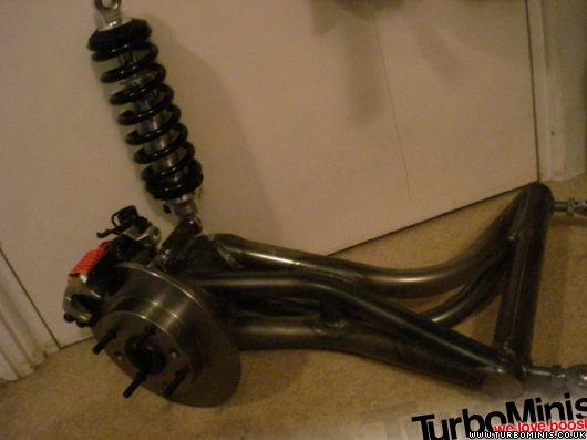

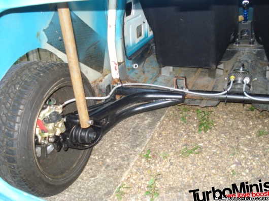

basically its a z cars trailing arm setup,
but im building my own frame to hold the engine
the picture above shows roughly what im planning on doing
RobH has just lent me a tube notcher, so hopefully i'll be starting on the real frame this weekend

Hows is the engine mounted??
steve w
656 Posts
Member #: 1917
AKA chargedzetec
similar to z cars
engine mounts from the focus, a frame built onto back of the cage.
Then some brackets/bracing made up to connect the two together
fairly straight forward, around 6.5m of rollcage tubing in total

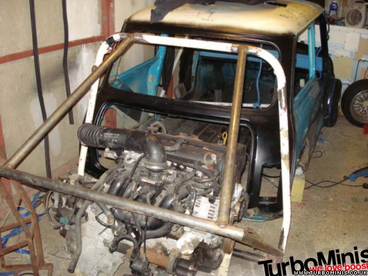

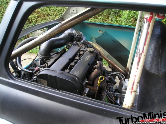

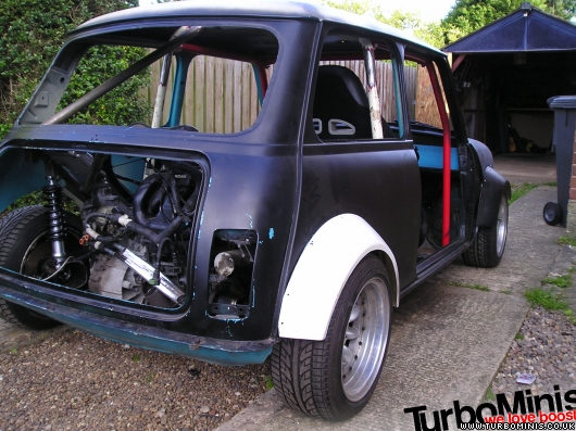

well, progress. I'm currently trying to prove everyone, who sees it, wrong.
Nobody believes it'll be ready!
Lifted the car off of the engine, and frame. now its been tacked up, i can mounted the engine to it, out of the car, and fabricate the gearbox mount
makes me realise how much ive cut out!

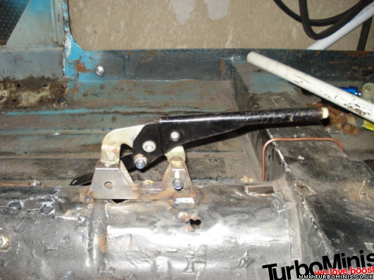

Handbrake bracket welded on. Had to move it because of the gearlever being in the way.

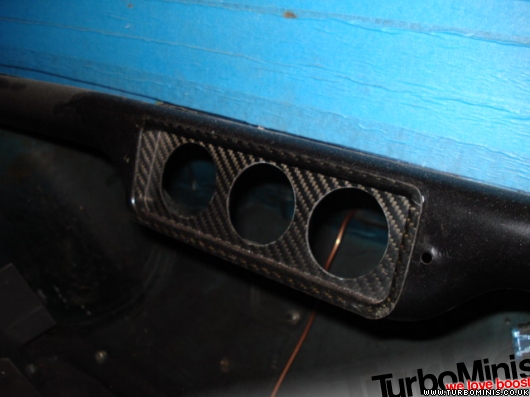

Also discovered that if you flip a cosworth guage holder over, it fits the the switch panel hole quite well! *Idea*
