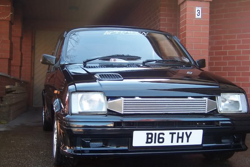

3. Have an intercooler made like below(Id want tabs welded on to fill the gaps in the corner which I can spray the same colour as my car). Will only need to move the rad slightly

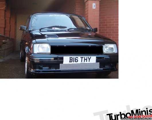

I'd be trying to get something thin in front of the rad, covering it completely if possible.
A lot of the modern ICs are like this.
Gavin :)
My Mini build diary
I'd move the number plate up a tad and fit it below the plate. Fit the standard grill back on for stealthness. Fitting it lower down (set back behind the line of the bumper) should cause shite loads of air to flow through it, especially if its below the rad so nothing restricting the flow coming out. *wink*
The lower down the better IMO, you get far less heat soak when sat in traffic etc..
do away with the bonnet and have a huge charge cooler in its palce! anyone got more beers :)
Something like this....well you get the idea! lol
Paint it black too! :)

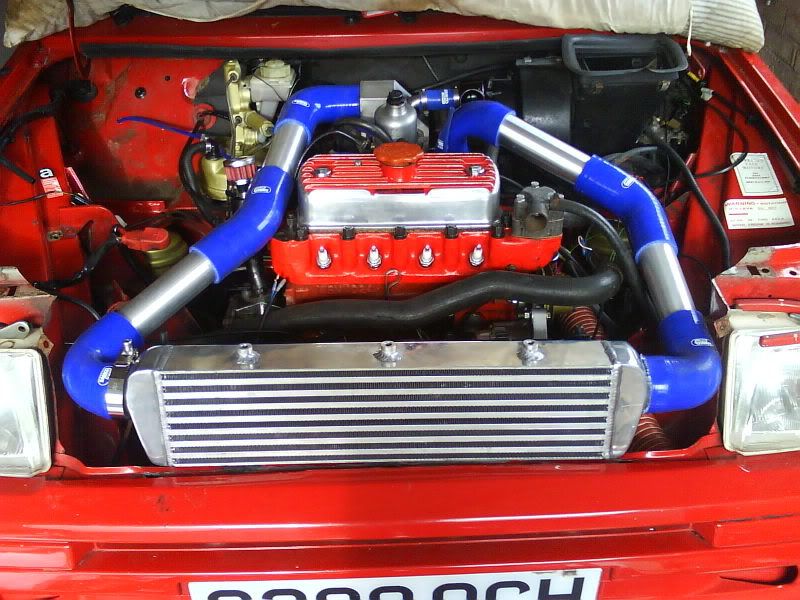

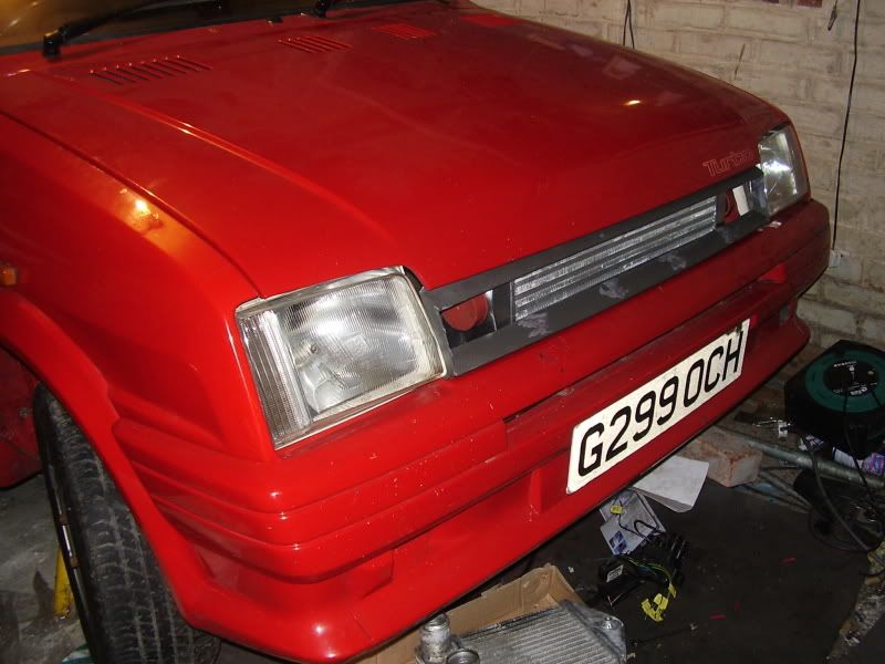

Decided to go with keeping an intercooler behind the grille. Intercooler has arrived aswell as a slimline fan.
I've offered it up(wedged it in :)) and with a nippon alternator should work well might need to grind a few parts back aswell though.

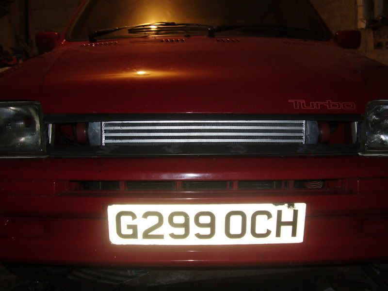

Ive started to make a grille with the slats knocked out so you can see the intercooler and give it some more air but I still have the original MG one if I want to go subtle.

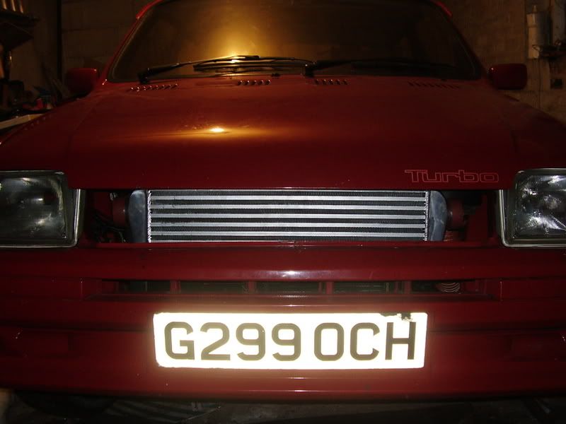

Is that one of those ebay Intercoolers from 2fats2cool?
that is a nice fit :)

Star Mag
1745 Posts
Member #: 375
Leicestershire
That looks the business *Clapping*
Nice fit!
Original grille all the way!
