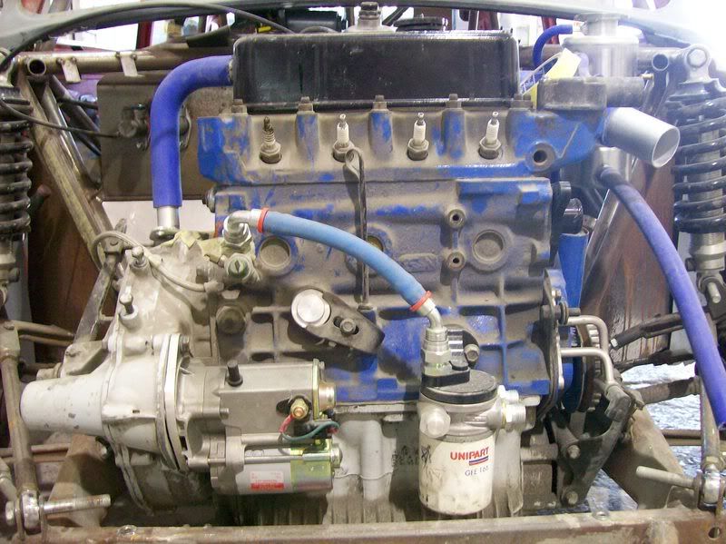

I bought a sandwich plate type from Merlin - about £44.00 inc the fittings IIRC
You can just see it here

It quotes a thread size of 3/4 UNF and I think you will have to use a smaller filter - as I said I use Ford Ka halfords own as champion is too large - don't know what size the Motorcraft (OE FORD) filter is
HOF264?
On 5th Sep, 2011 Vegard said:
Thats the exact one i got and yes the 3/4 thread is whats needed.
Ive also got a standard filter on aswell.
Il try and find a pic?

Is that with the standard front subframe or in your case the bit that is normally there on a steel car?
Nick i still have the standard mk1 front subframe built into the frame.
