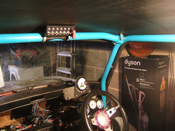

Ah, sorry all. Some info was missing. At the time of putting together a new switch panel it proved nigh on impossible to find an off/on/on switch to match the other off/on switches, i.e. to ensure that "all switches were off when up".
I have an on/off/on lights switch working through a normally on relay to "hold relay off" when the switch is up [on], and "be normally on" when the switch is in the centre [off].
You may need to read that twice to get it straight in your head.
For this to work, the relay must be "energised" (right word?!) for the lights to be off. i.e. when I'm not in the car, thus draining the battery. Hence not wanting to leave the lights wired such that they are held off via the relay when the car's not being driven, so wiring to ign pos 1 seemed a way out off it.
What I hope to do ultimately find an off/on/on metal toggle switch!

Thanks for the feedback, 2 switches was another option I'd considered actually Bat, but Sturgeo's off/on/on might be the "neatest" solution - espicailly since the cage is out at the moment and I can get to the switch pod easily...
(http://www.turbominis.co.uk/photo/1212/)
