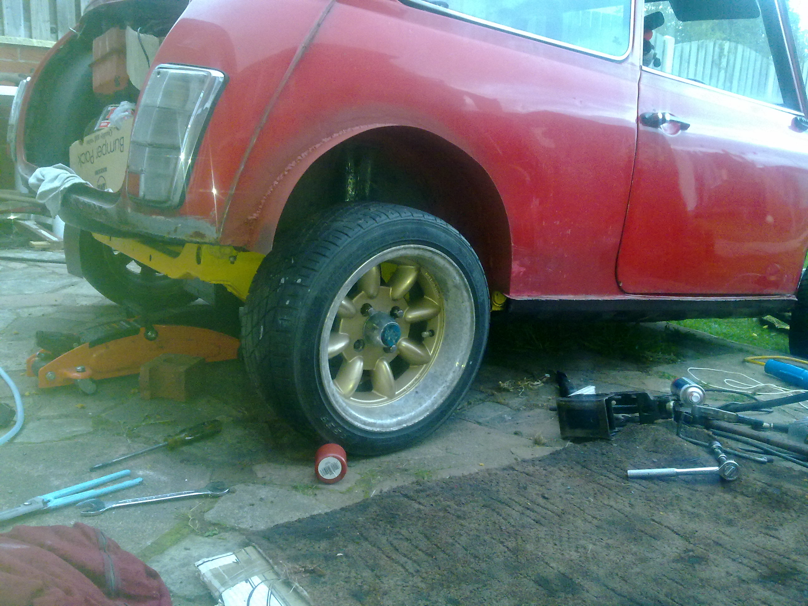

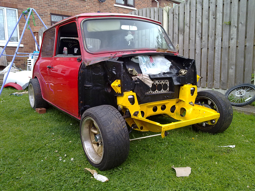

well managed to get my arse into gear this week end, its back on the ground now and looking good *smiley*
Warning!!
6683 Posts

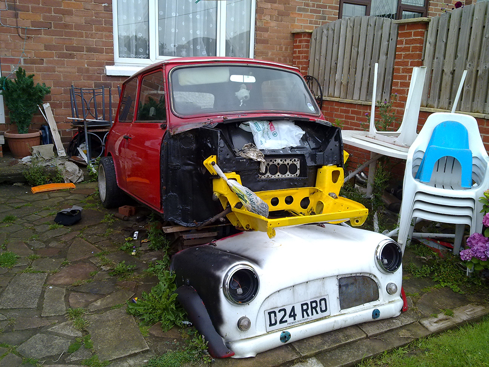

there is a few bits and bobs left to do on the front subby, the top arms never got painted because the hamerite yellow paint is shite and just flakes off *frown* and rather woryingly the ride hight at the front is stupid, i know there is no engine and it needs to settle but its got maybe 3-4 inches to drop before im happy and the adjustable cones are fully wound down *frown*
Warning!!
5391 Posts
It will drop a lot more once the engine is back in.

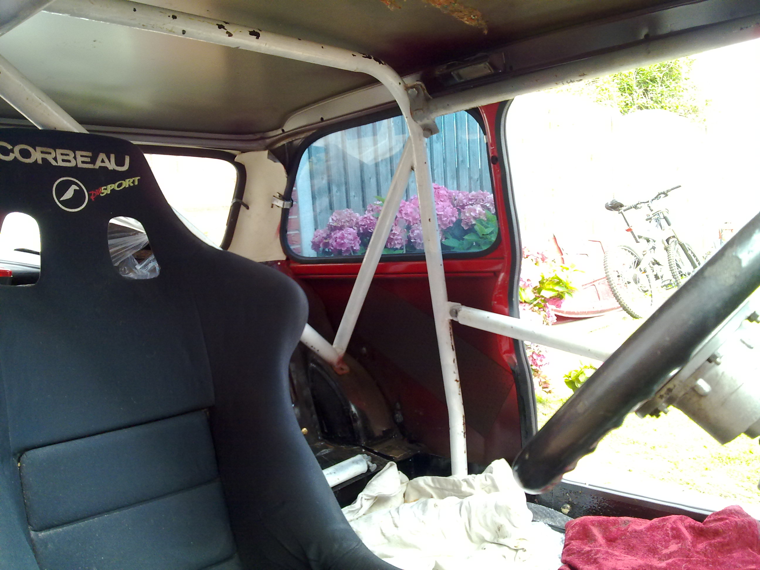

test fitted the roll cage to day, fitted quite well to say its probably a home build cage, one door bar is a good inch longer than the other though *happy*. i hit a small snag with my seats no way will they fit in when the cage is bolted up *frown*

6683 Posts
just a quick update, the engine from minimadmotorman is fully stripped, and been to the machine shop to have everything priced up, all the work on the block can start as soon as i get my hands on some pistons, accralite are out of stock in +20 and +40 thou 18cc.. witch leaves avonbar or some cheaper pistons

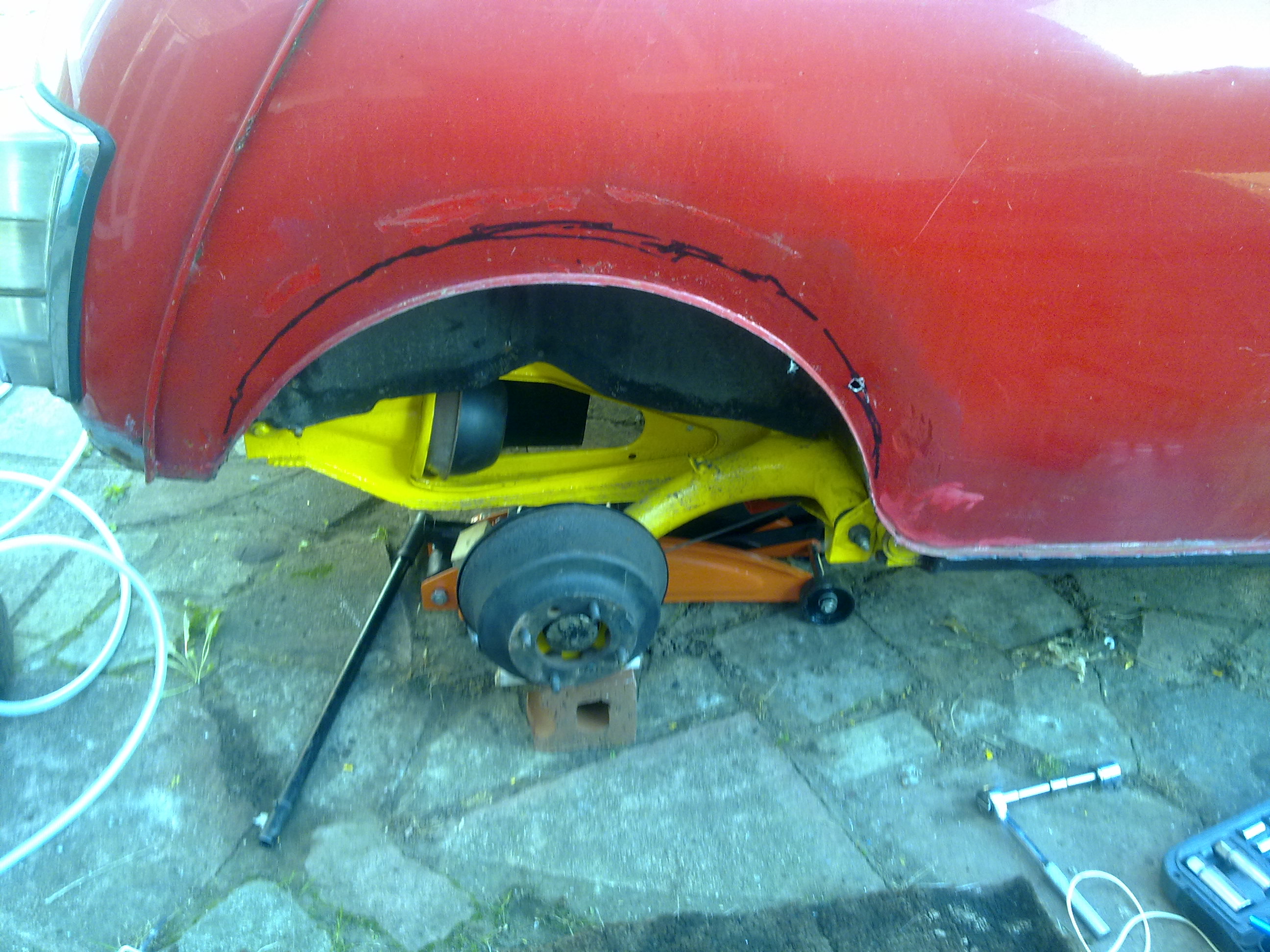

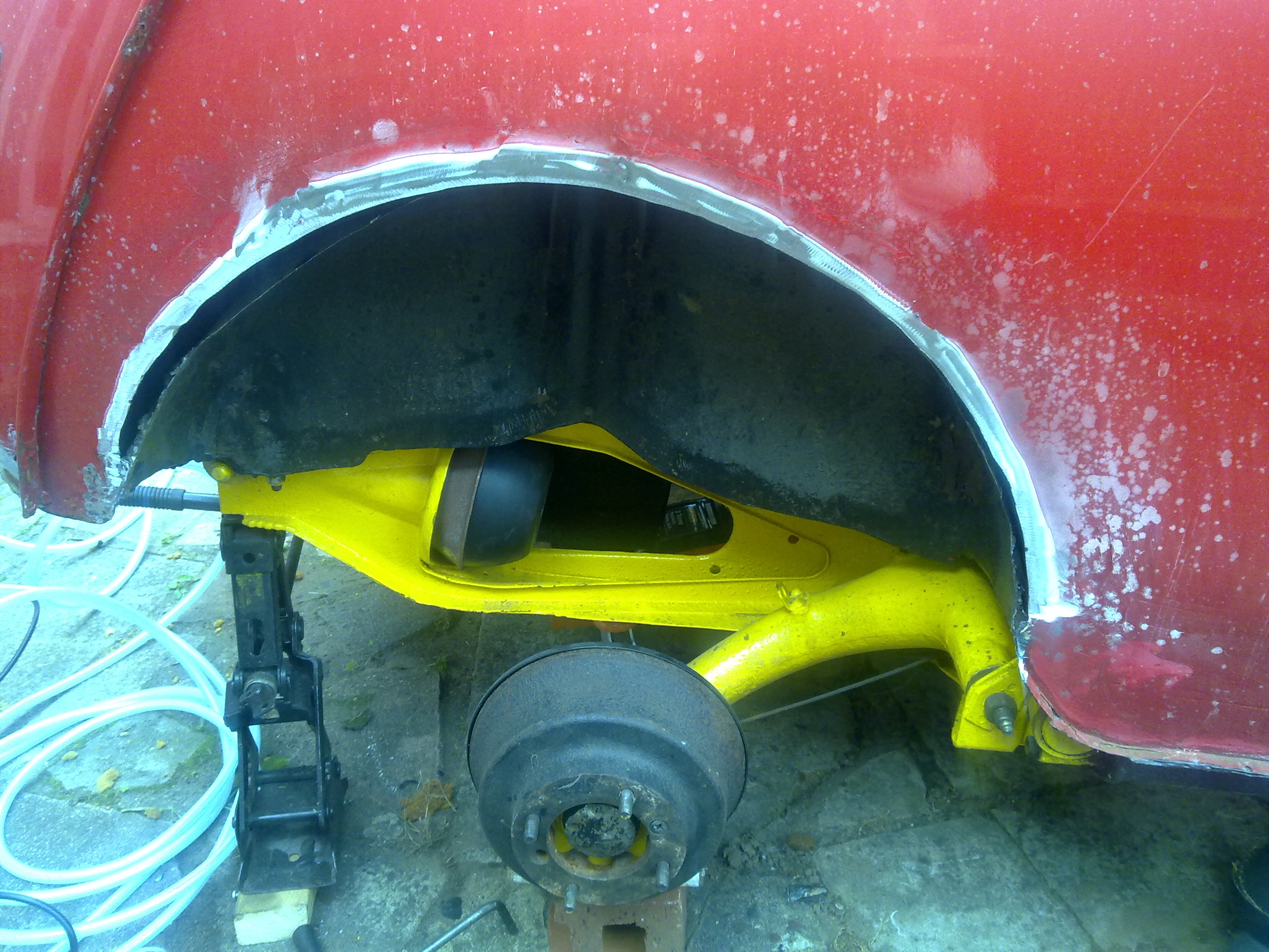

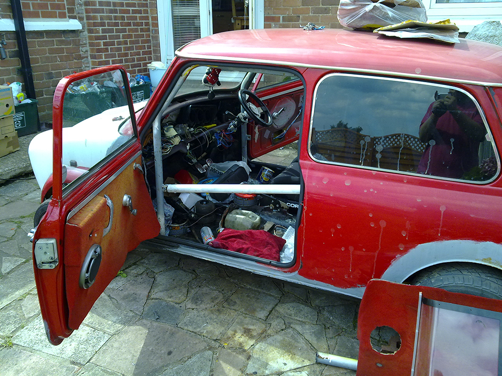

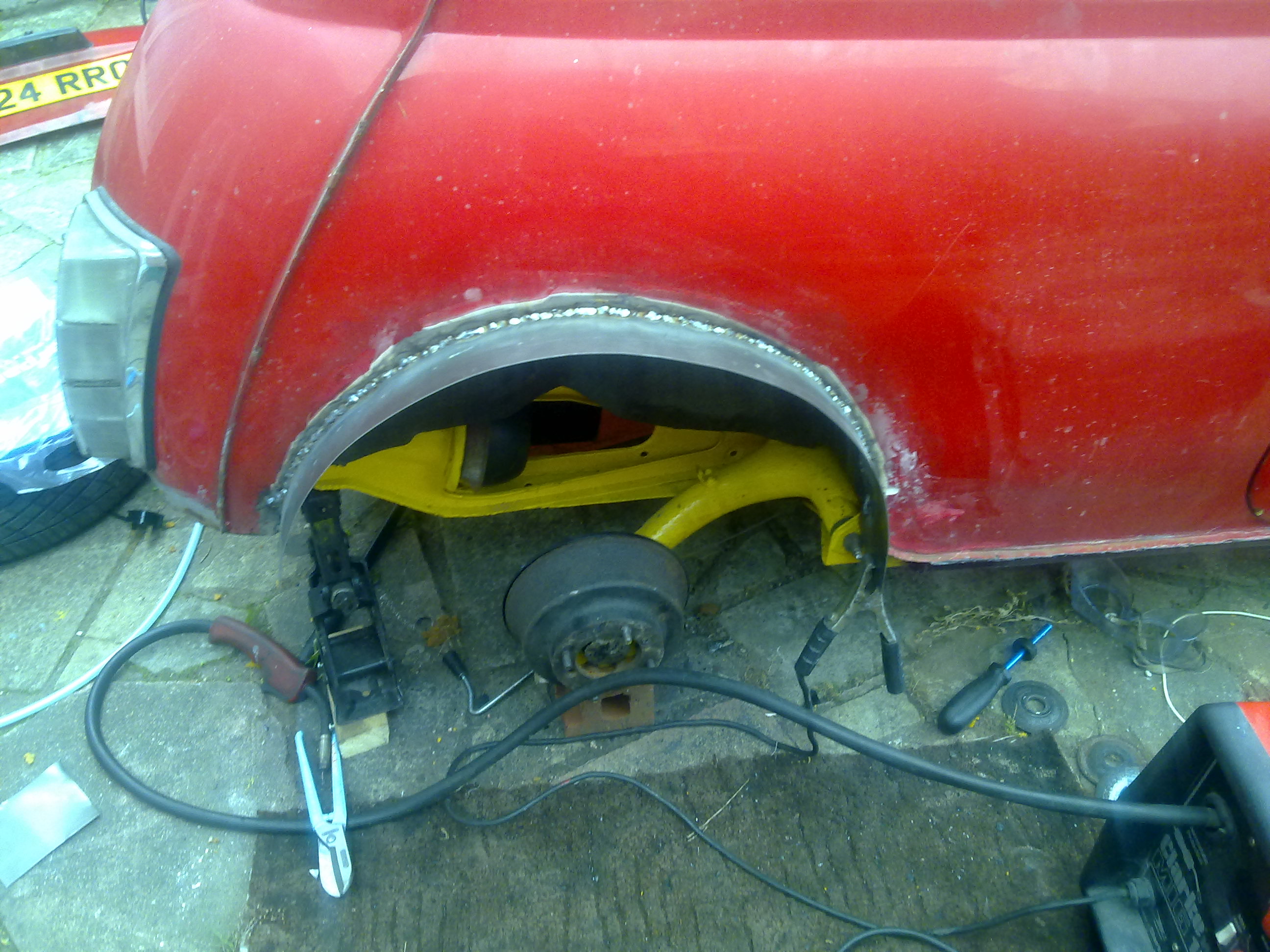

bit of an update, last weekend i ripped out the cage, chopped off all the bolt on tabs ground down all the joins because a couple cracks showing through the paint, it has also been modified to move it further back on the chassis i have managed to gain 5 inches of travel for my seat *smiley* i plan on rebuilding the front half of the cage when i gain a pipe bender in the next couple of months.. *smiley*
this weekend i have set about my rear arches, this month i bought an air saw to make the job easyer but i managed to seize it*happy* i did manage to get one side done though*smiley*
i was surprised to see how thin the metal in the arch was compared to the rear quarter
