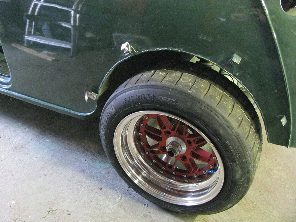

Atleast my tyres wont rub.....
Thats it bottoming out...

Yeah its gay isnt it.
I didnt take off ridiculous amounts when doing it. But still, the car is pointing downwards at the front, where the rear is so much higher, and you can see from the sill height its still pretty high!
