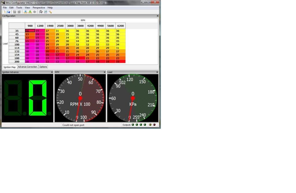

Post up your map around idle, see if there's anything that can be done.
Is there no idle strategy on these ECUs?
By that I mean you program in your desired idle, adv and ret figures and the ECU does the job for you...

Heres my map.
Anyone else got any idea's?
