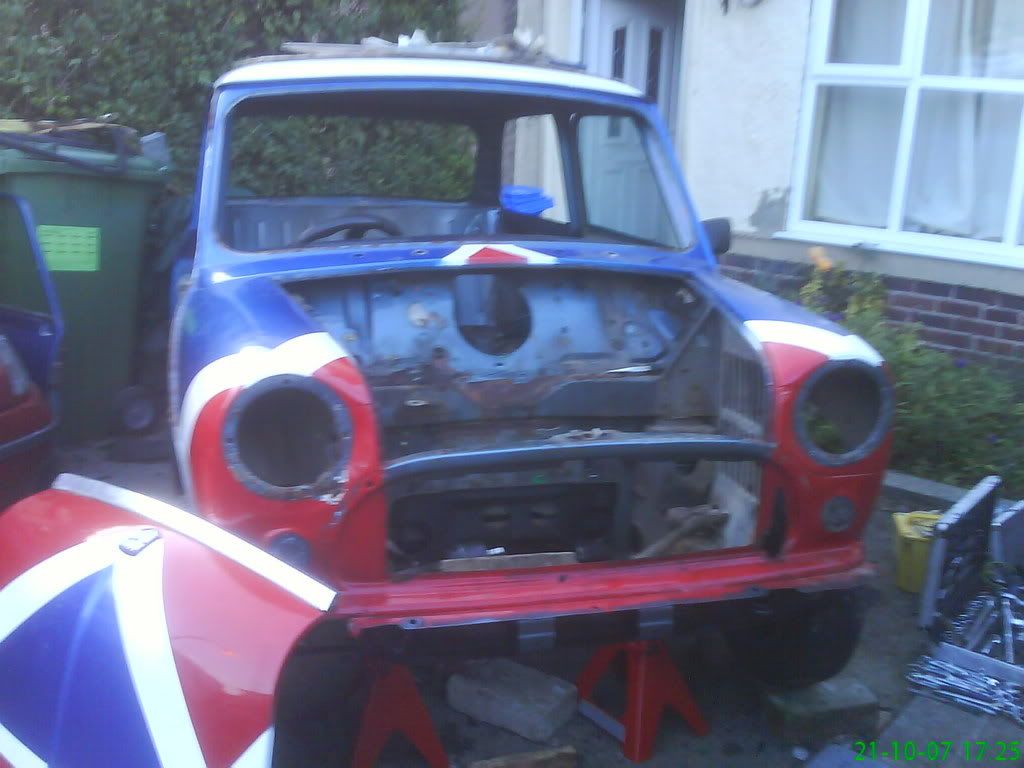

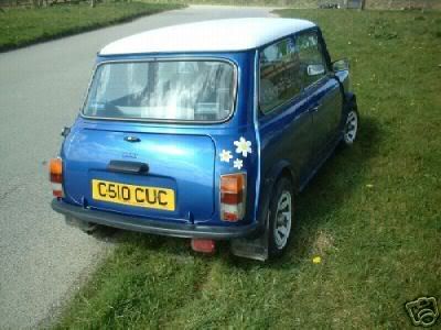

Still here goes in september 2007 i bought the missus what was to be a quick fix run CHEAP run aroundto get to work in it cost £310 and came as a non runner with a spare 1100 engine.

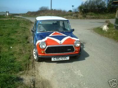

Unfortunatly i didnt get to look at it before i won it on ebay and well this was what it looked like
Paintwork was a little to be desired but i thought at least this way she could have it how she wanted.

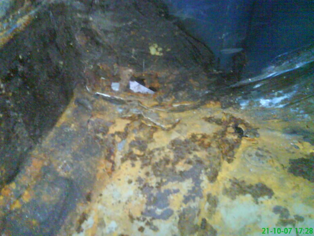

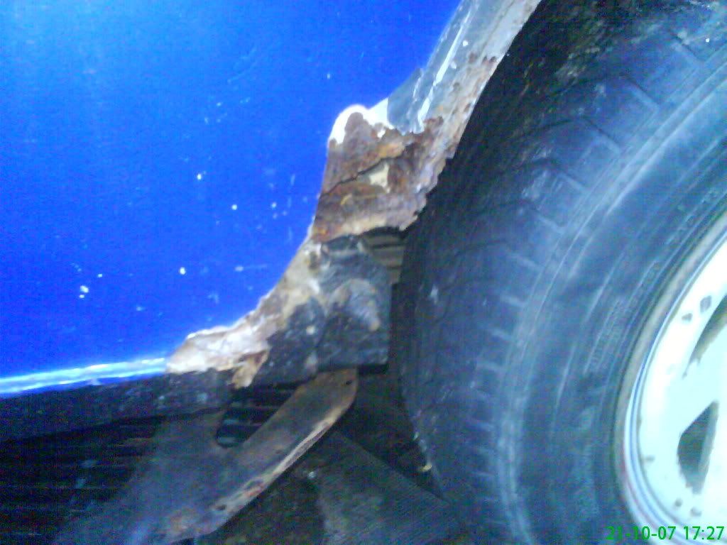

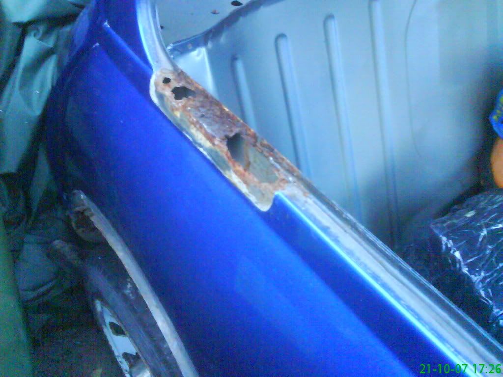

Once home i stripped it down and this is what it was really like!!!
Basically it was rotten and there's a lot more picture like that ! believe me.
The door resembled tea bags with aluminium patches GLUED on to them and painted over!!
So this quick fix was soon looking like a full on project and i had my own one of them to do!!

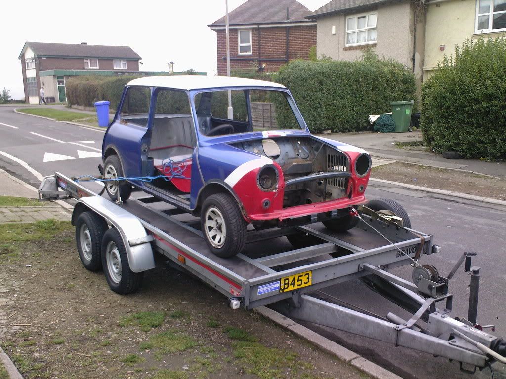

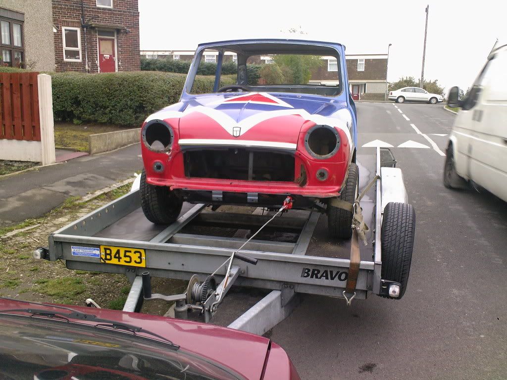

still living in a house with no garage and not being super confident with a welder at the time i sent it off to mini classics in blythe
this was how they recieved it.

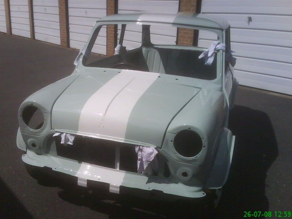

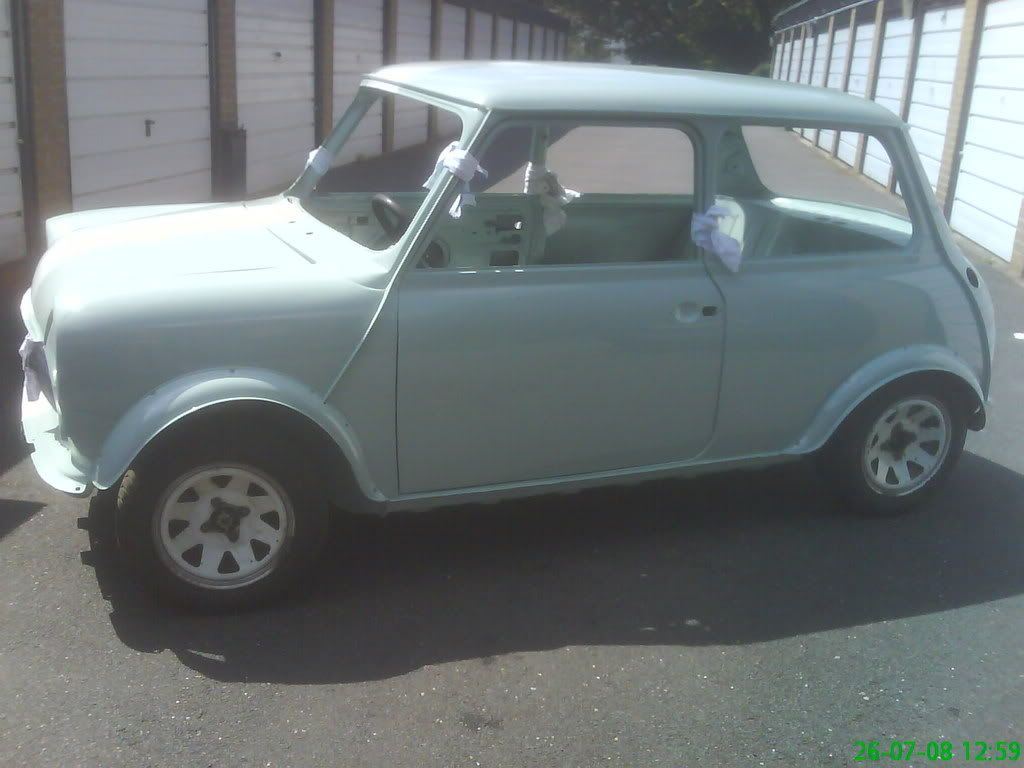

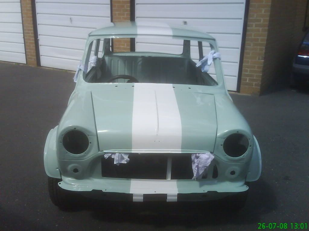

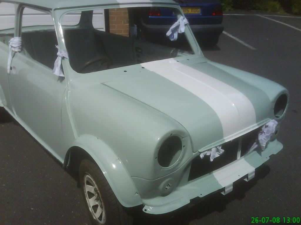

after about 8 months and some pics i cant find and a long wait for the other half to decide on a paint scheme
we got it back and it looked like this
and it went straight into a lock up i managed to get in sheffield

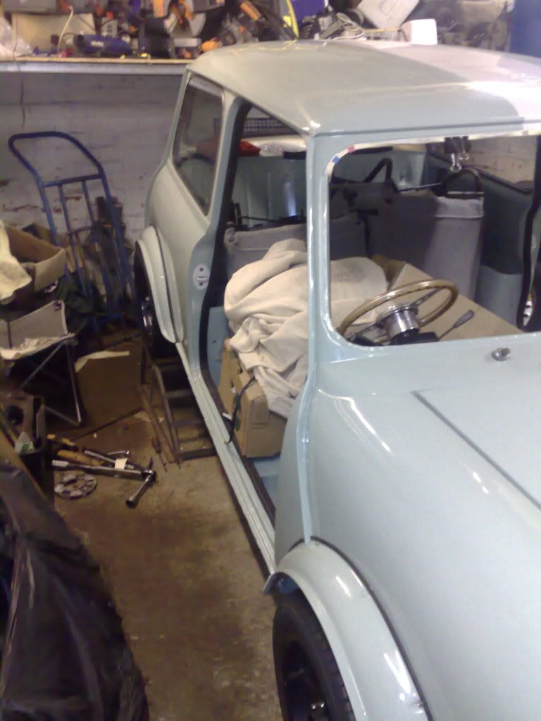

So this is how it stands at the moment:
I've still got to set up the ride height, its a bit low!!
I've still got a few more bits to do to the car itself including swaping out the petrol tank to an spi one (thanks apbellamy :) ), run new fuel lines, fit an interior!! OH and fit the doors!!

well the sheLl restoration and full respray set the project back just shy of 4k which was maybe a bit steep which is why im doing my car (The other project) myself and learning to weld (slowly).
I think it took about 100hrs work in total so i dont see it as being to much(maybe im mad?) but its what it looks like in the end that counts and for the most part were happy with it
In hind sight maybe a heritage shell would have been better/cheaper but i like the fact that a little bit of the original car is still there even if its not that much:)

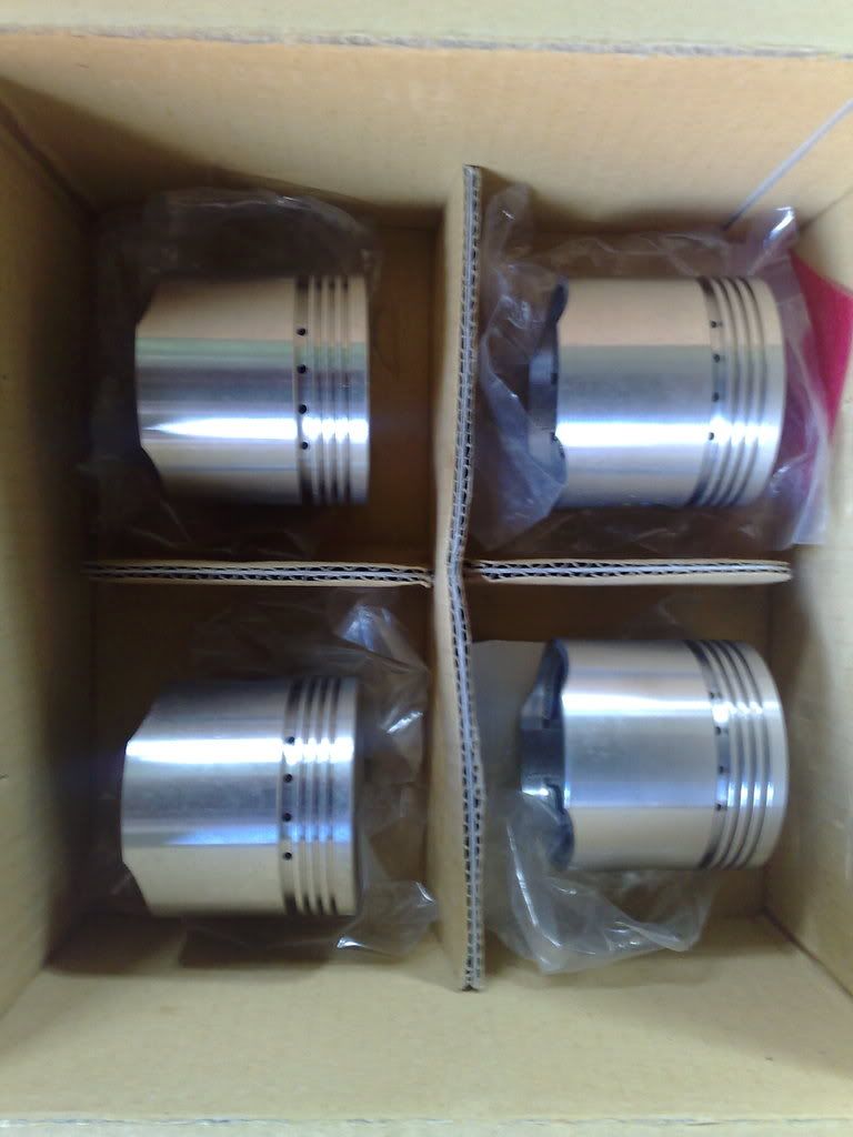

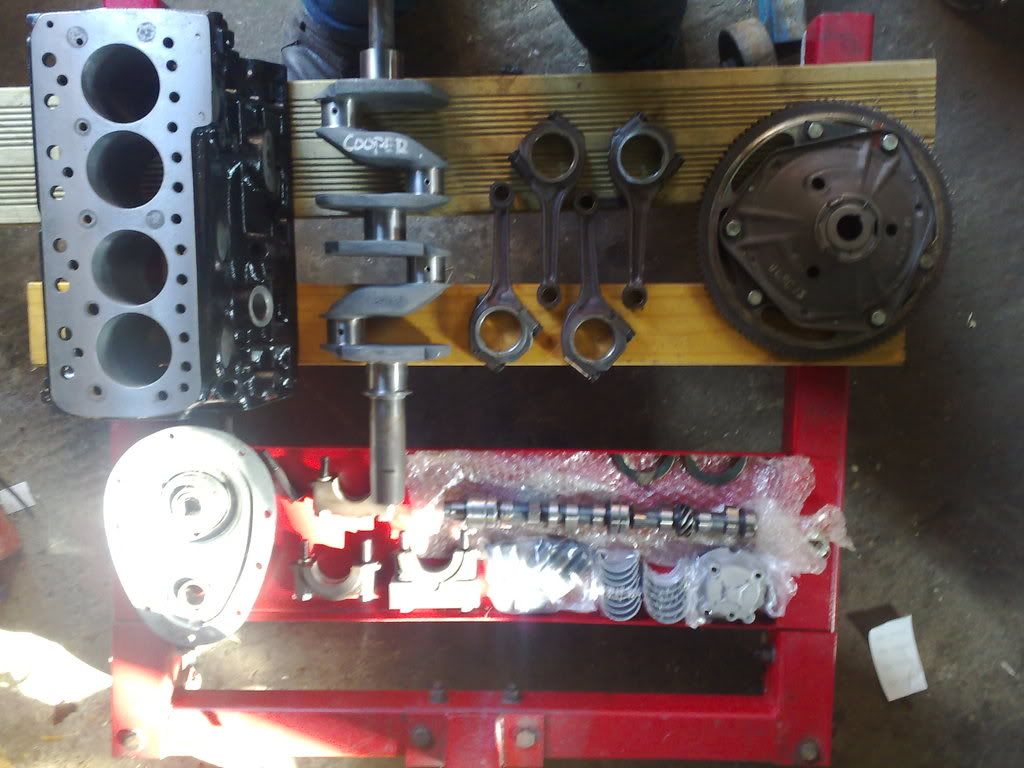

Well only a little update the piston buttons arrived the other day
(really top notch work they fitted beautifully thanks for the contact wil)
So now ive mad a start on putting the engine together will be timing the mg metro cam tomorrow 108deg is right isnt it?
I've also sorted the fuel lines now but i still need to fit the new tank.
Looks like i'll be spending my weekend in the garage again!!
few pics
Thanks for looking, Luke
What pistons are they?
Looks great. Glad Eric sorted the buttons out.
Shiney new ones.
998turbomini25
297 Posts
Member #: 2276
sheffield / derby
Indeed both shiney and new!
But to answer Vegard they are plus 40 thou hypatech pistons from australia!!
Do they have these slots?
