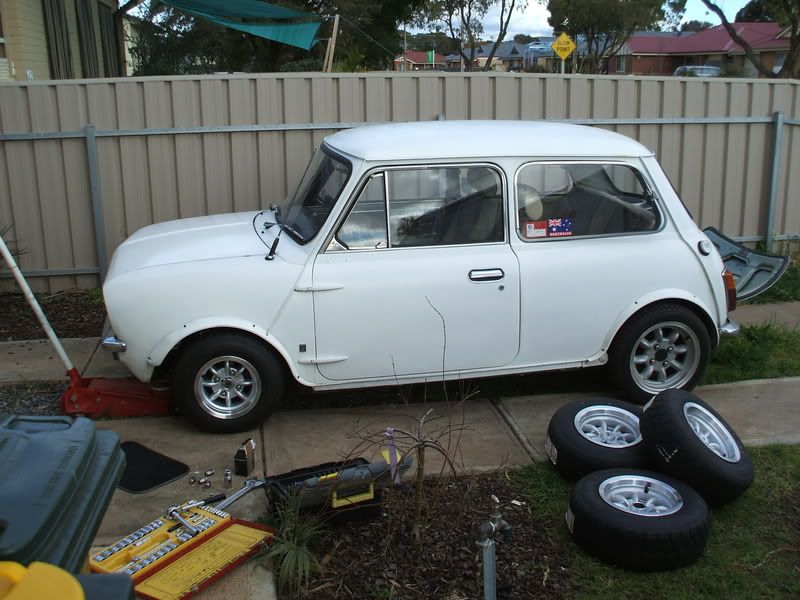

i had my mate replace 2nd gear, i had broken teeth off it snatching 2nd,
ben (maker of the kit) made me a new pulley to up my boost,
i increased the boost to 7-8 psi, then again to about 11psi where it is now.

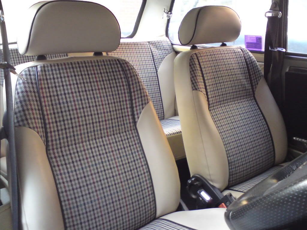

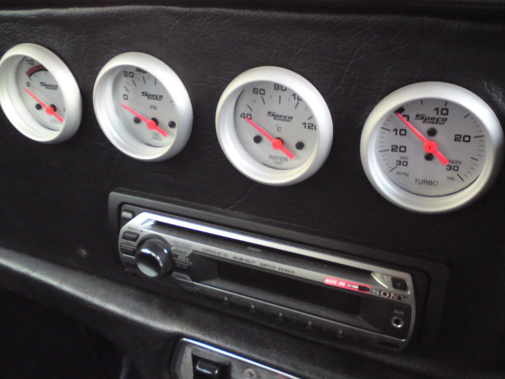

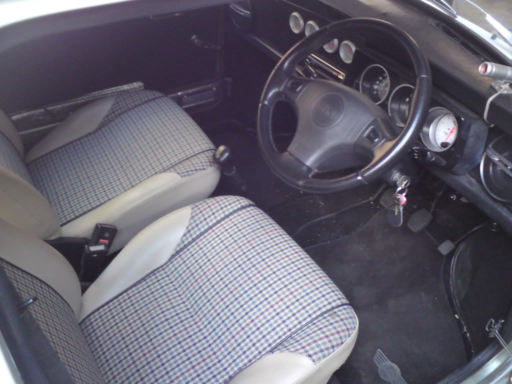

i then fitted new gauges, head unit, carpet, sound deadening and late model seats, mats and leather airbag wheel and column.
i also put 10x6 minators with dunlop formula R semi-slicks and carbon metallic brake pads
had it retuned to eliminate "turbo lag"
went to the racetrack but had numerous issues, overheating, brakes locking up, gearstick popped out and the oil pressure fitting broke.
then i took it to a local mini racer guy and fitted new rubber cones at the front and adjustable suspension arms and spax gas adjustable dampers, also
fitted a rover alternator, 1 piece rad shroud, put a mechanical fan back on, fitted a heater core aux radiator
and took it to a dyno day
at wheels figure on a 30c+ day.
seems pretty low in comparison with other minis on other dynos but it made the highest HP beating two other sc-12 boosted bigblock minis and equal to a KAD 16v EFI twincam speedwell sprint showpiece
i also beat a VW Polo GTI in a straight line drag
and i'm now pulling it out now for a repaint and a freshen up, maybe a new cam but i cant decide which one or if to stick with my re-13T
also i am considering a longer diff for cruising and a lightened flywheel.
its also high time i had a nice paintjob so i am going to send a 1964 850 shell off for rust repair and paint and transfer the engine and running gear into that and go with a retro feel.
