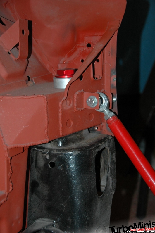

i have heard about a few people talking about modifying the tower of the subframe to lower the car by X amount and using spacers with the tower bolts. i have searched for this but have not really known what to type in to find information on it.

It was recently mentioned in Rob H's build thread and I think it was Jimster that posted pics of it previously. I'll have a search On 12th Nov, 2009 Paul S said:

Found it:

It's so easy even I can do it!

Blooming heck that subframe was heavy, if only I hadn't wrecked my last hole saw notching that blooming cage this morning. Edited by Rob H on 12th Apr, 2009. Isambard Kingdom Brunel said:

does this only really work with a flip front as i have a full steel front welded on ect im geussing it wont lign up very well afterwords. it seems so so simple, what about the vibration from the subframe strait to the shell does this cause any long term problems as i plan to use my car as a road and track car but want it nice and low :)

Whats the story with the rear subframe mounts? Did you remake these or just move the holes to get everything to line up? I was also thinking about doing this. What does everybody do with the rear brake hose (on the back subframe now) I was just going to move it under the arm to prevent it getting nipped. is that the norm |

i can't understsnd why in those links above folk have removed the locating lip for the rubber/poly/alu spacer,its not just a spacer it locates the tower to into the crossmsmber without the lip and somekind of locating ring the frame is putting a shear moment into the bolts

i can't understsnd why in those links above folk have removed the locating lip for the rubber/poly/alu spacer,its not just a spacer it locates the tower to into the crossmsmber without the lip and somekind of locating ring the frame is putting a shear moment into the bolts I hear you, and I've been thinking about making some alloy locating rings for that very reason. Isambard Kingdom Brunel said:

i can't understsnd why in those links above folk have removed the locating lip for the rubber/poly/alu spacer,its not just a spacer it locates the tower to into the crossmsmber without the lip and somekind of locating ring the frame is putting a shear moment into the bolts Carl, I see your point, but the OD of the ring on the subframe is much smaller than the ID of the ring on the cross member so without a spacer it's useless. And you of all people know that weight is evil. On 15th May, 2009 TurboDave said:

What you will find running that low, even if you move the subframe is that your spring rate is reduced as the top arm is at such an angle.

You boys want to be careful as there is a point at which the balljoint will snap without warning if too low! You can modify the balljoints to stop this mind! On 5th Sep, 2011 Vegard said:

Good point Scruffy, I checked that mine didn't bind at full compression. Fastest 998 mini in the world? 13.05 1/4 mile 106mph

Jim are you telling me you have no possitive method of location other than the bolts pulling up, carl On 13th Apr, 2009 fastcarl said:
i can't understsnd why in those links above folk have removed the locating lip for the rubber/poly/alu spacer,its not just a spacer it locates the tower to into the crossmsmber without the lip and somekind of locating ring the frame is putting a shear moment into the bolts Carl, I see your point, but the OD of the ring on the subframe is much smaller than the ID of the ring on the cross member so without a spacer it's useless. And you of all people know that weight is evil. JI m , are you telling me you have no possitive |

You boys want to be careful as there is a point at which the balljoint will snap without warning if too low! You can modify the balljoints to stop this mind! Just out of interest - by doing what? Paul I seriously doubt it! |

grinding a bit out of the 'cap' i presume |
