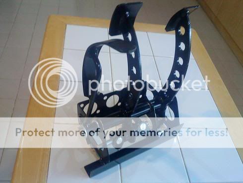

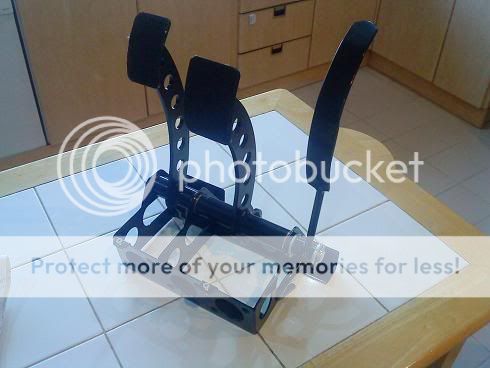

Got my pedals... Look ok
Will take a bit of fabrication to make them fit.

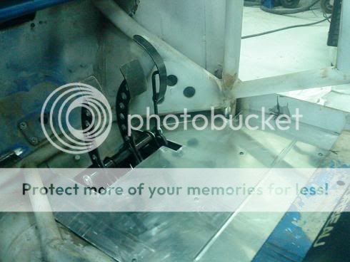

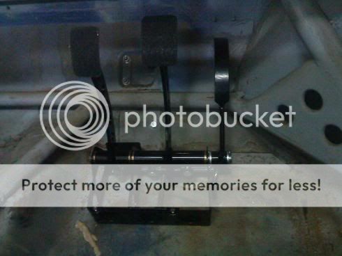

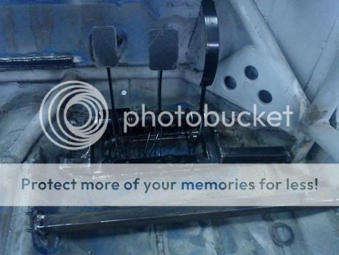

Pics of the pedal box mounted
Edited by Tareq on 8th May, 2009.

what pedal box is that Tareq?

Its the floor mounted with reverse master cylinders from Optimum Balance Products..
http://www2.obp.uk.net/catalog/product_inf...4cc71339db32d67
Its about 160 pounds without the m/c I will use AP racing ones.
Looks well made for the price
