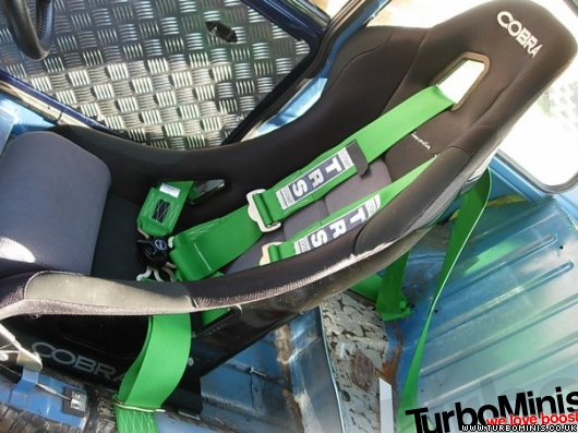

has anyone got any pictures of some bucket seats with side mountings instead of a subframe in a mini? or could anyone tell me how they mounted theres? i have some OMP seats which i would like to know how to mount them as they only have the holes in the sides of the seats
I'm planning on using a pair of brackets bolted to the floor, with a couple of load spreading plates.

Here's mine, just drilled the floorpan and bolted the sidemounts down where I wanted them. Used 50x50sq spreader plates for each bolt:
