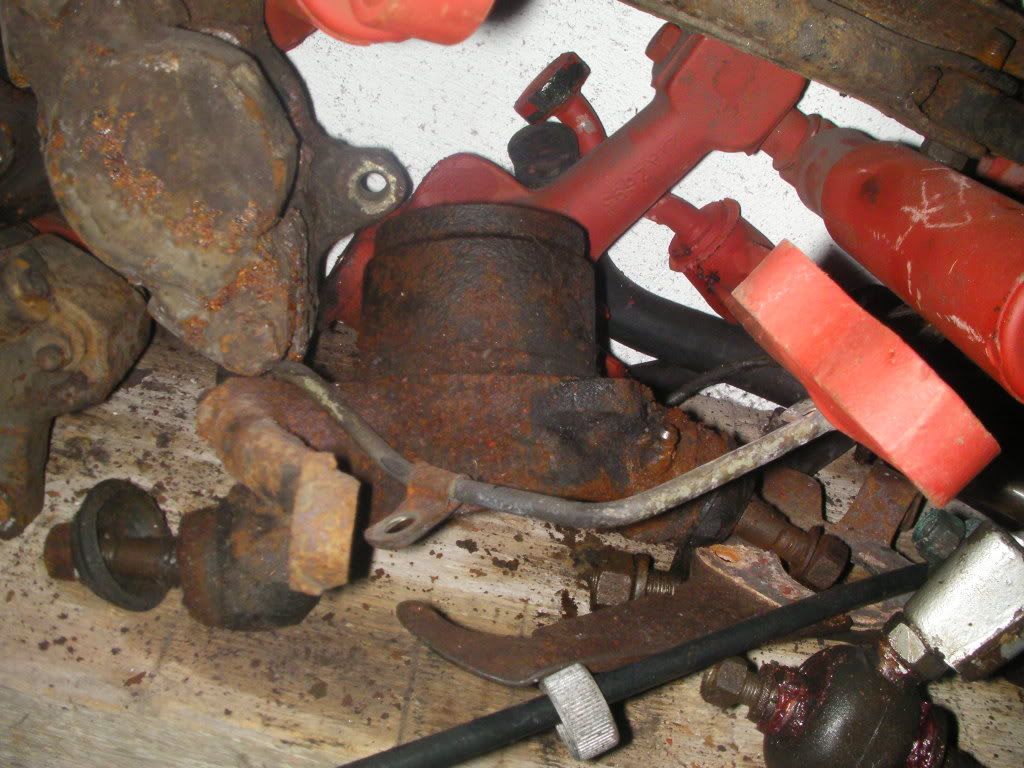

so here are the offending hubs before (been sat on the shelf for probably 6 or 7 years gathering dust/rust):

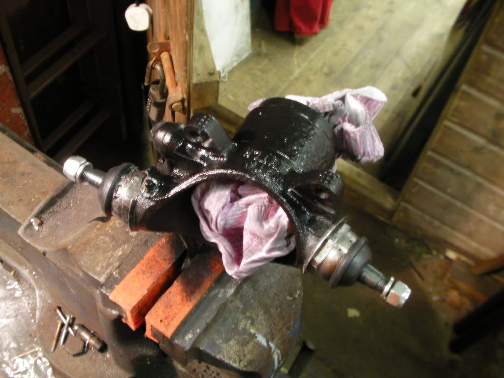

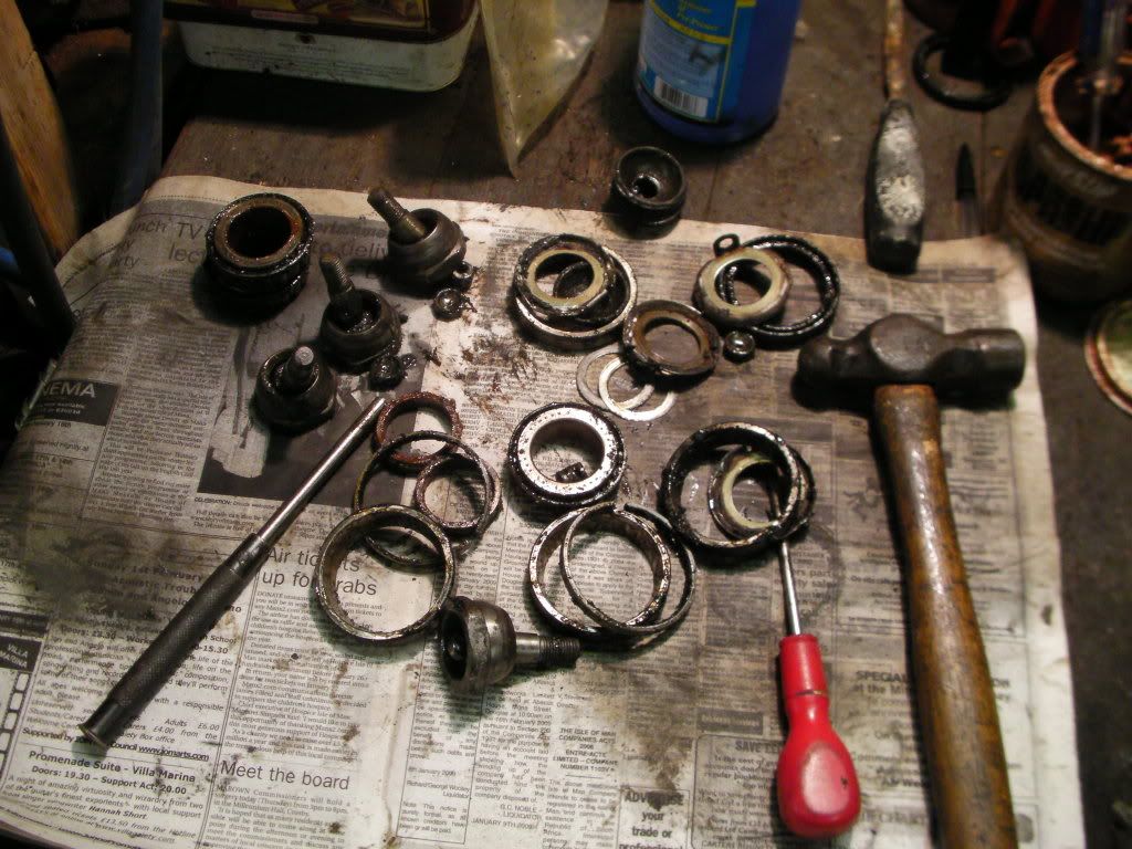

gave them a good shot blasting (f'fing love my blasting cabinet!), disa sembled, then a good rinse in the parts washer, came up like new!:

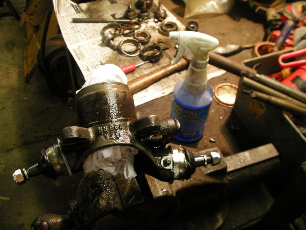

whacked on the new bj's, pattern parts unfortunately as no where seems to have genuine in stock :) :
gave them all the grinding paste/drill trick and you could feel the difference after, there were huge high spots out of the box.
evetually after pissing about with hundreds of shims i managed to get all of them nice and stiff (!)
a quick squirt with metal ready and a lick of por later and hey presto, new hubs!:

Whats the grinding paste trick then? Doing mine soon.

You put grinding paste in the ball joints and spin them with the drill (then remove the grinding paste!). Like Joey said it removes any high spots within joint and gives a smoother running balljoint ball ball joint, joint ball.
