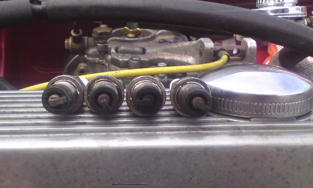

I did a compression test, just for interest, and it got 162-170-180-175 from 1-4 respectively.
Running ever so slightly lean on #4 I'd say, and generally a tad richer on 1&2 compared to 3&4, with the outers being more lean than inners as you would expect.
