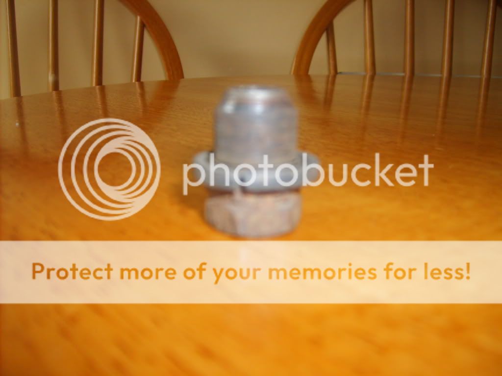

Sorry for the poor pictures.
But is this wheel nut the type as used on the mini special (exacton) wheels?
Cheers, Oli.
Asphalt
509 Posts
Member #: 1027
Germini, black forrest
No! The 'Special' wheel nut looks like this:
Click me
What you have looks like a Rover 12" steel wheel nut
(long type w/ plastic washer for hubcap fitment)

Oli
1733 Posts
Member #: 1910
Wilts
i thought that could be the case.
Never mind lol.
