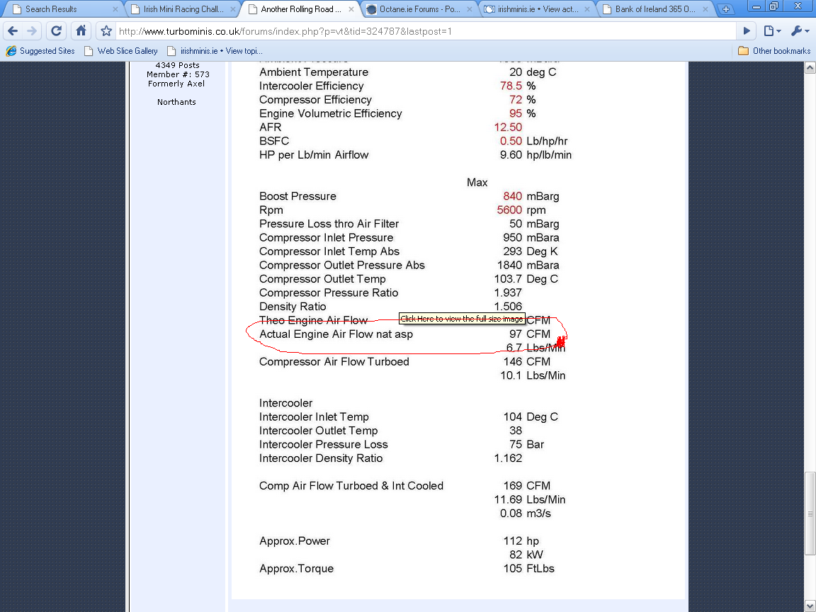

Here is the MV log:
Inner cylinders ar AFR1, outers AFR2.
Lean on the outers, mainly due to trying to run a 9mSec pulse width at 6000 rpm.
And these are the calcs that back it all up:
PaulH

where did that nat asp figure come from Paul
Edited by PaulH on 6th Nov, 2009.
On 17th Feb, 2009 Rob H said:
That's calculated from the engine capacity and VE.
