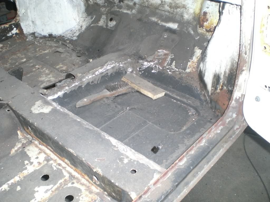

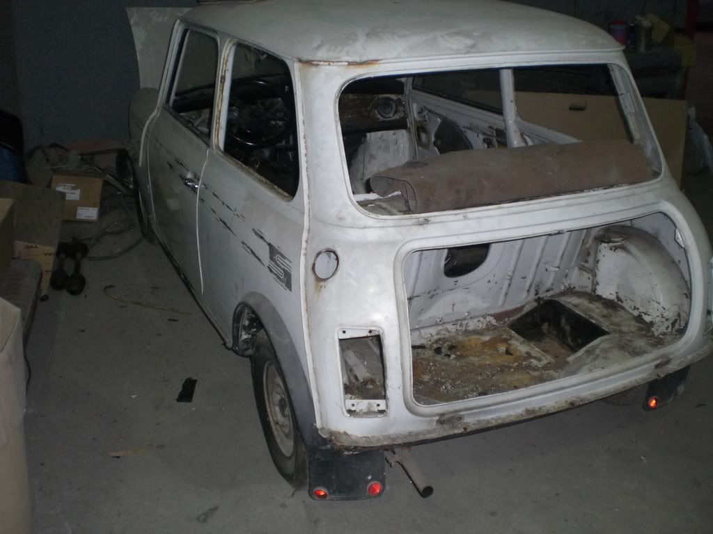

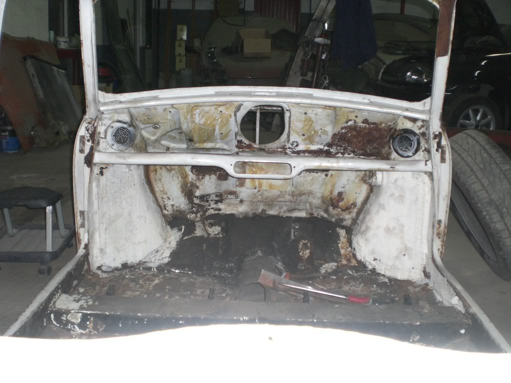

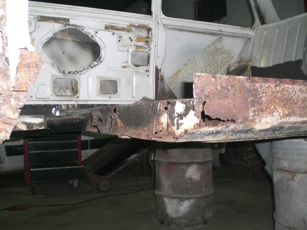

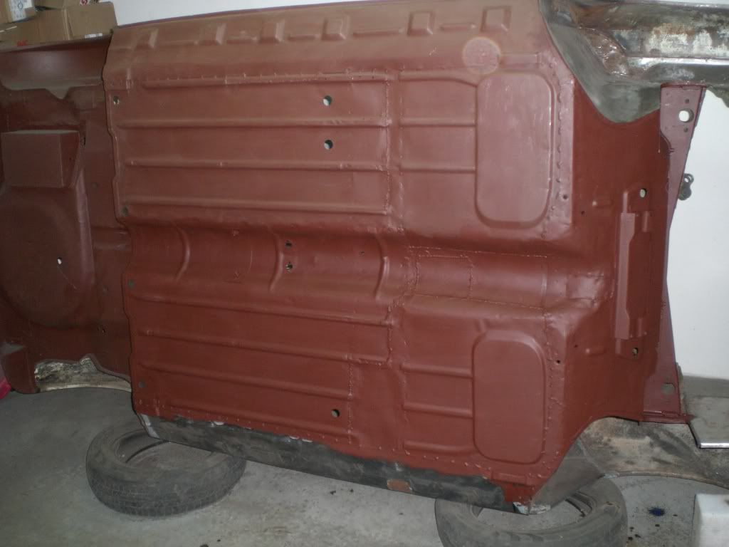

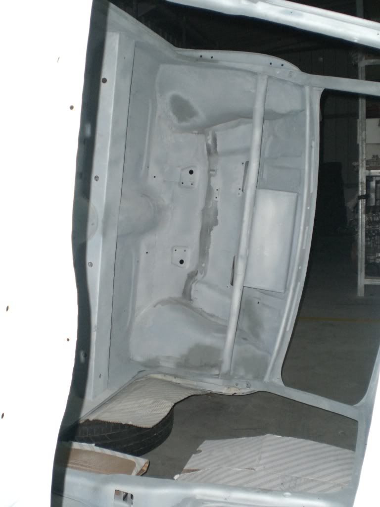

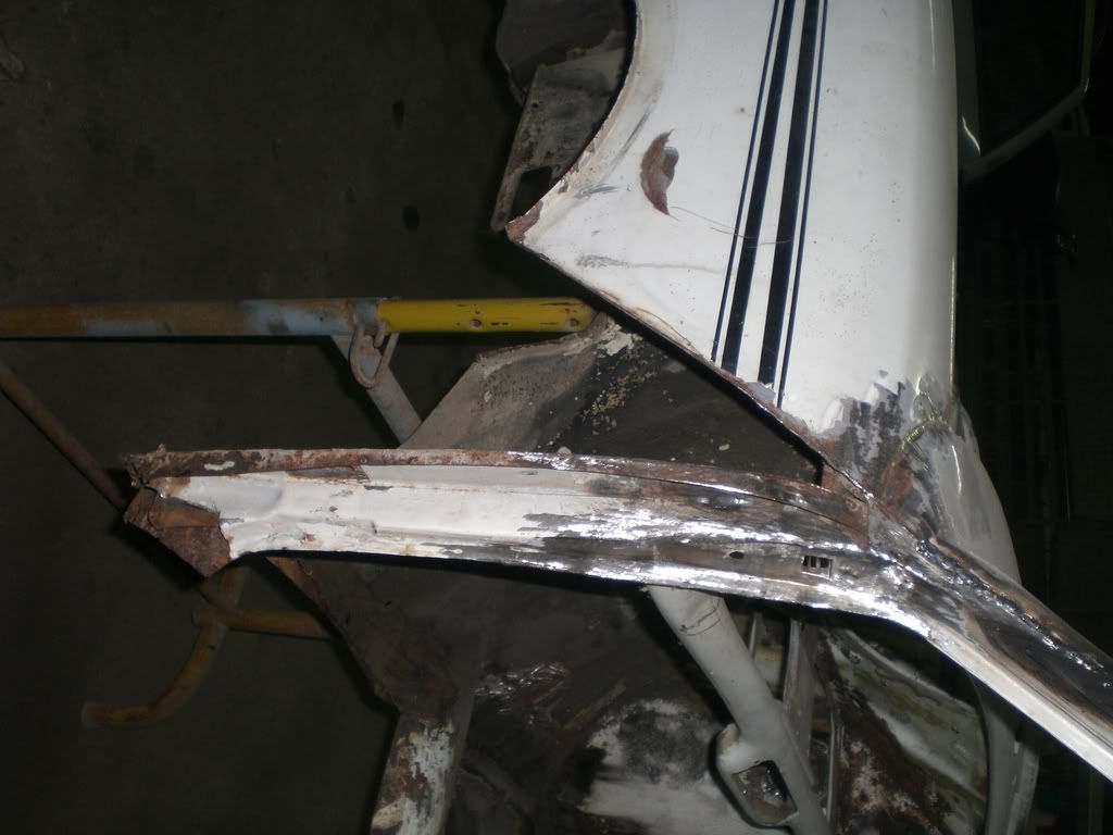

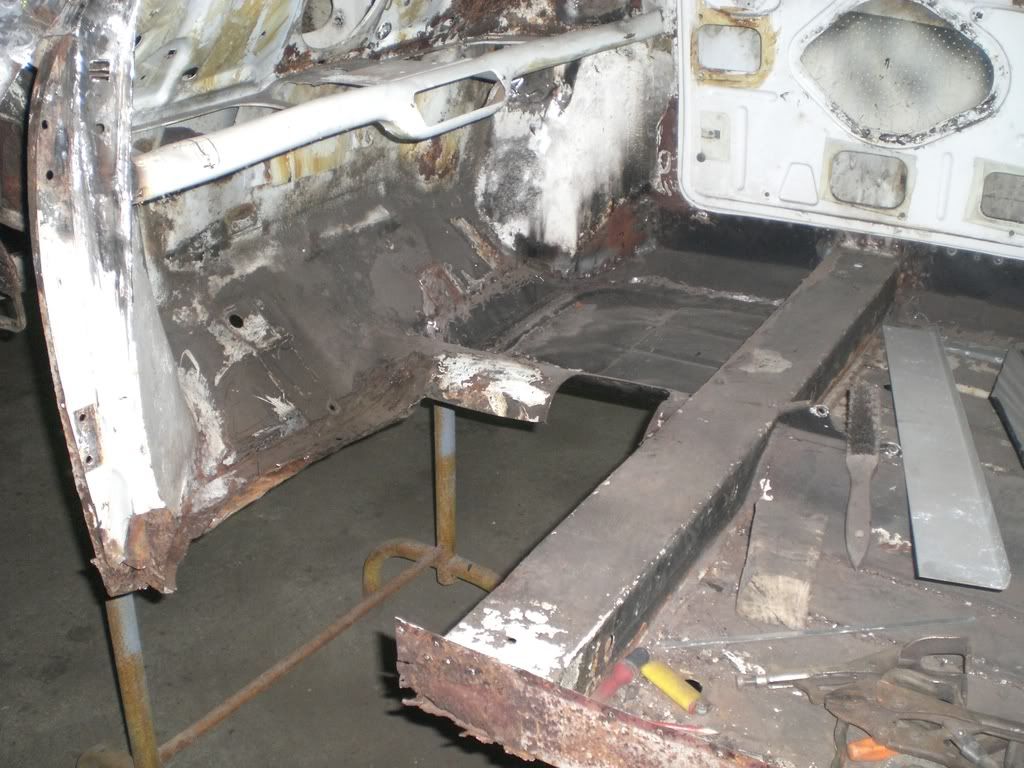

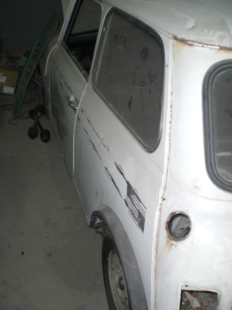

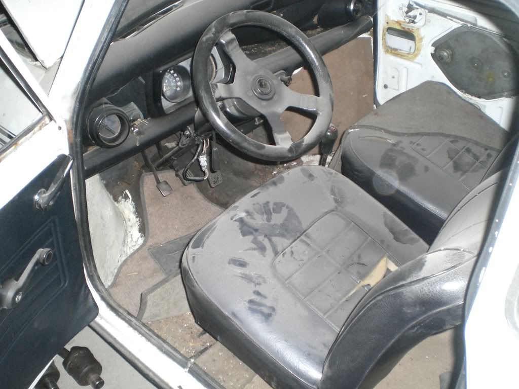

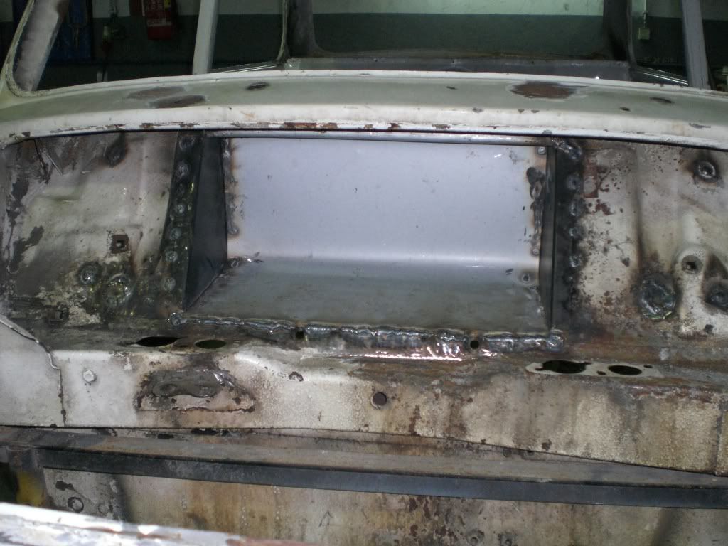

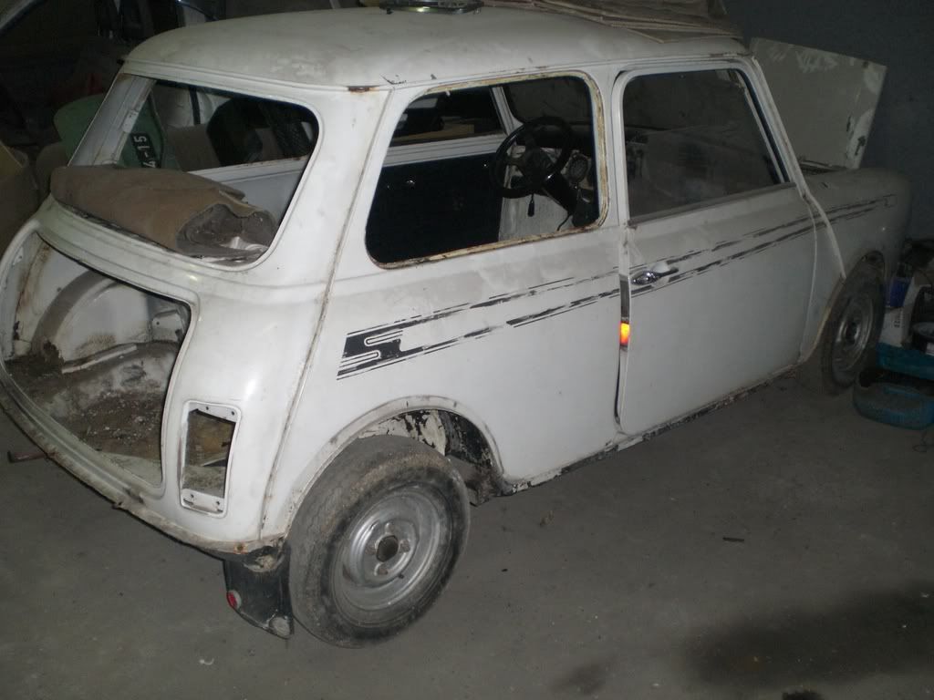

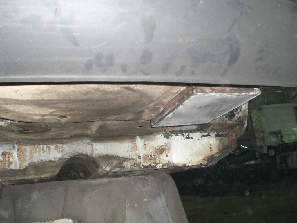

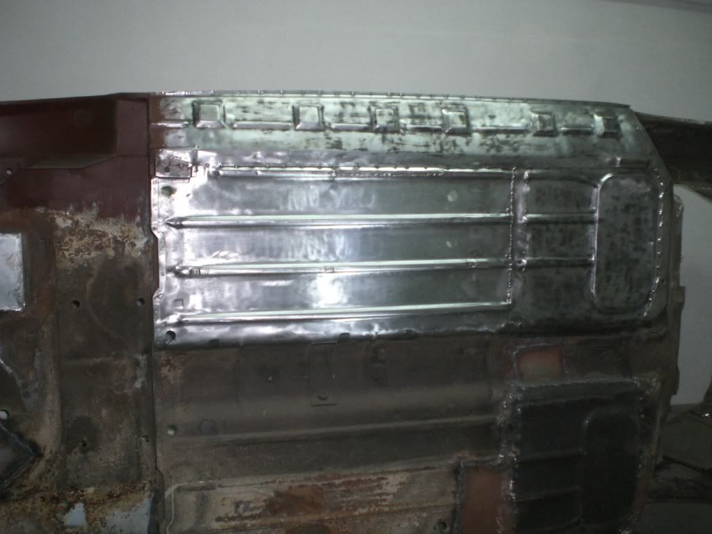

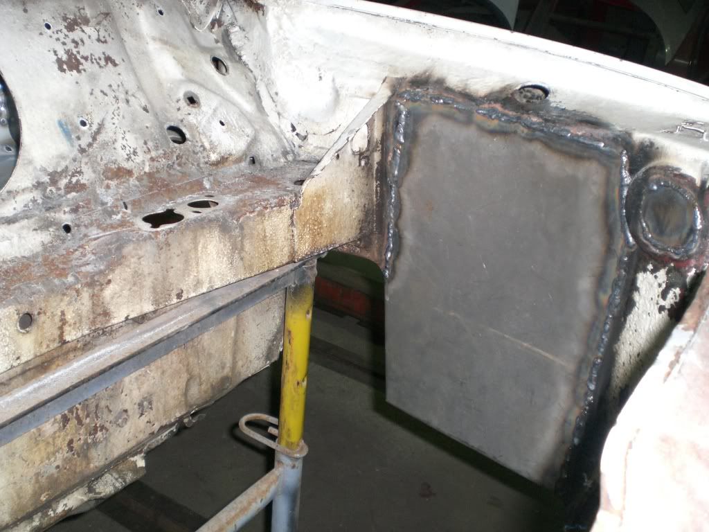

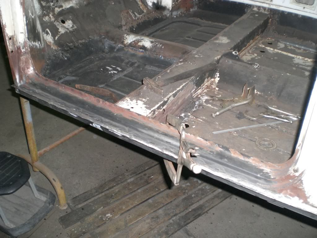

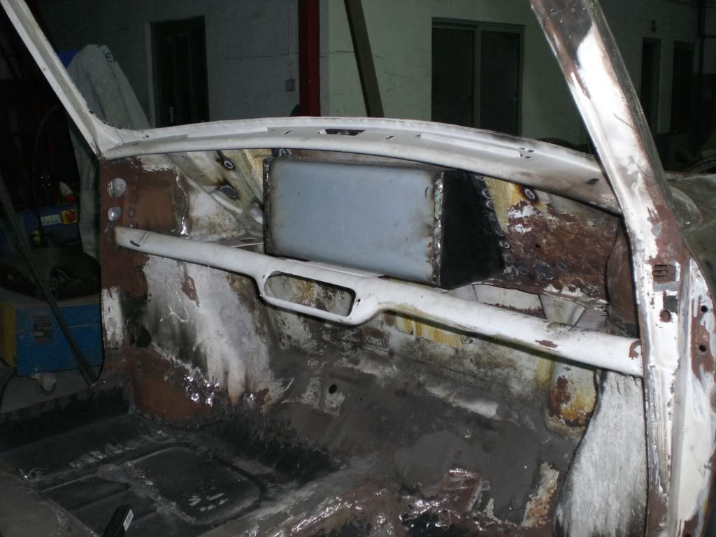

I have started this project in Setember 2008 when i found this nice cheap Clubman . It has missing some parts , some ( alot of ) rust in other parts .....
So i started to "brake it" apart :) and replacing rusty parts ....

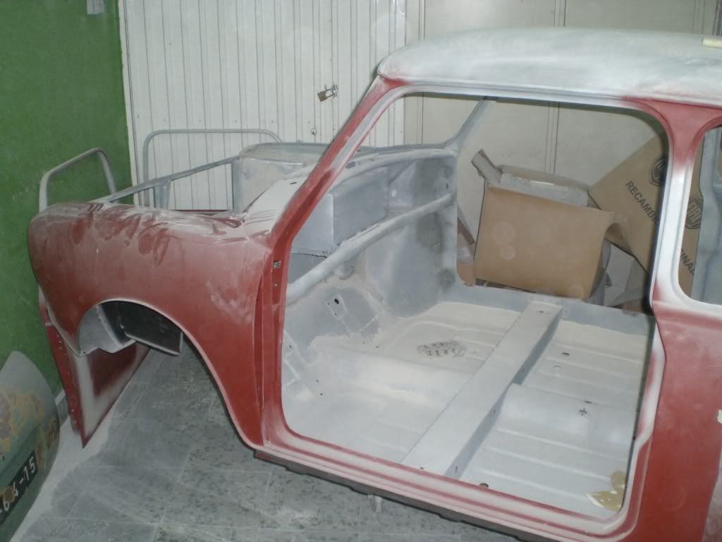

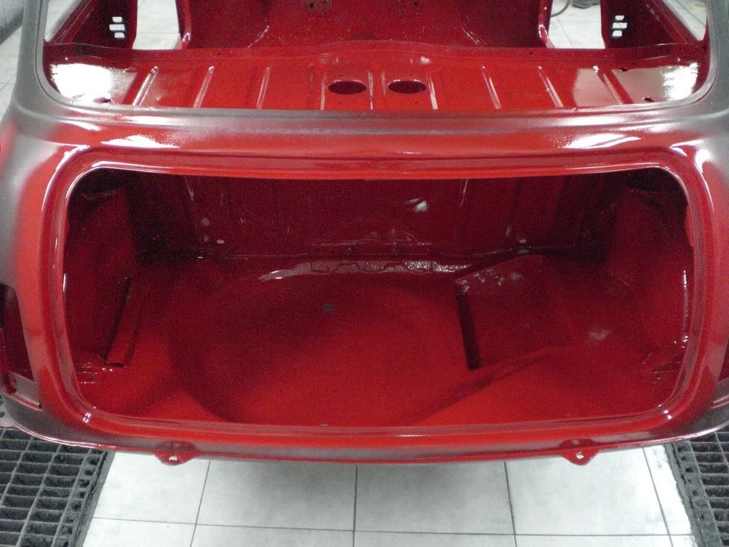

Several months later it's passed from metal section to the paint sction.
I hope it will painted until the end of January 2010....

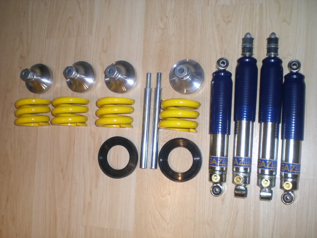

I also have been colecting several pieces for my Clubman, here are some Photos :)

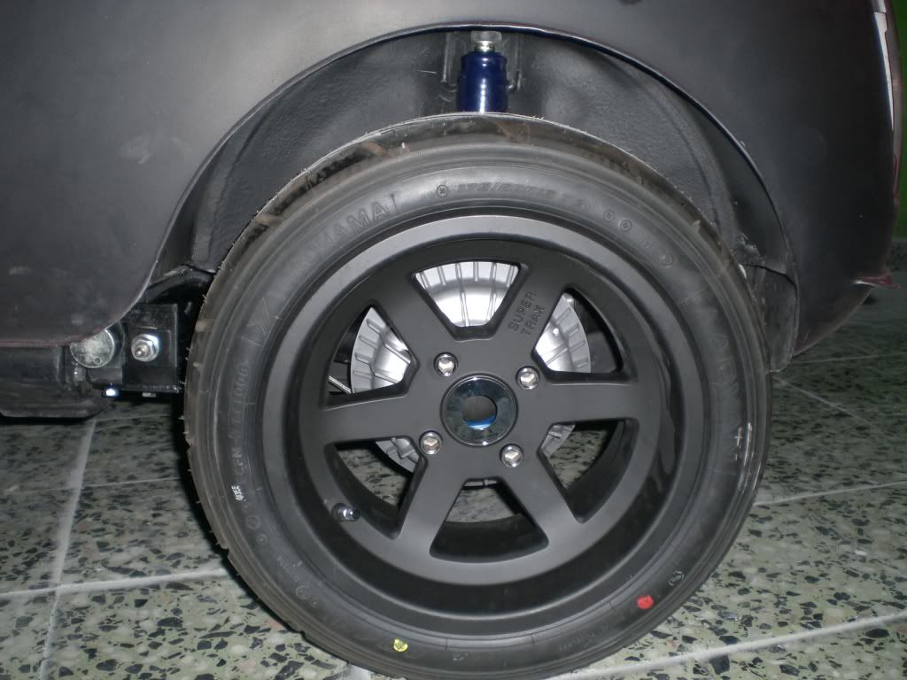

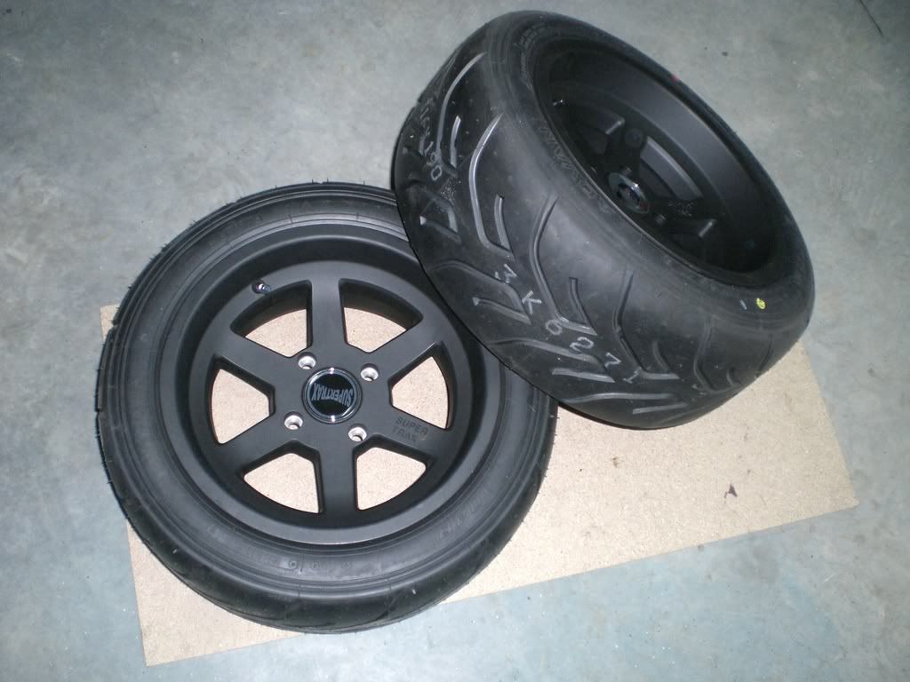

13"x7" Supertrax + Yokohama A048 175/50R13

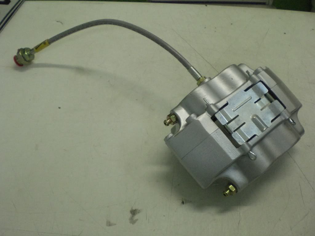

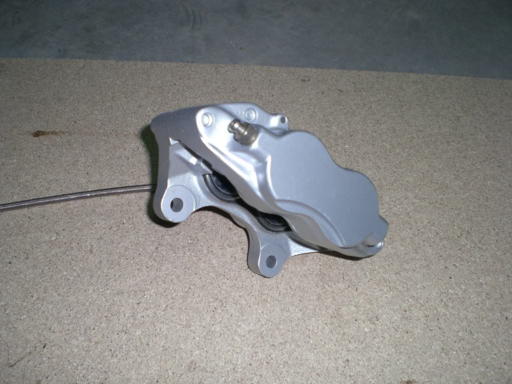

Minispares alloy brake calipers for Solid discs ( i bought then used , so i had to "put" then like new )
Carbon Group A side view mirrors
And Some more parts that are ready to fit , has soon the car is painted.

looking good. there the wheels i wanted for my clubman but i forgot all about them and orered mini lights lol

I liked those wheels. Very very nice. Except i hear they weigh about 12 kilos each.

To be exact 11kg each with tires .... without tires about 6 kg each
Mini Clubman 1971
Really?? Some room for improvement there then.....

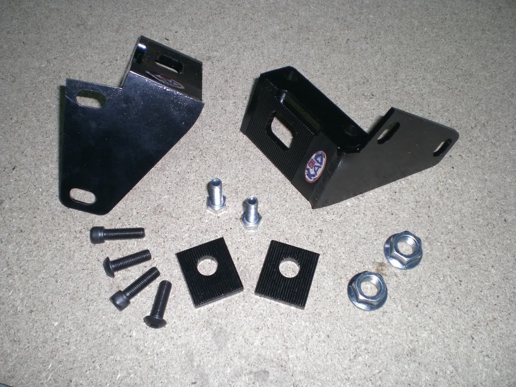

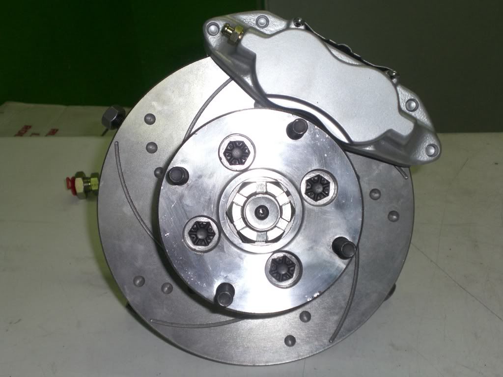

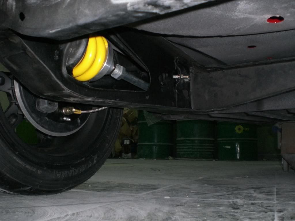

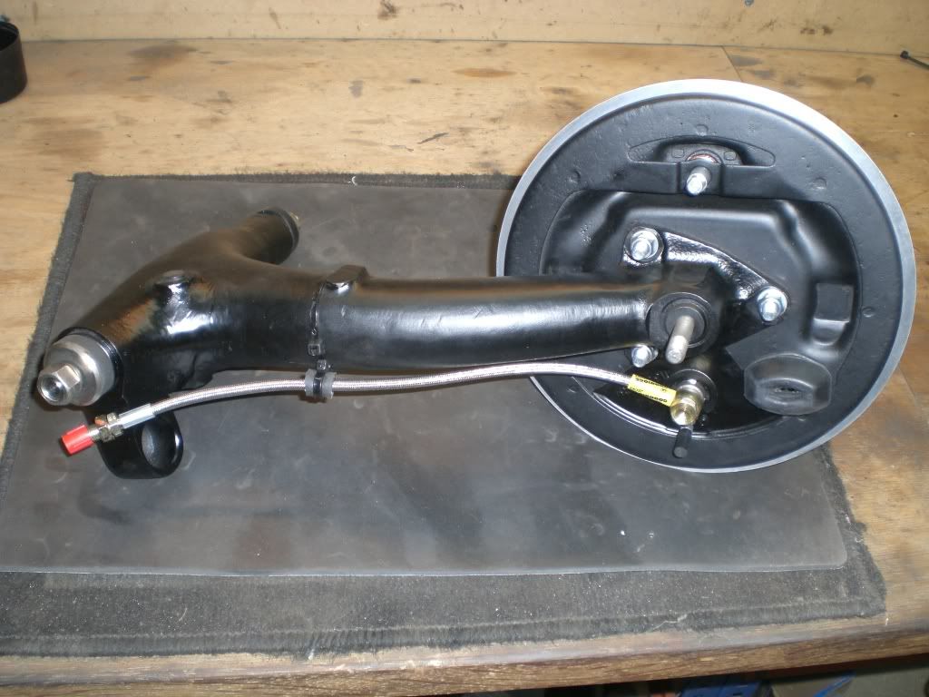

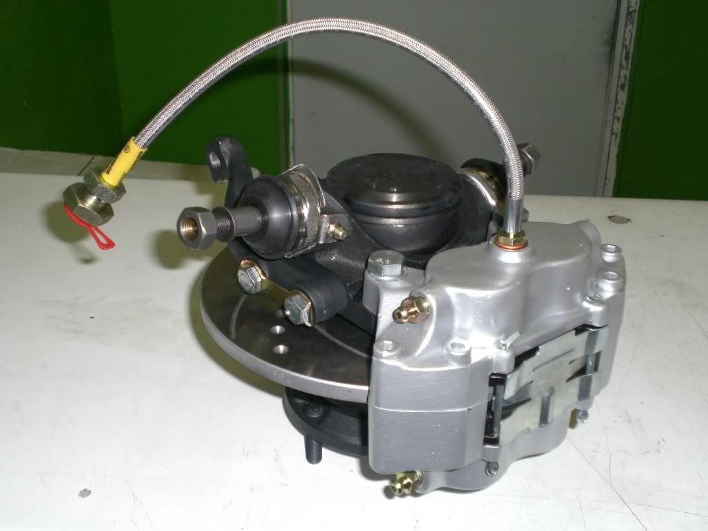

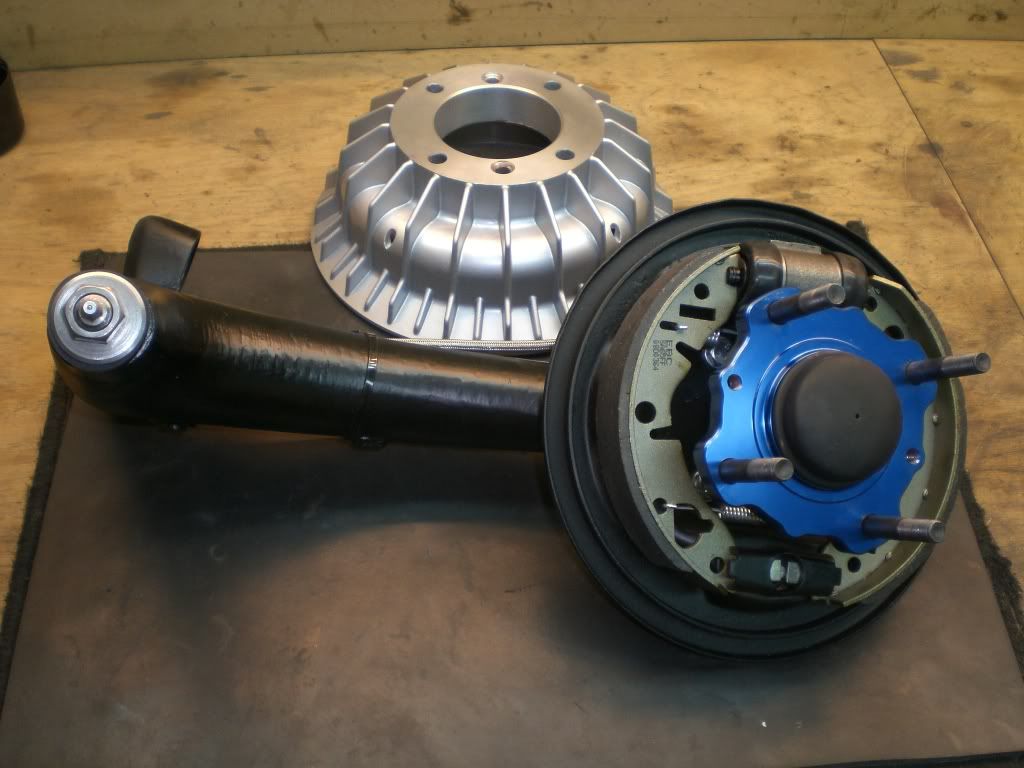

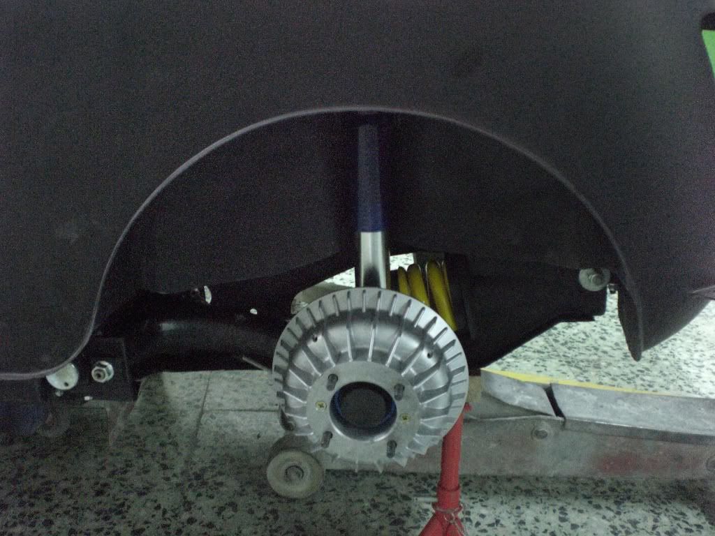

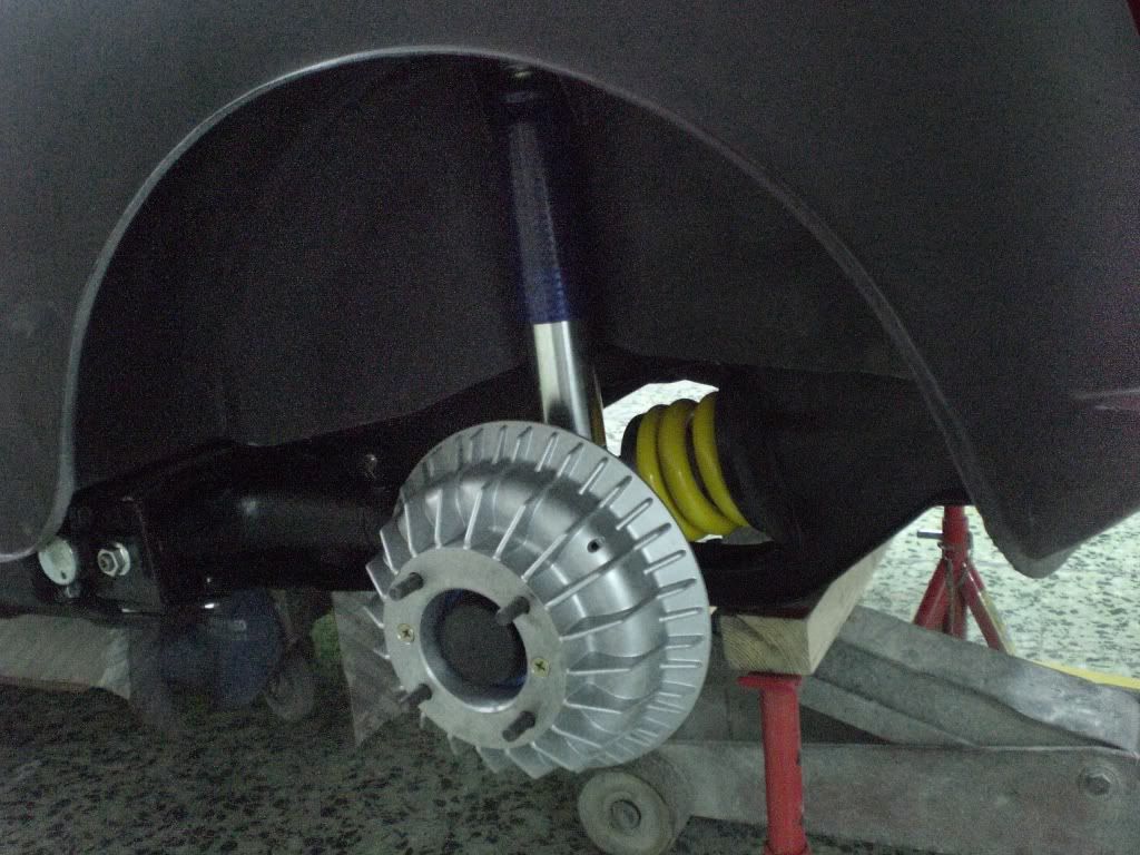

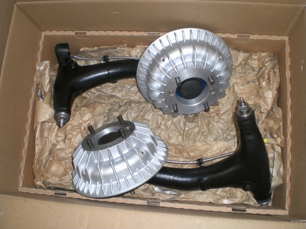

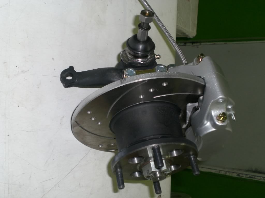

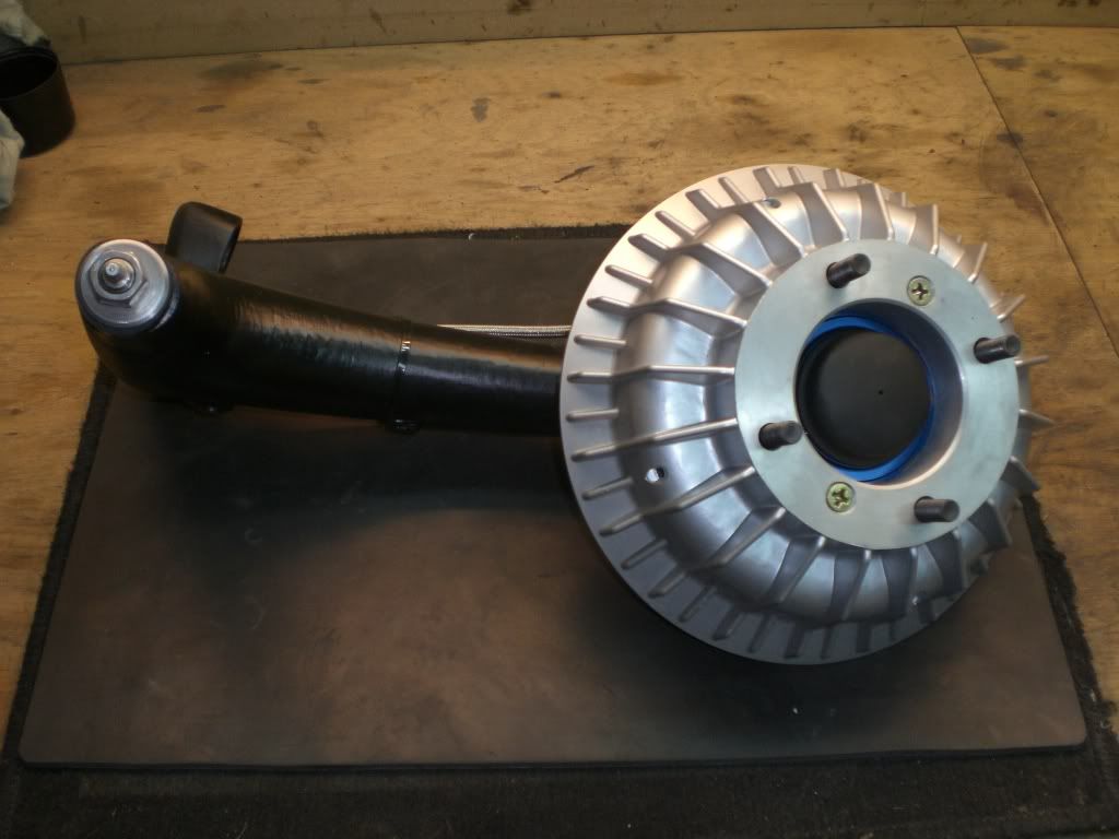

New year update :)

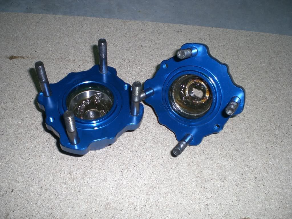

Front hubs and brakes ready to fit . New grooved discs and mintex 1144 pads.
:) From the regular metro vented brake setup , this setup has 2.4kg less weigth from each hub . From the rear arms i also managed to remove 1.7 kg from each arm . :)

nice parts, and I am sure the car will turn out great, but as expected from me I will warn you that your car will turn into rust faster than it could have done.
The reason being the oversills, there are no vents in them making them collect moisture, and that will lead to your floors and sills rotting out very fast. You should atleast drill some holes in the vents, to let the moisture out. But why fit them in the first place? Do you have something to hide under them? :)

Hi miniminor63 , thanks for the advice , can you show me a photo where do i have to make the holes? In the inner oversill? thanks

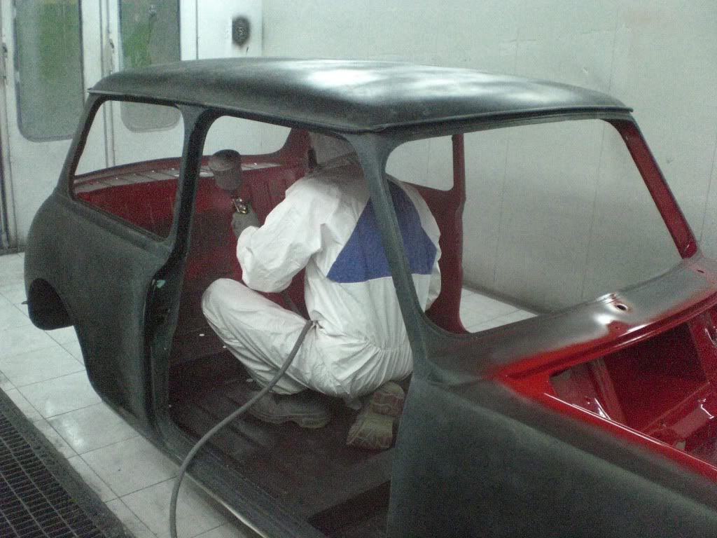

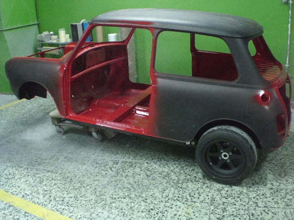

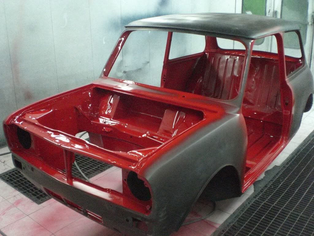

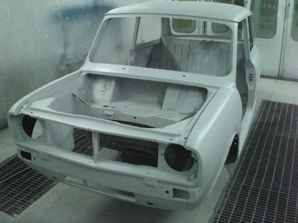

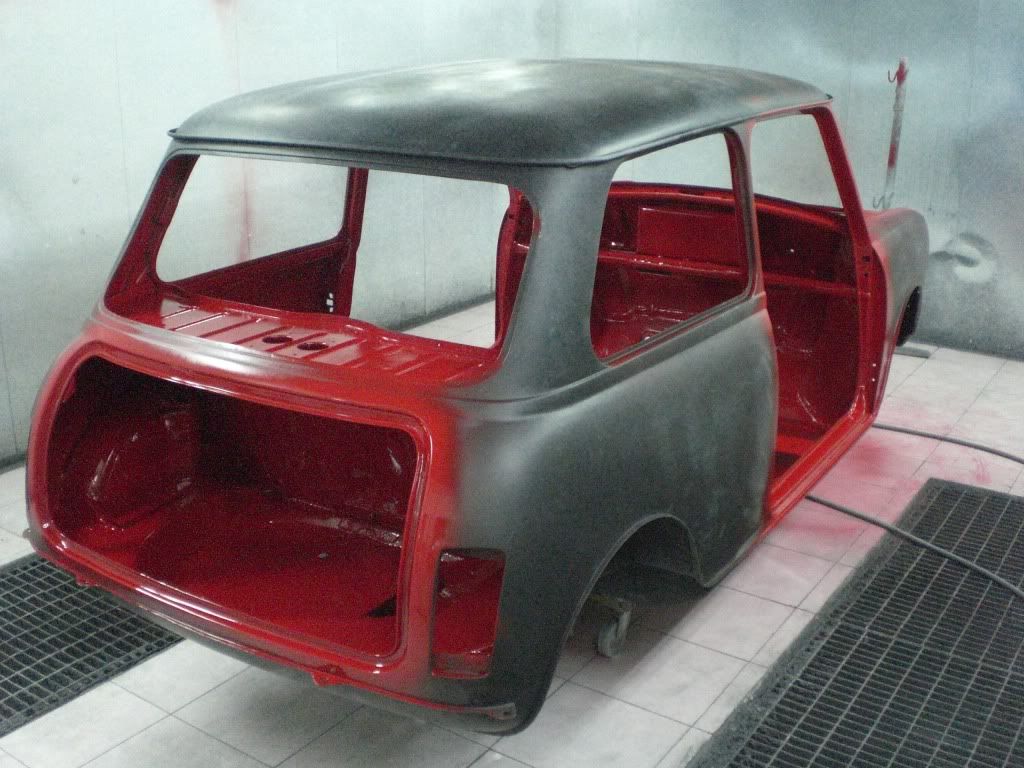

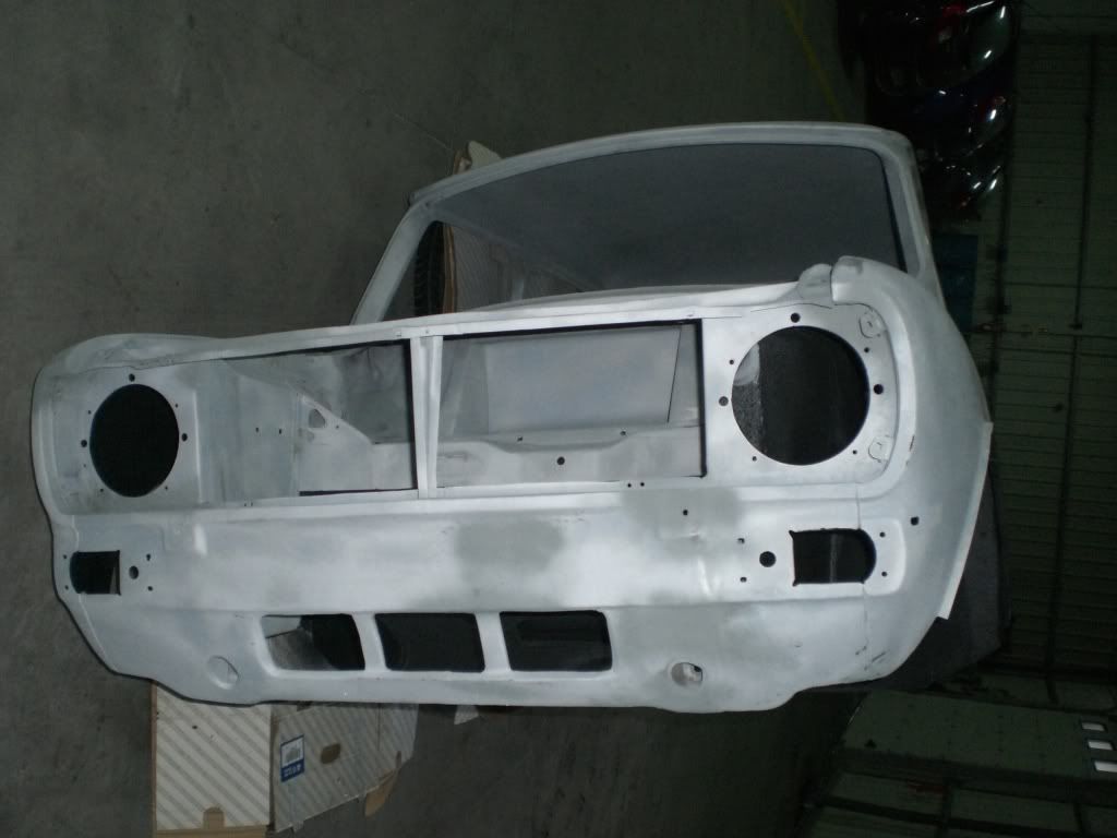

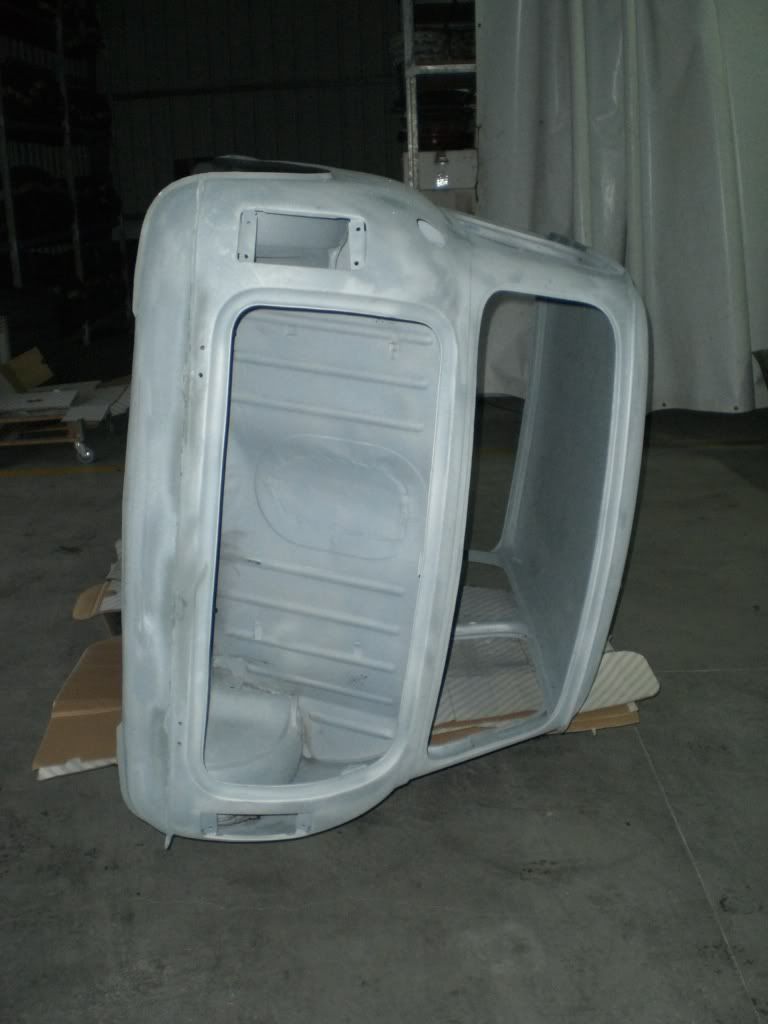

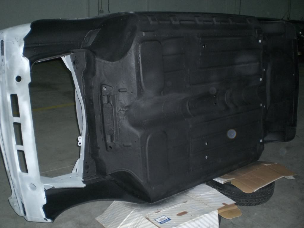

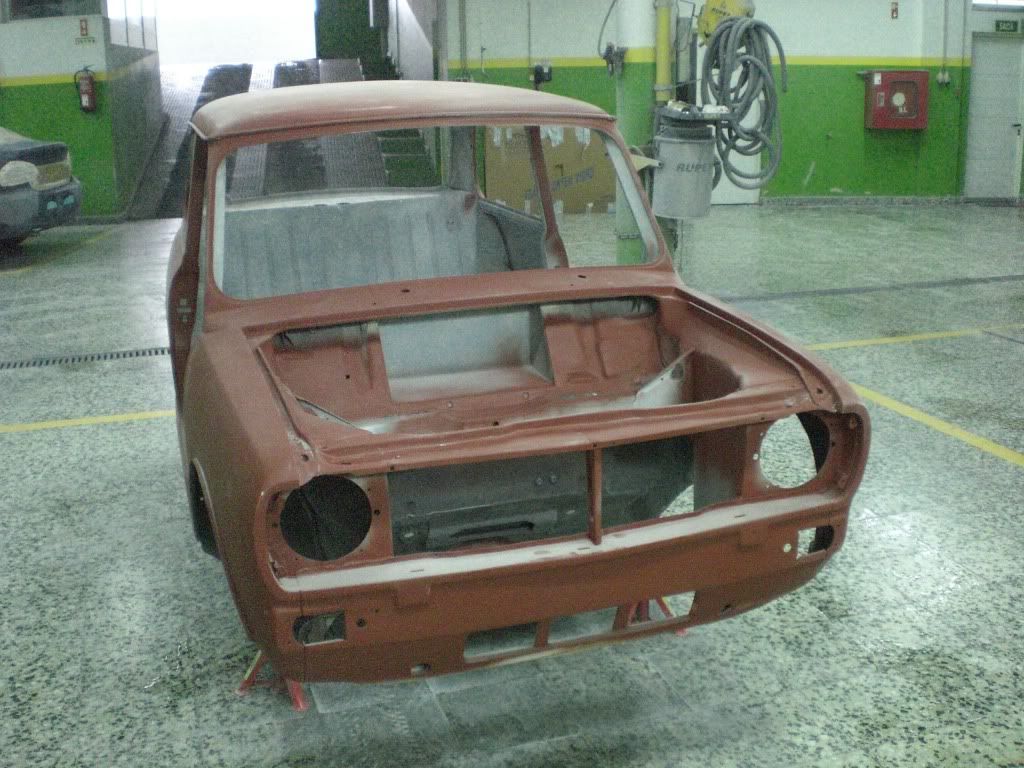

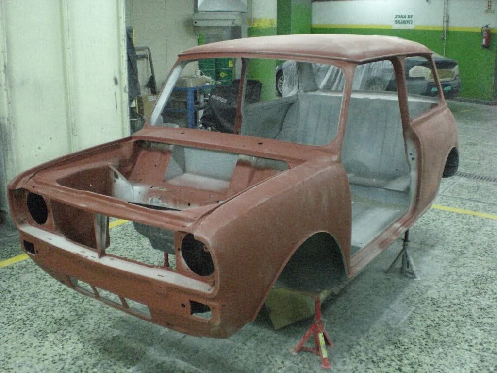

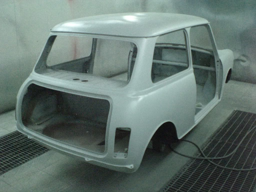

One more Update .....
Just have to pick the final colour!!! heheheh
Mini Clubman 1971

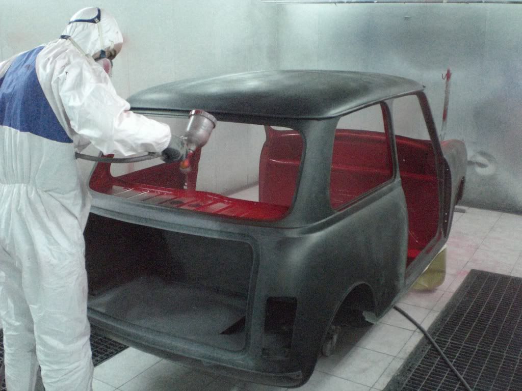

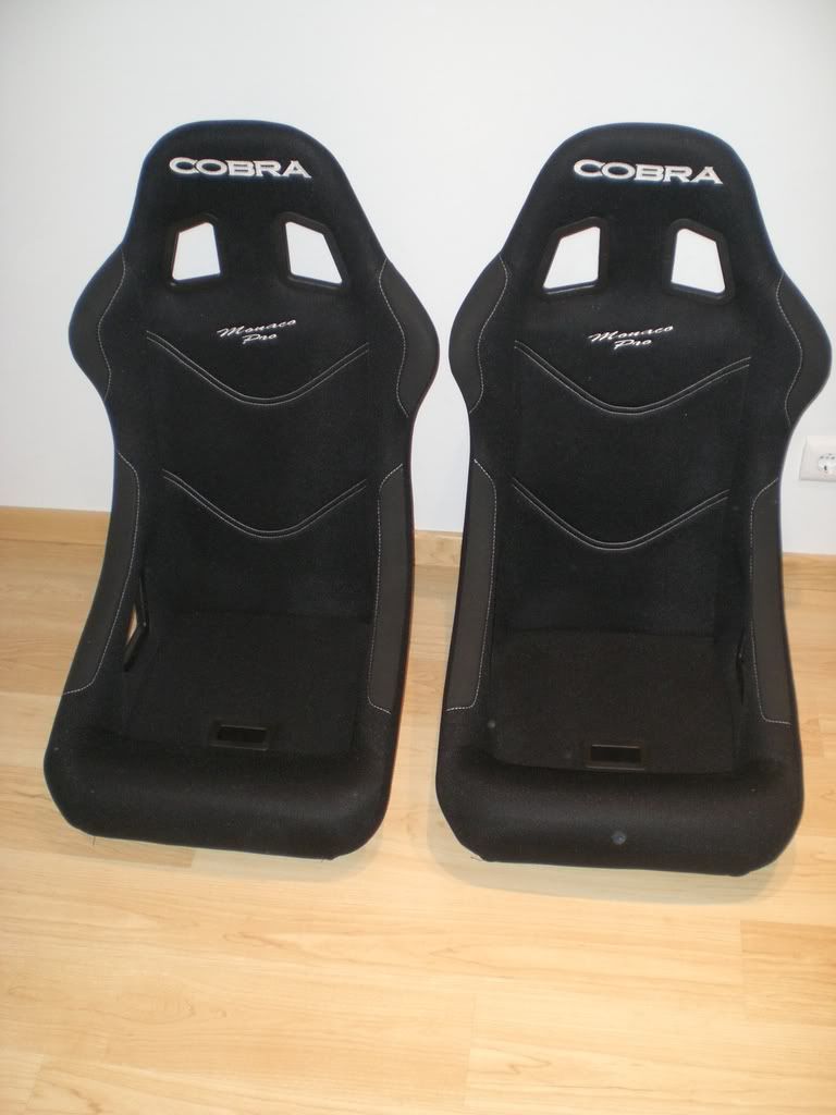

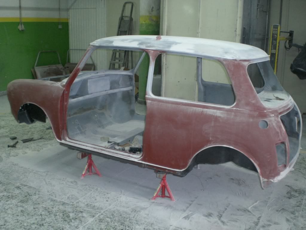

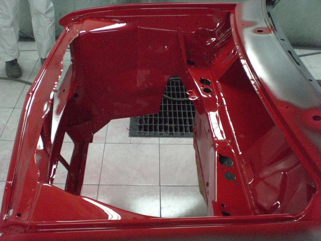

Update :
*smiley*
