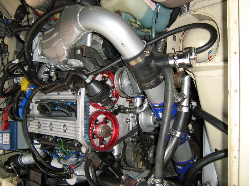

Hi All,
Here's my 1300 Allegro series 3 with the K100 twincam supercharged A series (A+) engine. The picture was taken when the car was parked @ the rear of the flats where I live. I've now had it towed to an industrial unit near my flat so will be able to put in some serious time sorting it regardless of the (rainy) weather! & at night too!

Yes I have a dump valve fitted now which seems to work sometimes but when it does'nt it blows the hoses off etc, I've tried adjusting it but the results are spurrios, ie sometimes it dumps sometimes it don't.
I've been told that a turbo dump valve doesn't act quickly enough for a supercharger, mmmaybe an old wives tale?

yes, I think suck thru is the way to go for simplicity, That's how the Bini is set up. It has a 'fly by wire' setup using a potentiometer to give throttle control so I ordered a 52mm Mpi throttle body so I can attach a throttle cable.
Someone suggested a throttle before & after the supercharger, any thoughts on that?
I'm willing to try anything if it works, I mean my minds not set on doing anything in a particular way so long as it works. *smiley*

thats cool,
but 7 joiners inone straight length?
change that asap for a single length.

I love the idea. I was planning on a k1100 motor in a metro until i found the turbo and sold the engine.
However being the stickler for detail i'd have to get rid of those joiner pieces and sand bend a nice gentle radiused piece of alu pipe. But thats because i work on expensive racing cars where only the best will do.

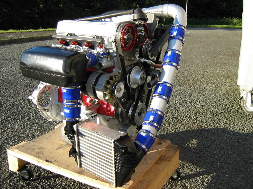

I thought all the joiners made it look a bit technical *happy*
I used all those joiners to mock it up, having never done anything like this before I had to make it up as I went along, I thought the joiners would enable me to create a gradual sweep to connect to the intercooler which I didn't know where it was goin to be able to fit into the engine bay, if you catch my drift.
Not only that but it needs a little bit of flex, because the intercooler is mounted (on rubbers) to the body-work whereas the ducting will move with the engine.

Hi, I'll try to upload some pics again, hope it works this time, fingers crossed!
Laurence
66 Posts
Member #: 8258
Perhaps this time. . .
