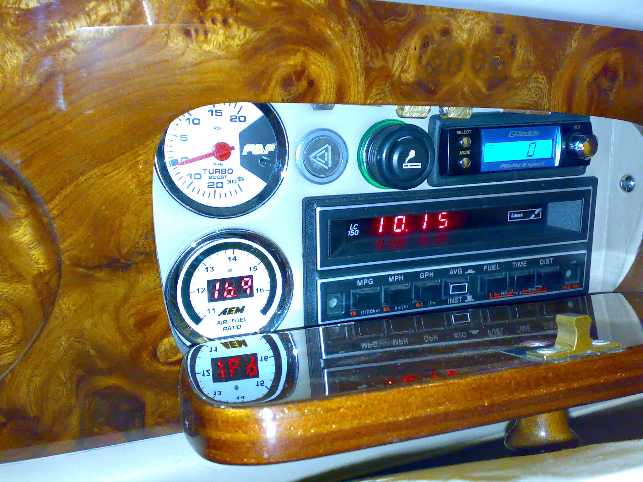

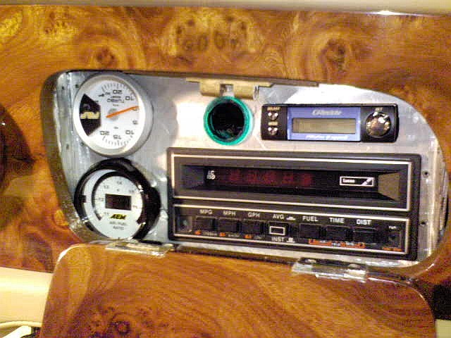

Here's my early dash install phots taking shape with the AEM Wideband and the black bezel it came with from Funky Products.
I didn't like the look of that so decided to modify it, and the boost gauge, to Smiths bezels to match my other instruments. Unpicking the bezel without mullering a £200 gauge was an experience not to be repeated ! But worth it IMO. And a great piece of kit.
If you need a hand fitting, give me a call. It really is a piece o piss, just follow the instructions to wire it up and make sure you weld your bung (ooh ahh) into the downpipe at the right angle to drain off and prevent condensate build up affecting the sensor (I think the sensor angle needs to be 10 degrees off the horizontal pointing downwards). I fitted mine just before the bend in the downpipe, about 10 inches from the clamp.

Does your car idle at 16.9 AFR then, Richard ?
Boost gage reads zero therfore the engine is nt running *tongue*
Smarty pants!
