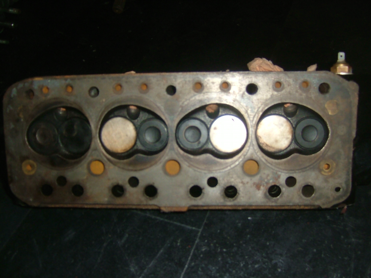

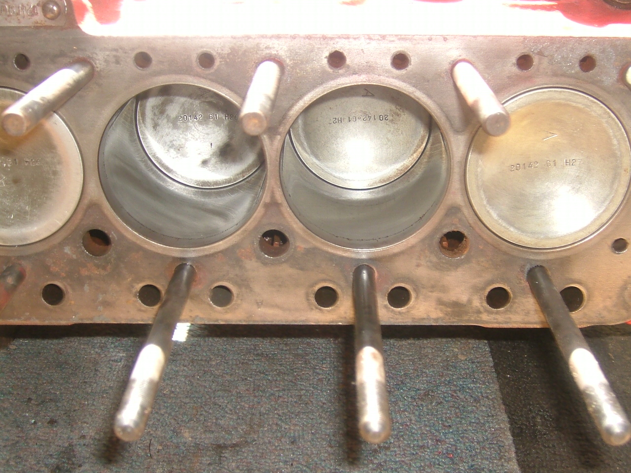

ive been saving the pennys and brought my first turbo compleat setup. well so it was sold to me as. iv broken it down to have a look at condition and done some resurch and it seems these pistons are hepolit 20142 ive been looking at diffrent sites some say thay are standerd metro and i also read that thay are turbo pistons if anyone knows what thay are ill be very greatfull

I cant make out the 4th character of your engine number that well but going off a code list I have saved,12H-D26 was the leaded metro turbo & 12H-FO1 was for both n/a mg metro and turbo unleaded lumps.
Im not clued up enough to remember piston codes of the top of my head but im sure someone will know.

mk1 morris
4 Posts
Member #: 8839
hmm done a bit more digging cant find much out about these pistons. but the block comes back as a standed metro not turbo so unless its been modifid ie these pistons are aftermarket turbo pistons ive been sold a compleate turbo setup with a bog standerd metro engine GREAT
so im gessing this head is bog standerd and not turbo aswell its a 12g940

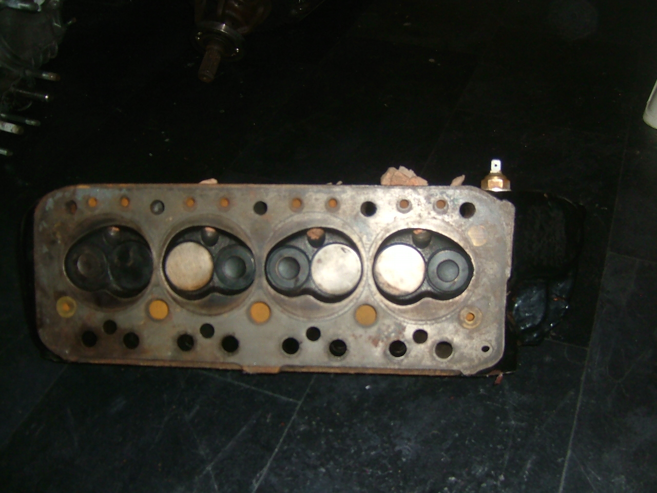

Mr Joshua
2498 Posts
Member #: 1954
Luton Bedfordshire
Not so judging from the picture it looks like you have got the same size valves as an MG metro head. Looks identical to severval I have.

Mr Joshua
2498 Posts
Member #: 1954
Luton Bedfordshire
If you can take out one of each the numbers on the stems should be TAM 1059 and TAM 1061 if they are then the above stands.

mk1 morris
4 Posts
Member #: 8839
thanks guys yes thay are the valve numbers so it looks like ive got a mg metro head with a metro block and all the turbo gear to run a turbo engine hummm still no closer to finding out what these pistons are though
