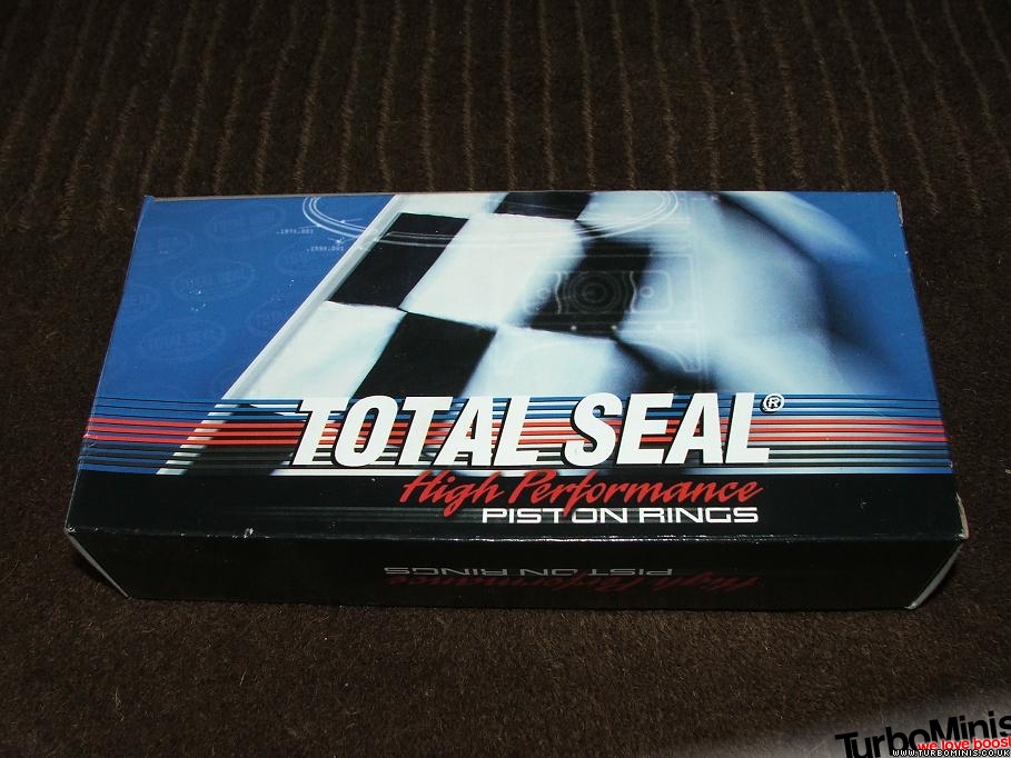

For refference, for anyone looking for standard turbo piston rings and the options.

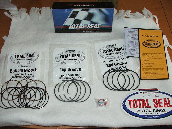

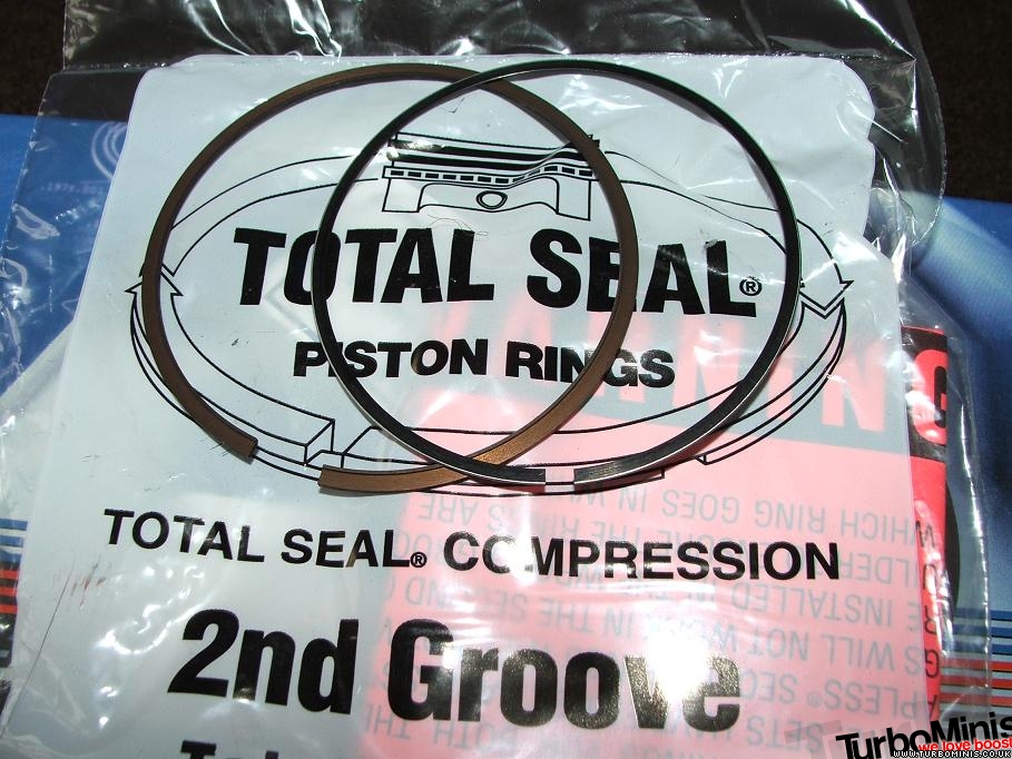

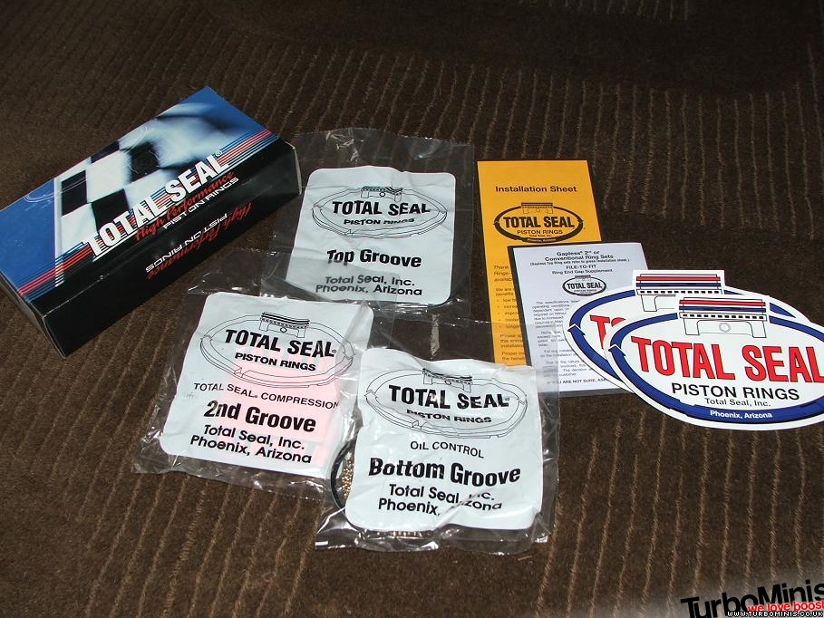

Here is a new set of Total Seal piston rings for the Metro Turbo Piston. These also fit the Cooper S 19320 Hepolite piston and likely others.

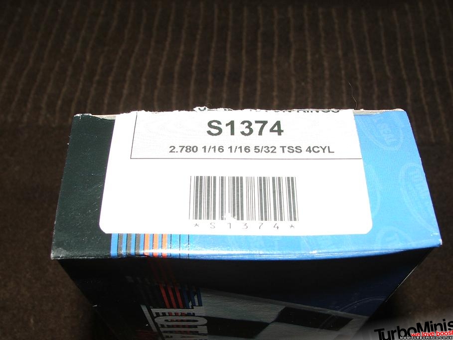

The rings measure 1/16", 1/16", 5/32". That is roughly 1.5mm, 1.5mm, 4mm.

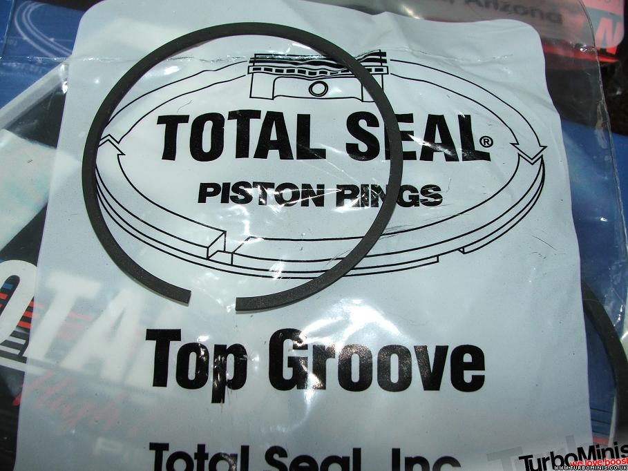

The top ring is a conventional type ring.
The middle ring is a 'gapless' ring. Its construction is in two parts. There is the main part of the ring which is similar to the conventional ring with a gap, but it has a recess on its bottom face in which an additional 'rail' sits. This additional rail is similar to the rails used on three part oil scraper rings. Its gap is offset to the main part of the ring by 180 degrees, thus almost all but removing the gap in the second ring to blowby.

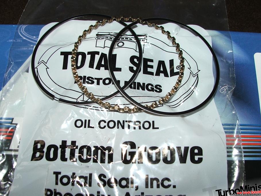

The bottom ring or oil scraper ring is a conventional three part oil scraper ring.
These rings are available in the UK from http://www.performanceunlimited.co.uk at a cost of roughly £90 (pricey for most). They are not off the shelf, but order in from the US, with an aproximate 1 to 2 week delivery.

Can have one if you want one Carl, I have loads. Order before the last one, there was two stickers in the packet and then two inside the box WITH a segment of sugar rock. I was dissapointed this last order as the segment of rock wasn't there :(
You can see the segment of sugar rock in this pic. Those were the rings I had to buy for the 1400, as no one else made them for the 74mm Omegas
