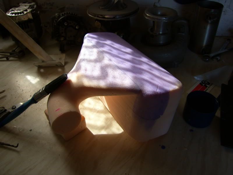

I could not wait any longer to post this, as some of you know my old plenum was leaking lots, so with some common household materials and some not so common, I made this -
A foam mould from roofing insulation!, the blue stuff is PVA release agent.
Bag of rubbish no?
Fluffy?
Whats this?
Yay! Carbon!
I used, a shelf, some foam roof insulation and some glue to make the mould. Covered in PVA for a release agent, although the compound shape means the mould will have to be forcibly dismantled ;D
The less common materials were 650gsm 2x2 carbon twill, epoxy resin, and peel ply, layed up in various different pieces so that it would lay as flat as possible around the crazy curves.

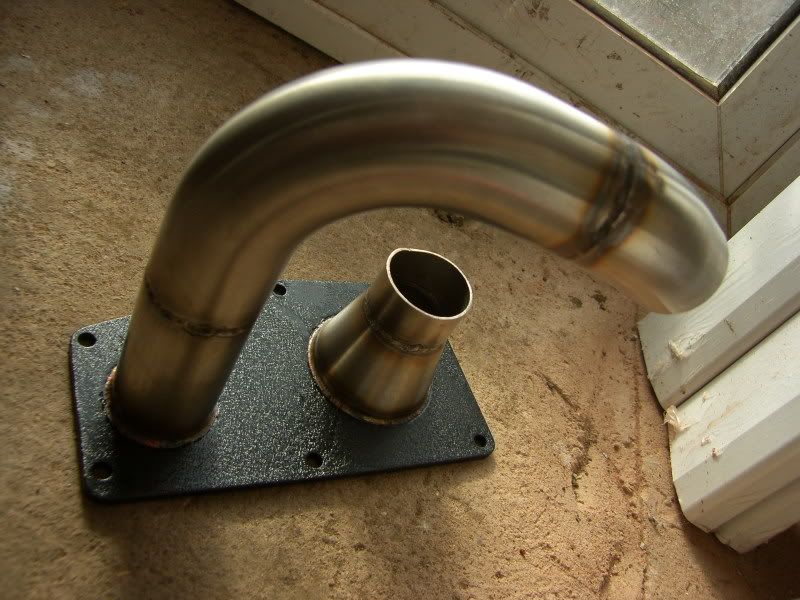

The wastegate had to be detachable for servicing etc, so a stainless V-band clamp was employed to seal and retain, this was pared back as much as possible due to it being heavily over engineered for exhaust use. This was machined to fit both the wastegate and a stainless reducer down to 2".
Some of my best welding so far -
After a bit of fiddling around it was discovered that cleaning the stainless with acetone before welding helps with a clean weld pool, so some of the girlfriends nail polish remover was used (just don't tell her!) ;D
After working out where everything should go and welding each section, the final piece is possibly a step too far :-[ -

very nice! do you do the welding yourself? if so which tig welder do you have? im thinking of buying one but was going to go for the cheapest one in machinemart
he's got a cheapish tig,
if you get one go for one with an HF start rather than a scratch start.
theres a pic of it on the first page of this thread, also theres a load more stuff for people that haven't seen the build before.
http://www.turbominis.co.uk/forums/index.php?p=vt&tid=121495
