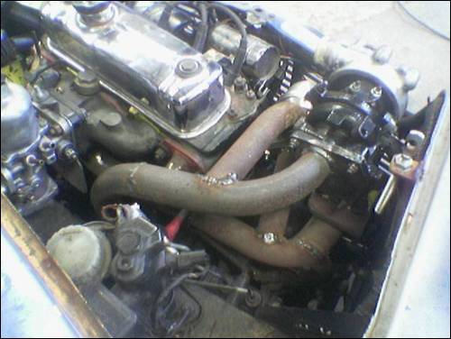

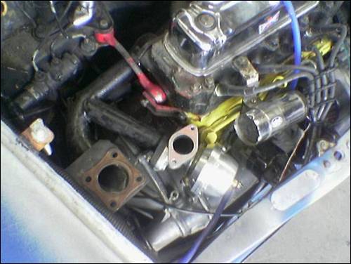

THIS IS MY SIDEMOUNT SETUP FROM NEW ZEALAND :)
IT WORKED WELL ON MY 1100CC CLUBMAN ENGINE THAT HAD 4-8PSI PUSHED INTO IT. LOADS OF FUN..I PLAN TO PUT THE 1100 BACK IN ONCE THE CAR IS FINISHED FROM ITS MIGLIA ROAD LEGAL BUILD UNTIL THE M.E.D GROUP A ENGINE IS ON ITS WAY....:)
FEW PEOPLE AFTER PICS AND INFO ON HOW TO DO IT SO ILL POST MINE UP. IM SURE SOME OF YOU MAY HAVE SEEN THESE BEFORE.
MANIFOLD - 2MM WALL STEAM PIPE 2" DIAMETER TO TURBO.
3MM WALL STEAP PIPE DUMPIPE 2.5" DIAMETER
38MM EXTERNAL WASTEGATE PLUMBED INTO MANI
TURBO - TOYOTA CT9 (FITTED TO A RANGE OF CARS)
FUELING - BOSCH 090 FUEL PUMP
AEROMOTIVE RISING RATE FUEL REG
8MM FUEL LINES WITH RETURN
HIF44 NA METRO SU MODIFIED TO SUIT BOOST
PRESSURE. BDD NEEDLE AND TURBO JET
NEW ZEALAND MIGLIA SPEC ROAD LEGAL TURBO MINI BUILD THREAD >>>

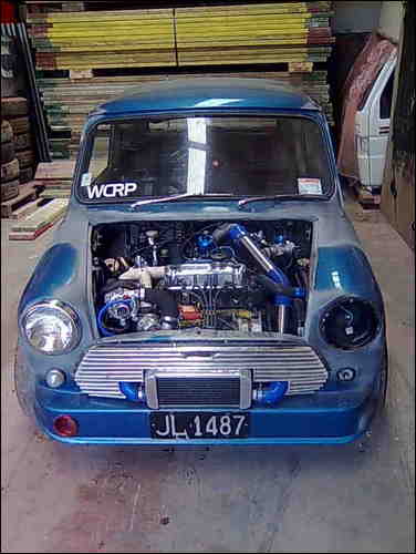

fork me, 2 1/2 inch down pipe, i withdraw my previous statement about it looking too small
give me a week or 2 and ill be starting mine, 5weeks at tops ( ie if i miss avon aby a mile off :()
edit, what cluch is on that also a verto or pre verto?

pre verto paddle with grey plate.. non a+ block. sounds awesome when on boost when the external wastegate opens. i can have it plumbed in or out. ive noticed power increase with it plumbed in though..
