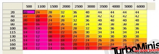

I am currently setting up my recently installed mj and have gotten hold of some of Turbo Tels maps off the site, I have the 18 20 22 24 and 26 degree maps that he did.
I am running 11psi (178kpa), with mg na cam on 8.4 cr, 1310 motor with T3, BIG VALVE head, ported with matched ex manifold.
Fueling is stock turbo inlet manifold with avonbar hi boost spring and needle (10-12psi), fabed jet holder, and blanked butterfly.
and am running a cosworth 2wd intercooler. I am running cooler plugs NGK B8 ES with edis / coil pack.
Could anyone recommend which would be a good map to use to start with, I was thinking the 24 degree ?

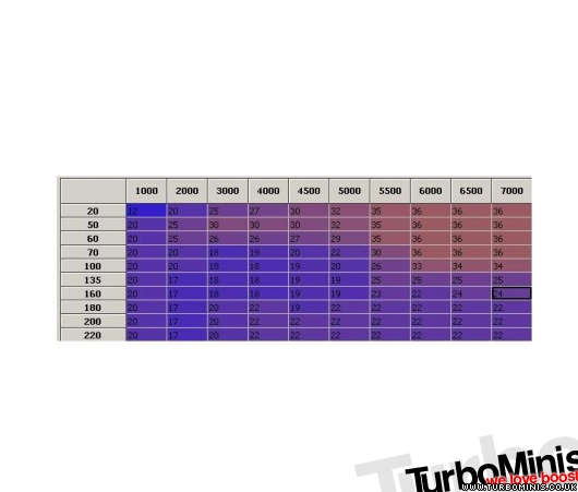

Have you got any more info on the maps so people will be able to see the timing of them might be able to help a bit.
This is my old map:
1293
8.4:1 CR
T3
36/31 valves ported head
BENROSS ported manifold and elbow
Cossie IC
Phase 2 cam
BDD needle
running about 16psi
Brocky
809 Posts
Member #: 224
Katy TEXAS
Good point Tom,
Here is the 24 degree map,
Thanks Matty, spec sounds similar except I am curremty running a little less boost, I have Benross head manifold and elbow to :)
