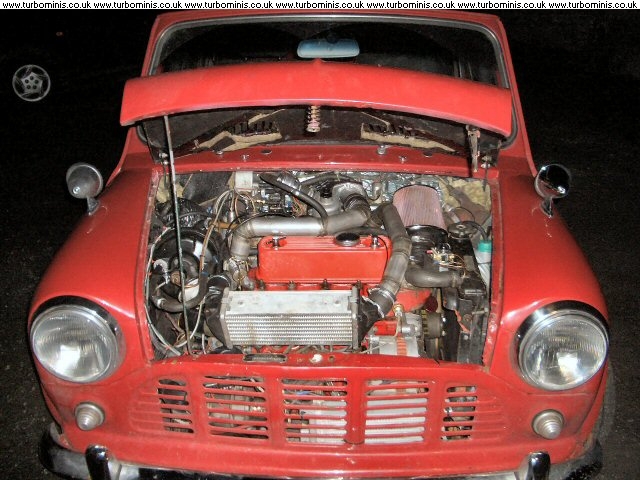

I have a mini van with a fixed grill oilcooler and servo and would like to fit an intercooler any one got any ingenius ideas where to fit one? under the bonnet there is hardly any room for what is there never mind more.

Do a search for 'cosworth' and follow turbo tim's lead...

I had an rs turbo intercooler and fitted it on an angle over the flywheel housing so it gets some air flow. I didn't than have to cut any body work.

i have a front mounted radiator but with the fixed grill and oilcooler I cant get it to fit any where but I bought an intercooler today from an astra diesl that fits as per the supplied link and should have it fitted this week will let you know.

Got the job done thanks for the help.

ooh looking good mate, whats it run like?

Its running briliantly I am chufed to bits just hope it lasts!!!!!
