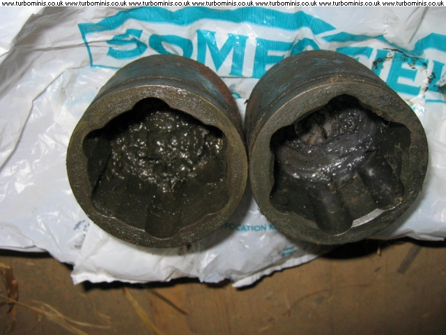

I've just been out in the garage measuring pots.. There are indeed two different types. The difference I've noticed, is the size of the ring holding the balls. This is of a bigger diameter on the new ones resulting in that it does not enter old pots. I've taken some pictures but forgot my camera.... DOH!
Update shortly.
Vegard - post the different dimensions aswell!
I haven't taken any measurements yet, but here are the differences:
One could clearly see the difference in size and shape on these two.
The difference on these, are that there is a slight 45 degree angle on the area between the balls on the "smaller" one.
I tried to see if there was a correlation between the wide and narrow gaiter recesses, but did not find any solution on this.
I do think that the balls are of the same diameter.
What we now need to know is when this change was made, or if it's just a Mini/Metro difference.

The joints originaly fitted to my SPi looked like the ones on the left
