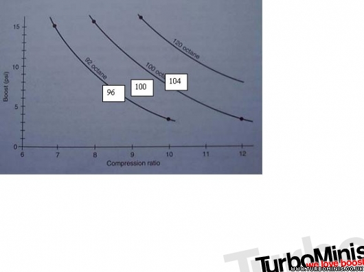

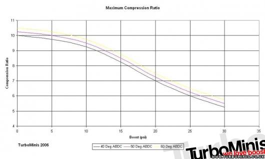

As a rough guide....
I used the first chart from some one who posted it up here a while ago and is based on empirical values.
The chart shows the maximum compression ratio for a given boost. The three curves relate to the inlet closing point of the chosen cam. For example an SW5 has an inlet closing at 48 Deg ABDC and the MG Metro, 56 Deg ABDC so a bit of interpolation is required.
Less than 20 degree inlet closing angle has little effect on the dynamic compression ratio.
The chart assumes an efficient intercooler.
And 95 RON Unleaded.
Obviously if you want to run a higher octane fuel, you can run more boost, you can use the table below (UK values in the white boxes) as a rough guide and apply the relative offset to the curve on the table above.
Hope this helps.

cheers brocky, that is perfect :)
