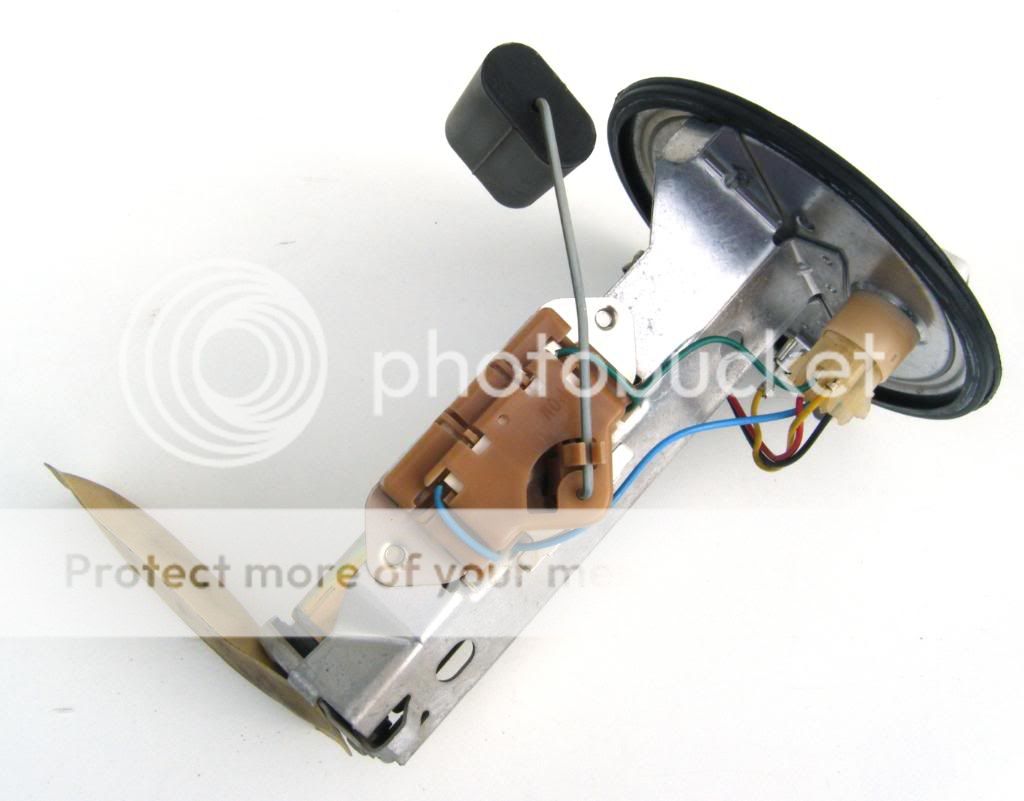

haimesyboi
392 Posts
Member #: 5702
Cornwall
On 7th Oct, 2010 miniminor63 said:
ford puma fits directly
This one??
miniminor63
1849 Posts
Member #: 672
The oversills police
Oslo, Norway
Probably that one yes. But just the pump, not the complete assembly.
