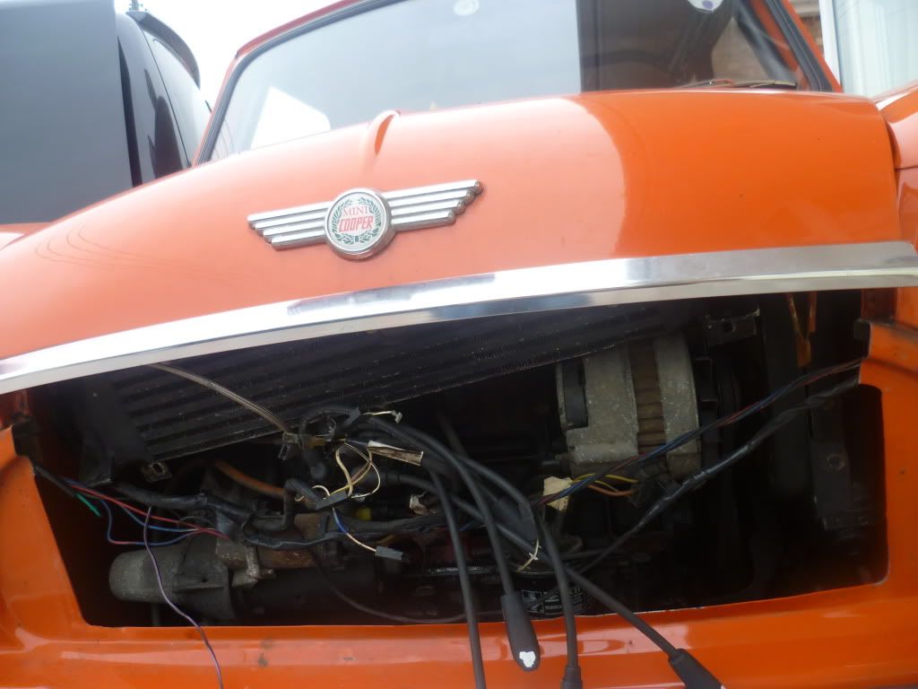

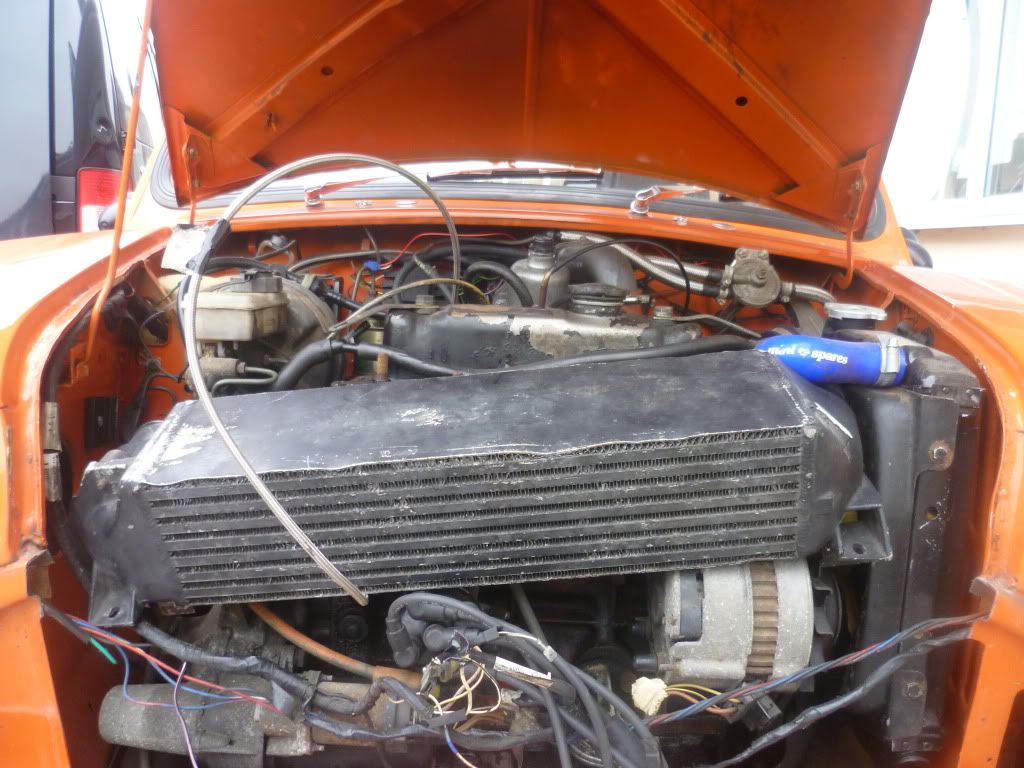

Right! This is what ive come up with, im vainly hoping its a bit original cos ive not seen it before???
Accsess with the slam panel removed is FAB :)
I formally submit my plans for your approval

loads of space lol, good luck getting it all plumbed in. no megajolt? also one of those light weight alternators will give you more space. :)

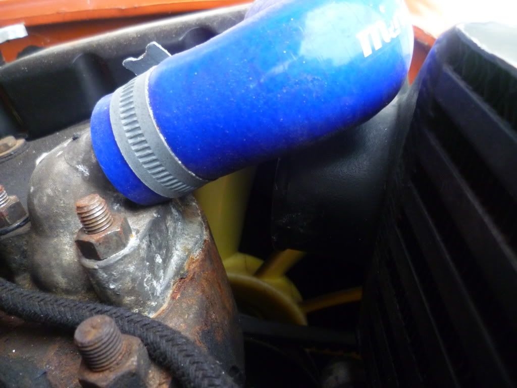

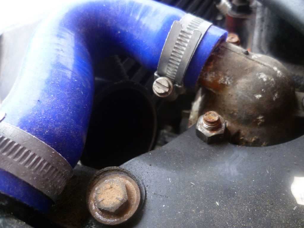

My only concern is pic 3 and getting a pipe through that gap!!! May have to fab a peice to go in there.

That's a 4wd IC which is a lot bigger than the 2wd one. The 2wd one has a 10cm deep and 10cm high core.

Just slung a tape on it and its 120x110x640.. and tbh it gunna go in fine!!!! I figure turning the thermostat housing round a bit, brazing an elbow on the rad an itll go in a peice of piss.
Taking the slam out makes a huge difference.
Ill fix the grill to the bonnet and use pins at the bottom of that, idealy id figure a new hinge set up to get the bonnet right back.
