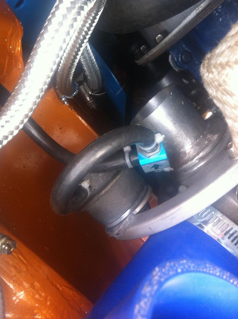

I managed to get, with the turbo, the Saab inlet pipe which is a casting in alloy and has the necessary V band bits and pieces to attach to the compressor inlet.
I cut off just the last 2/3" and the same at the other end and then re-attached them to make a small stub suitable for my application. They could have been welded, but I just used two small pins and good ,ol JB Weld
Mines just got 70mm-50mm silicone bend with a hose clamp on it. It's a bit of a bodge because there's not much to grip onto, but it hasn't fallen off yet!

I welded a 2" ali pipe into the inlet and went straight off it with a silicone elbow. works a treat.
I welded on a stub with a bead on the end.

I found a v-band clamp that fitted. I think it was a 2 1/2".
Still need to make a mating flange on the inlet pipe.

I got the standard inlet And v band clamp. Think it was the cobra type?
I'm planning on cutting it down a bit then attach a silicone/flexible (uncrushable type) pipe to it then filter.
