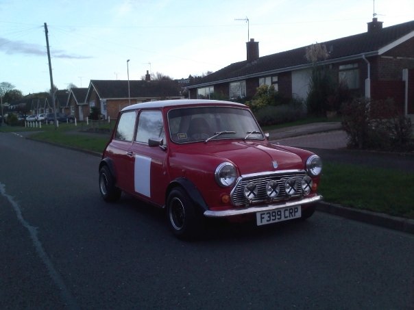

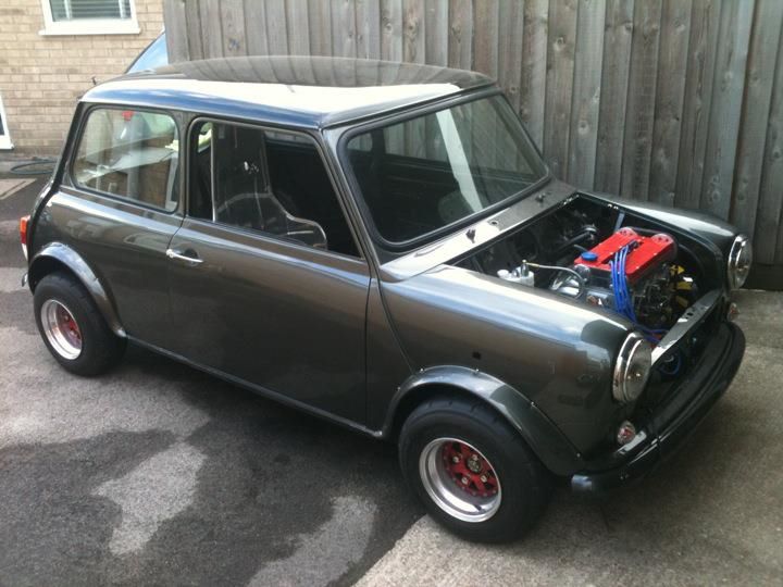

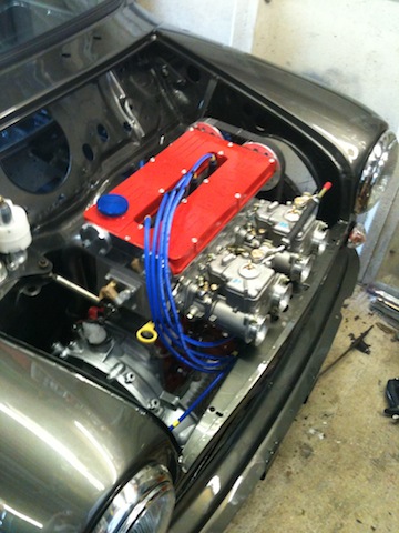

I know its not turbo but this is one of my projects, but im planning on building a 998 turbo engine soon. Hopefully get this running soon, and then try and build a turbo engine with just as much power and torque!
Heres two pictures of when i first brought it and how it stands now. :)

This looks awesome, what specs the motor mate?

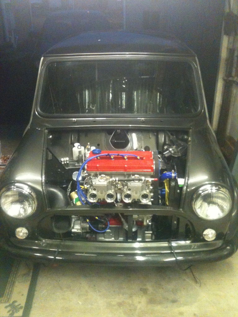

A+ 1380cc.
KAD small valve 16 valve cylinder head with belt assembly,
L1 inlet and BD3 exhaust cams
10.5:1 compression ratio
A+ block with four bolt centre main cap, bored and honed
73.5mm Omega cast pistons
Vandervell Competition engine bearings
A+ crankshaft 81.28 stroke re-ground
A+ conrods, lightened balanced and shot peened with ARP bolts
Twin Weber 40 DCOE carburettors
Aldon distributor with Ignitor Electronic ignition
MED alloy flywheel and backplate not decided which yet
AP grey diaphragm pressure plate and clutch
4-2-1 exhaust manifold
149bhp @ 7500rpm
109ftlbs @ 6500rpm

Love to see it on track! :) any more pics?

Not got that many decent ones as its not been out the garage really.

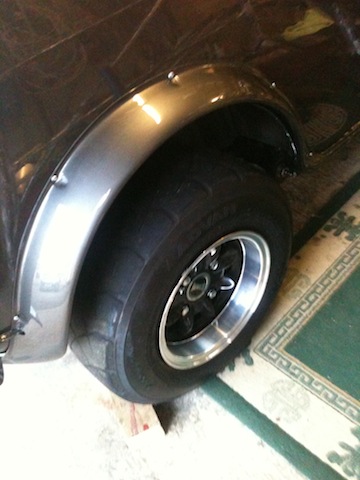

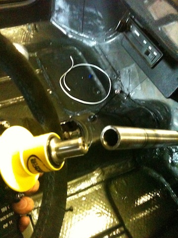

Had the steering column back from machining, brought a weld in removable boss but i think im going to peg it instead of welding it.
Also go a problem with my hi los, im on competition cones and there on the lowest they can go without dropping out but its still mega high and be sitting like that for a good few weeks now. Is it just the cones bedding in it hasnt been on the road yet? i was hoping it would settle down
Matt W
On 14th Mar, 2012 mw3 said:
miniminor63
1849 Posts
Member #: 672
The oversills police
Oslo, Norway
this has been covered many times. Hi los need machining with red or yellospot cones.

Ready for starting up at the weekend!
Unsure on what to do the fuel line in, what would everyone recommend? I want to run it through the car but im just putting the original fuel line on to start off with.

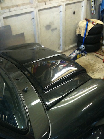

Carbon weezel bonnet
Matt W
Looks good. How did you find ordering with Carbon Weezel? I'm going to be ordering some bits from them at some point.
I found that with parts from them there is a long lead time, i ordered this bonnet and door cards and the finish is brilliant and id wait the time again. However you dont have any trouble getting in contact with them and they let you know how your parts are coming along. Im really impressed with them and since have ordered some custom bits made up. Foot well plates and a drivers footrest.
The bonnet is 100% carbon and when you tap it it sounds like your tapping the original steel bonnet. Great quality.
Them and KAD are the best companies ive dealt with so far.
