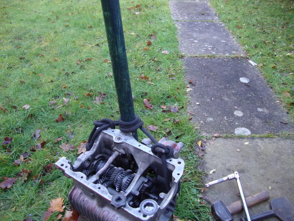

This weekend I had a stuck pinion nut, in a gearbox I dont need, so one new breaker bar and 1.30hrs later, also now my abseiling rope is 1m shorter*oh well*.
So Is this a bodge Or just getting the job done?

its only a bodge if it fails!
just have to choose wisely what you next decide to descend from :)
one day boost will be mine!
On 10th Mar, 2012 Joe C said:
Looks standard practice to me fella, have you bent that pole in the lawn?
Looks a bit on the piss lol, might just be the photo though!

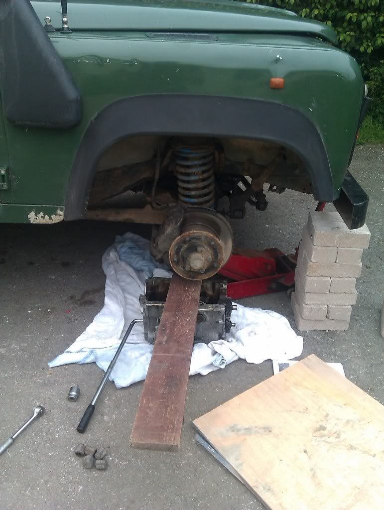

I bolt mine upside down on my bench, Ive seen some put the box under the wheel of a car
I combined rebuilding the defender hubs with dismantling a mini gearbox
Yes its on the piss now O well its not mine.

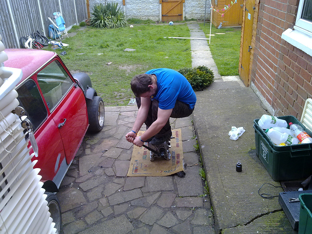

I had it bolted down to the bench, but i pulled the bolts thought the wood*surprised* need to stay out of the gym.
torquing it back up, i have an advantage i think im heavy as fook *happy*

I used my work car to hold mine down, I tried standing on it but ended up lifitng myslef up and twisting my ankle. *hehe!*

Four bolts through the dowel holes into anchor bolts in the garage floor concrete, with some thick penny washers between, 3/4" drive 4 ft breaker bar. Never had a problem.

Try sitting on it, grab the back edge with one hand, and a very long wrench the other hand, and pull up on both hands at the same time. This method doesnt really work undoing the nuts, but is usually fine tightening them. Just dont giver yourself a hernia!

A surgical 2x4 shoved into the gearbox and lever downward. Piece of piss!
I learn't from the master. lol. Sometimes needs somebody stood on the end. My chosen plank is about 4 - 5 feet long. Wifey is usefull from time to time.

Just stick mine under the 4 poster ramp, I have had bastards though. Ive bent breaker bars, jumped up and down on scaffold poles the lot. Patience is the key, they come undone eventually.

Fair enough but you might have fallen off said box and twisted your ankle *wink* That input gear nut doesn't have much on it and easilly slips. The pic made me giggle though *hehe!*
Why struggle applying 150lb or more of force on the bar you are using in that pic. You'll give your self a hernia bent over and crunched up like that, You'll only do that the once, when you only need to apply 50lb with a fairly cheep tool of choice and another way to hold the box, simple made tool that bolts to either the speedo housing or transfer housing fixings for one.
